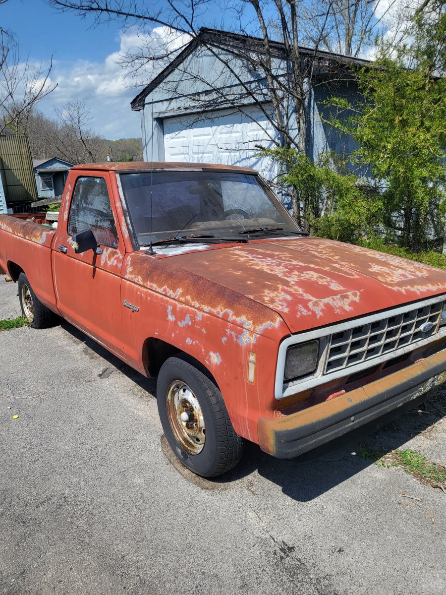

History- 86 ranger, 2.0 carbureted 5 speed. Was my father-in-laws daily before he parked it because he got something new, or he got something new because this was giving him trouble. Im not sure. The truck sat in his driveway since 2006. I asked about it, he gave it to me, Ive been wrestling this thing ever since.

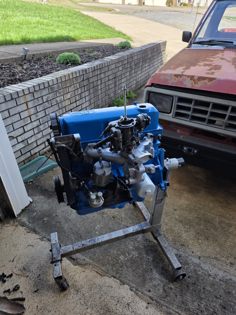

I made it run, drove it for 2 weeks but it got milkshake in the oil. Thought it was a head gasket. So I pulled the engine, re-gasketed it, prettied it up and put it back together. Drove it another week, and noticed oil all over the driveway, out of nowhere. Im okay with a few drops, but this is excessive. I noticed (and forgot) a spot in the side of the block for what appeared to be a PCV. I thought maybe this was the issue, so I plugged it. Oil everywhere. So I figured I would vent it a little until I could get a PCV. Oil everywhere. It also almost caught fire for a brief moment. My problem is I assumed it was running okay when he parked it, but that seems to never be the case, no matter what they tell you.

It was so clean. I had it out for the gaskets. It ended up not being the head gasket, but the intake gasket that had failed. I changed them all, even the front and rear mains.

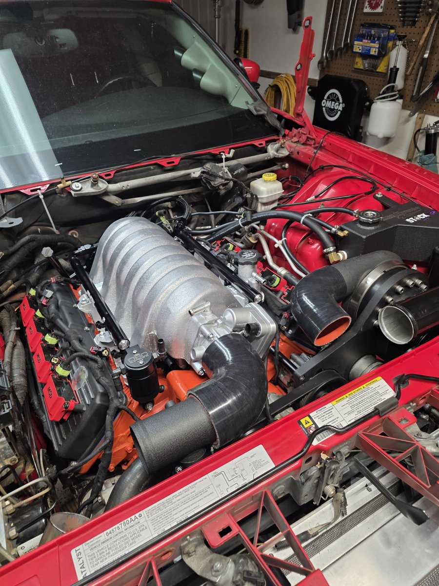

The truck when I started trying to bring it back. Its supposed to be a little run around truck. Back and forth to work and small truck jobs. I have my car I need to be working on and spending money on. Its a 2007 Charger RT, with the road and track package. I recently replaced the engine with a new crate motor, installed a cam, headers and exhaust, 6.1 intake and a torq storm superchanger. Im just a few weeks away from finishing and having it tuned. But I keep having to fix this truck.

Okay, so today I put the PCV in and started the truck with no hose on the oil filler/valve cover cap. Immediately the truck idled better and ran better. There is quite a bit of air coming out of that elbow on the cap, so I put my thumb over it, and realized where the oil is coming from. If you look very closely at the first picture on the first post, the dipstick tube is held in with a ziptie. When I started working on the truck, I noticed the dipstick tube was broken at the tack welds. I used a ziptie to hold it in place. When you hold a finger over the elbow, it pressurizes the crankcase, and oil shoots out of those two tiny holes.
I tried to plug them, but it just shoots out the bottom at the block. I added a catch can I had laying around, but it still seems to be spewing oil, just not as much. I think the engine has to come back out and back apart to see how bad the rings are. The final test is going to be a compression test. Ill borrow a tester from a friend who has one and run the test to see how bad it is.
