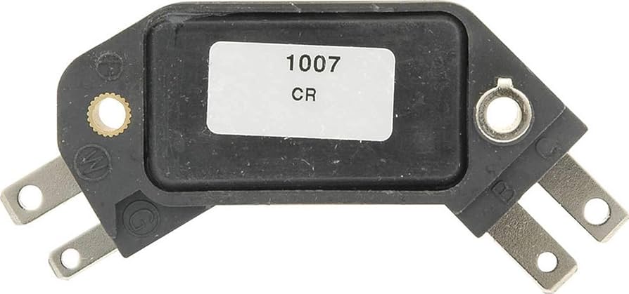

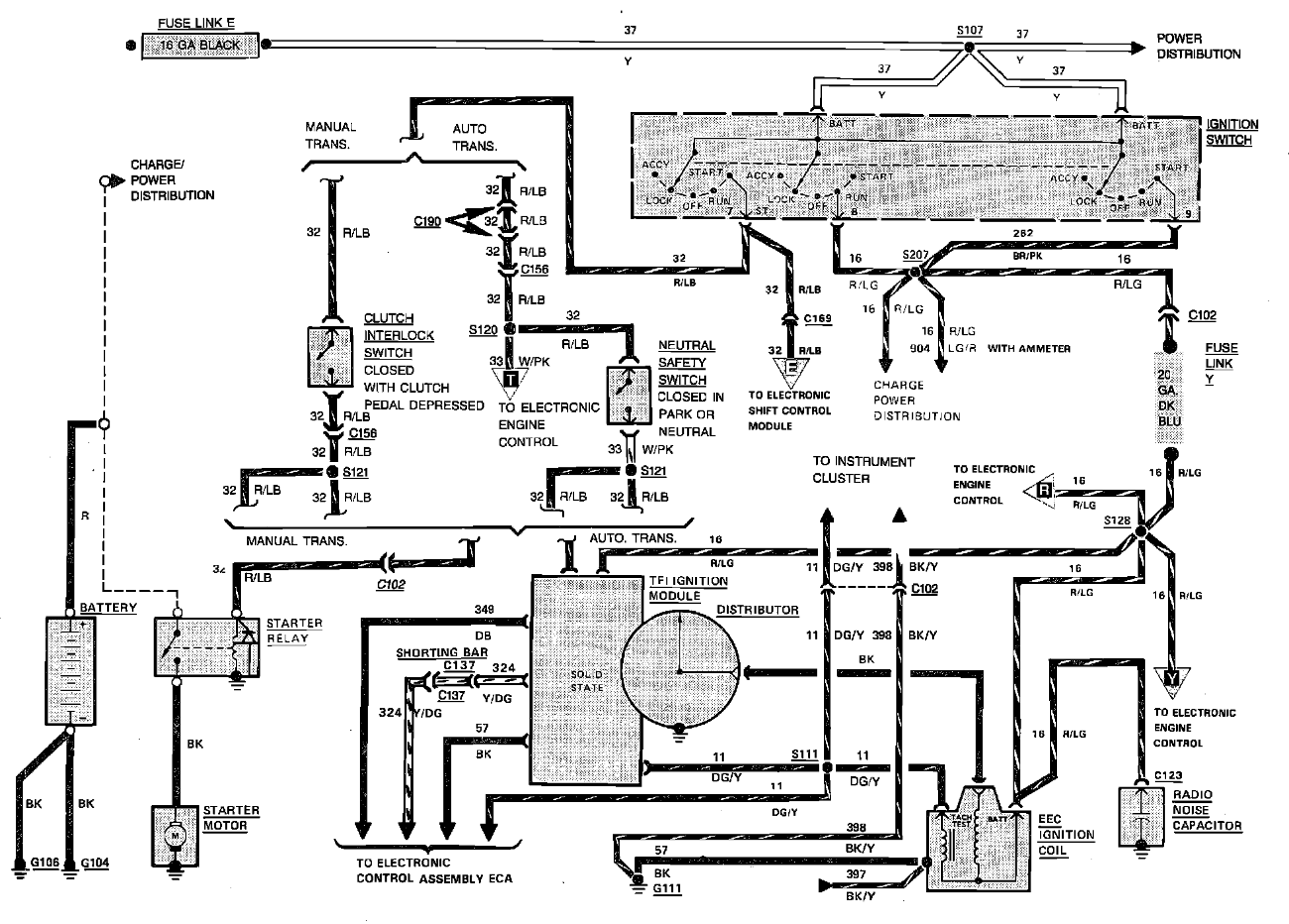

Hello all, recently I did a carburetor and Duraspark II conversion on my 1988 2.3. I saw this was a fairly popular thing to do on the 2.8, and I had had some kind of demon I never could figure out causing misfires in the stock fuel injection setup, so I decided to go ahead and attempt these conversions on my 4 banger. The carburetor conversion went pretty smoothly, but the ignition system conversion hasn't been as painless. So what happens is it will generally start up fine, run well for maybe 30 seconds to a minute, then suddenly just shuts off as if power were disconnected. It will start right up again if I try, and then exhibit the same behavior. I had thought perhaps where I wired the ignition module into power may have been cutting out after a certain length of time, but it behaves exactly the same way when I have it wired directly to the battery as well. Then I was thinking maybe I need to move the power source for the ignition coil away from the original wiring, because I still have the original ECU hooked up but it doesn't connect to much anymore, I thought perhaps it is looking for a signal from the old TFI-IV module that is no longer there and is cutting the power when it doesn't recieve one? But then I started to wonder if maybe I just got a bad ignition module? I kinda wanted to get some more experienced opinions before I go slicing and dicing again or ordering another ignition module. Thoughts, anyone?
