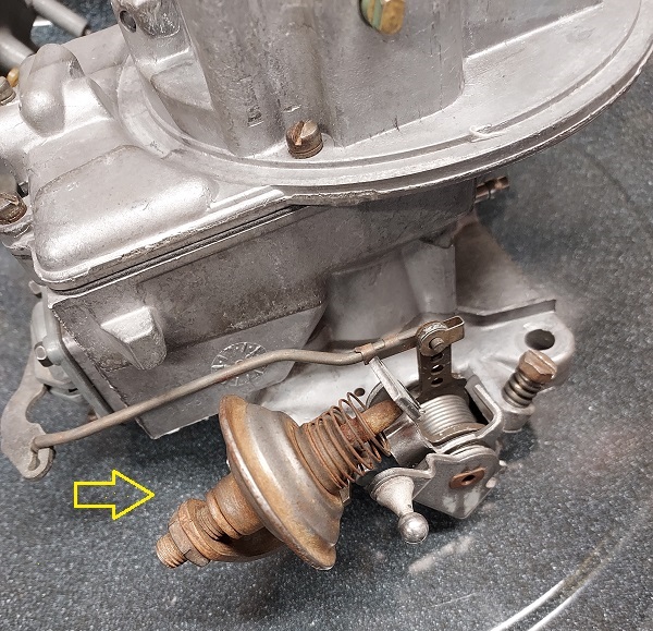

I'm in the process of rebuilding and reinstalling the drivetrain in my '85 RCLB. I sourced a 2150 carb from the same folks that rebuilt the engine. I recently tore it apart, cleaned it and put it back together (with a rebuild kit). I have a few questions:
First, what's screwed to the left front corner of the carb (yellow arrow)? This appears to be shot, can I get another one?
