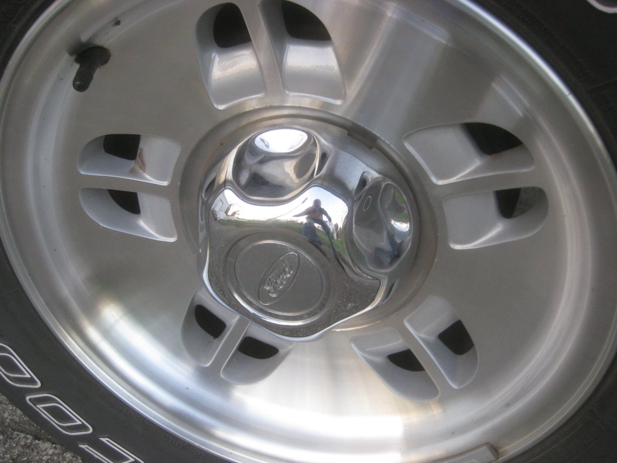

On the '97, in front you have the caps going around the hubs, and in back they look the same but are covering it all.
I notice there are cutouts in the rears of them, looks like you are supposed to insert something there to pry them off?

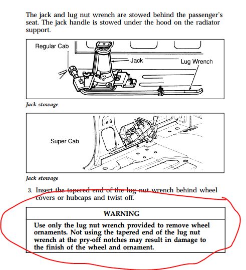

Can't find anything in manual about it. Not sure they even talk about wheels/tires except as it relates to speedo gears, what size fits under the truck, etc.

Yup, pointy end of lug wrench goes in the notches to take hub caps off. I have them still on my steelies
My old F-150 had a rubber coated end on the lug wrench for popping the centercaps off.
You can use whatever to pop the caps off but if it isn't the rubber coated tool being steel vs aluminum or plastic you may damage your wheels or centercaps.

OK so on the hubcaps I get it. Thanks for the diagram and cautions.
Sometimes I use a little softwood stick for something like that if it's strong enough
Or put blue tape around the tip of the jack handle if it doesn't have the special rubber tip which is kind of a cool thing.
