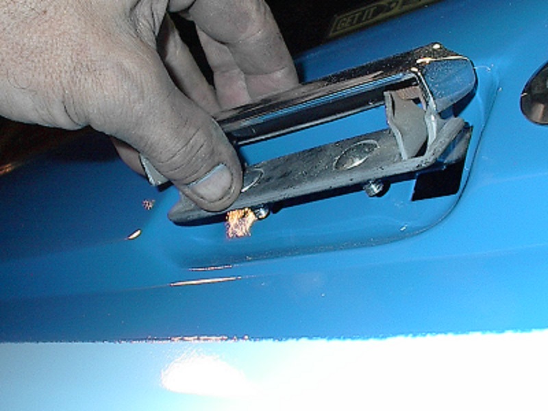

1993 Ranger. Removed door handles to paint door. Drilled out rivets. What are you all using to replace the rivets when reinstalling the handles?
I used stove bolts:
It took a little work with a jeweler's file, to square the handle hole, but it worked well and makes future R&R easy.
Sounds like a plan, thanks
