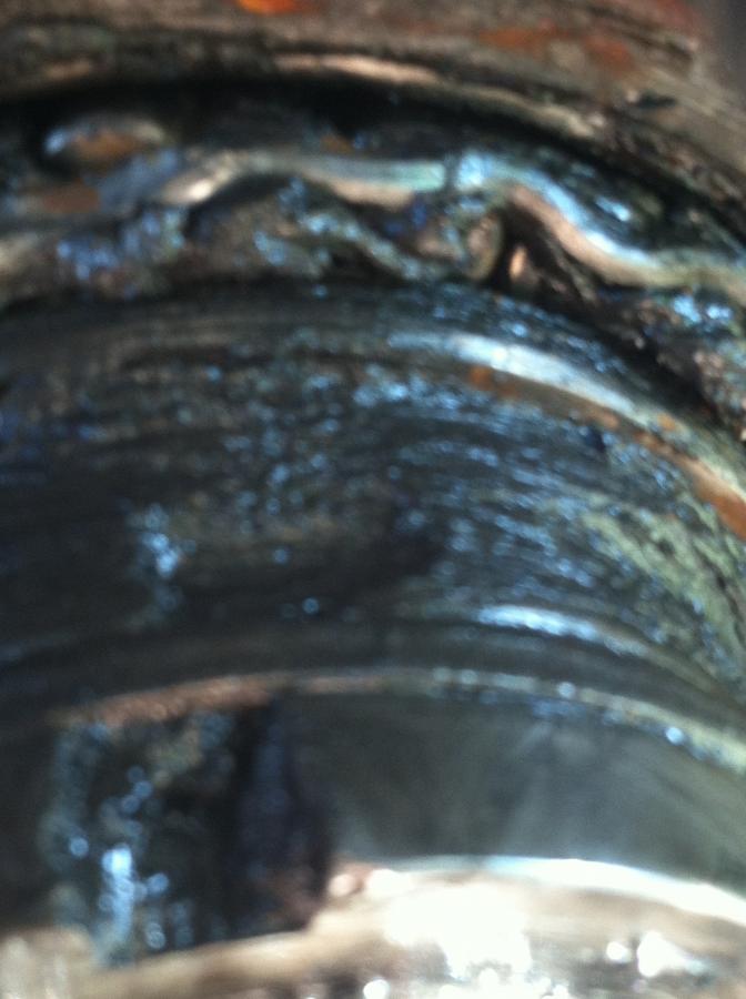

Got new spindles today theres a lot of pictures haha

I'm going to reuse the needle bearings inside the axle since they seem to be in fair shape. I played with them a little and they spin easily and cleanly.
I don't know how to upload more than 3 pictures at once, and with the option above, some do not upload...
well, I'm going to repack the needle bearings in the spindle since I can't get them out. I tried first on one of my old spindles and me, my dad, and his friend all tried and we gave up. We had him inspect the needles on the newer spindle and they're in good shape. Need to also clean and repack the wheel bearings, then hopefully I can get the truck back together this weekend... then do something about my exhaust so I can pass emissions and get it titled... and drive it more than 10 ft before it messes up again. and hopefully ill also have 4wd again :)

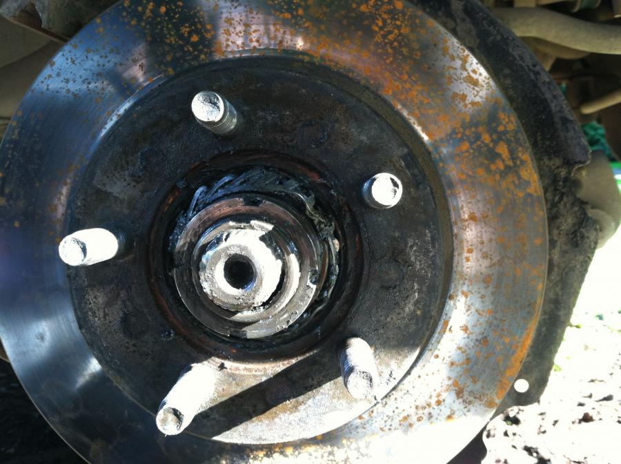

If anyone happens to care, I finally got the truck "finished" last month. However, some dumbass tried to put a D28 hub on the D35... With out the c-clip, the hub fits perfectly lol. So when I put the thrust washer and c clip in, I couldn't get my hub on, so I took off the dial, and punched out the guts with a deep socket and mallet. Now I have the housing on to protect the bearings and such. I am getting new Warn hubs later this week. Also, my axle does not pop on 4wd, and I found it to be the u joint was hitting on the steering knuckle, but the thrust washers and C clip takes care of that.
