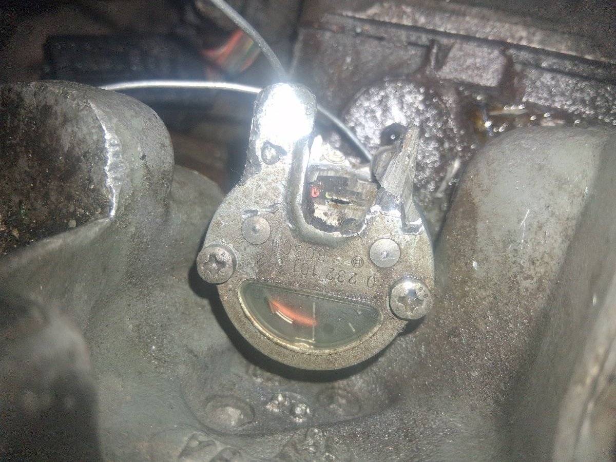

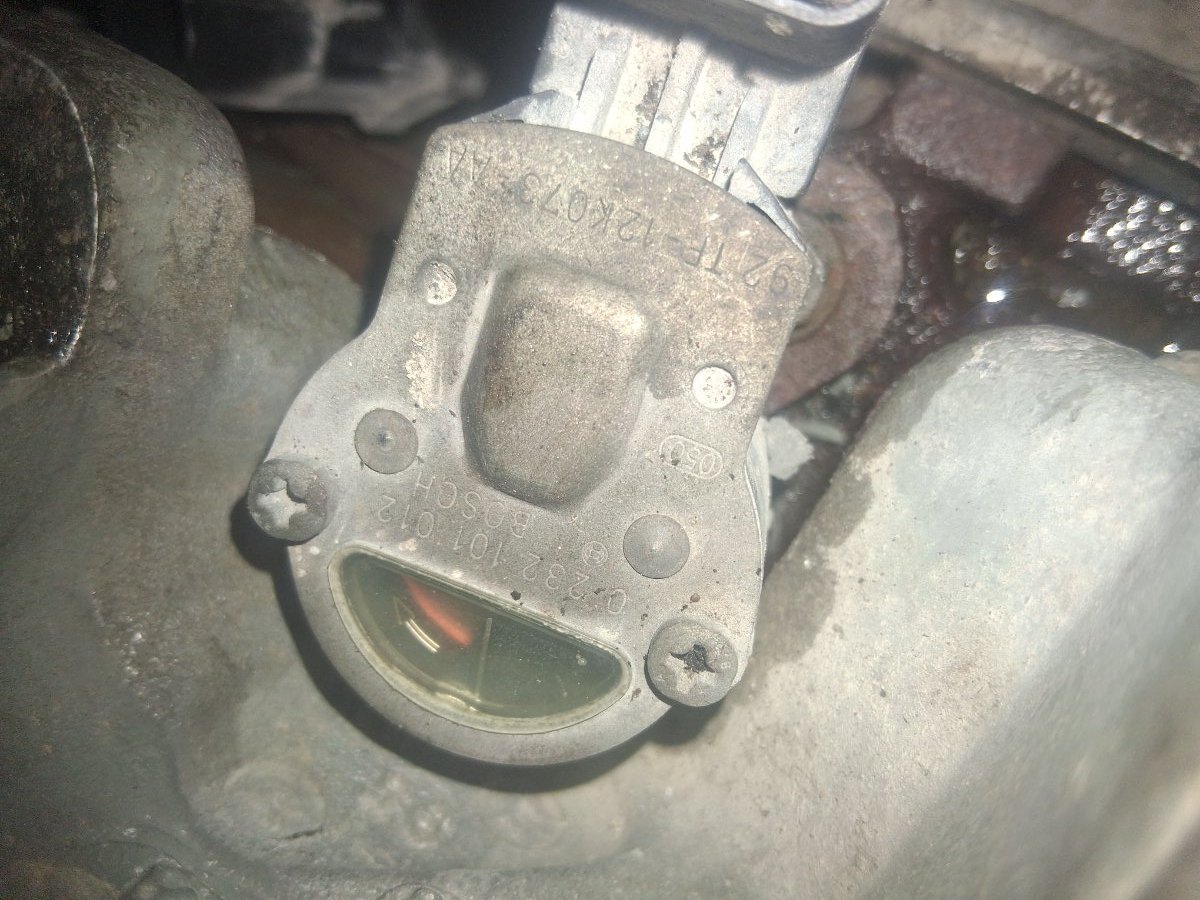

Hi yall im new here and glad to be! I've been reading up on the 95's synchronizer replacement. Mine has the see through glass. I've read the threads on replacing it but im unsure about which end of the vane goes on the far left mark, the short one, when installing the synchronizer. Now when I stab it in it should be set where to makeup for the helical shape? Pass the small mark or is it supposed to rotate back to the bigger mark thats offset? My truck is apart now and im worried to death i wont get this set right. I had it at TDC when I pulled old one out and now I have it turned 26 ATDC (34 mm). I took pictures of the old sensor and the one in the truck had an orange highlight on the vane that lined up from the big half mark to the smaller mark when I pulled it out and was lined up so. So I set mine the exact same way and after it seats whete should the vane be pointing? The leading end on the small mark right? Help loo
