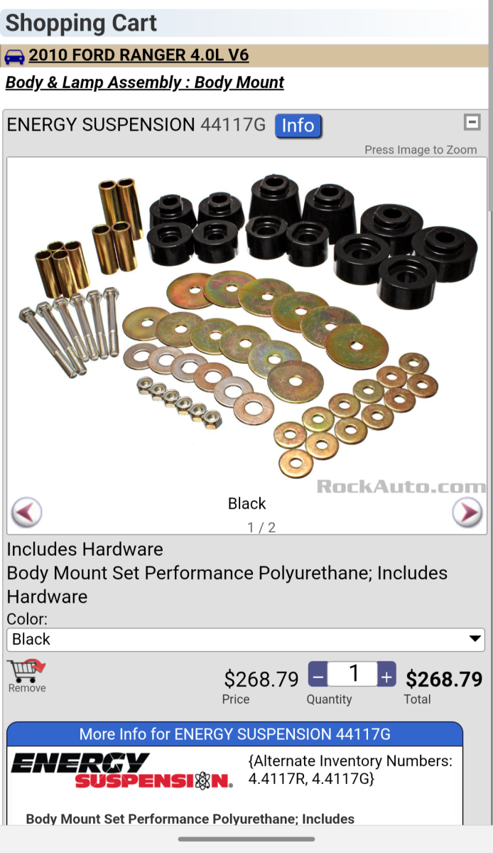

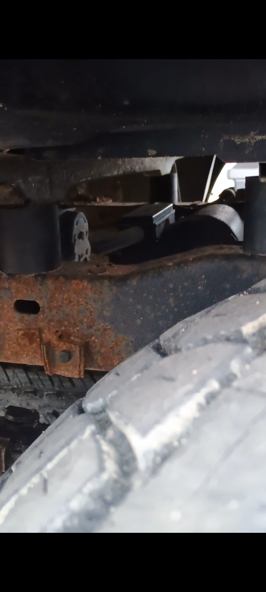

Hello, so I'm considering removing the 3" body lift on my 2010 Ford ranger sport but have never done it. After looking, there's some that say LMC trucking has the proper mounting hardware. How true is this? And is it somewhat feasible for one person to do it?
Definitely can be done with one person. Just watch to make sure you don't pinch any wires or hoses. With a 3" body lift, there may be an extension in your intermediate steering shaft. Be sure to remove that before lowering the body.
LMC should have the correct hardware.
