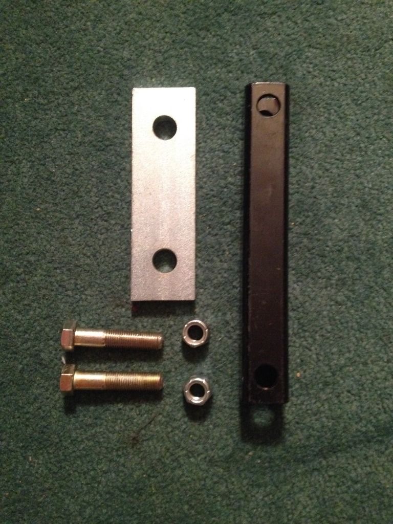

Question 1: On the instructions it says look at all your parts you received and compare them to the parts list we provided.
I have all the parts listed but i also have these parts as well and it doesn't say what these are. What are these parts for?

There aren't many trucks that have the rear lowered using hangers like that. Most guys just get an axle flip kit because it's cheaper and typically easier to install. You're not in totally uncharted territory, but there probably aren't a lot of guys around that can answer your questions about that specific kit, or lowering the rear via that method.
Honestly, it doesn't sound like you're thrilled with the kit you have. I'd see about sending it back, and just getting a flip kit. They're $50, and you would have a lot more people to bounce questions off of. Just my opinion.
Always seen this kit to buy online, but never seen anyone use it. Sucks that you went through 3-4x the work when djm's flipkit is 4" drop for the pre 98 trucks. Hope they at least sent you grade-8 bolts
Shims most likely wont be necessary, but your pinion angle will be off from factory(usually you measure your pinion angle before you drop and measure it after to order correct size shims) but most ranger owners dont even do that. Its usually one of those "nice to have" but not critical things unless youre really dropping or lifting a vehicle
