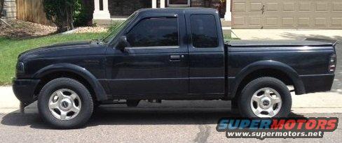

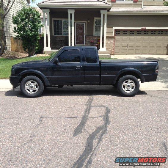

This is what I got now:

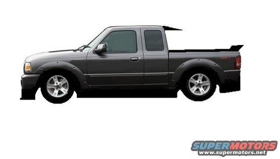

This is what I am thinkin':
This is likely what I will do:

I don't want a heavier 4 door nor do I want the longer wheelbase. I am too tall for a regualr cab. This would also improve cornering and handling. I've considered a 2 door Explorer Sport, but like my lighter two seater and trucks in general.
Seems like a lot of work just to chop a foot or so off the bed.
You'll have to figure out the fuel filler situation too.

It can almost be a bolt on (no cutting frame or box involved):
Regular cab/short box Ranger frame is 14" shorter than Super Cab; box from one of those Mexican Crew cab Rangers is 14" shorter than the short box with all of the material removed from the front.
So, my plan, cue evil scientist cackle, was:
Remove cab/box from my regular cab, move rear cab mount back 14" to Super Cab location. Cab mounts on '98+ are welded so would need to be ground off; but the earlier Rangers had mounts riveted so old mounts could be bolted on after drilling couple strategic holes.
Install Super Cab, install Crew Cab box (my company has plants in Reynosa, Monterrey and Guadalajara, MX; so I have colleagues looking for a '99-09 Crew Cab munched in front/someone removing box to install flat deck). Crew cab box has correct hoses for filler.
My version had T-Bird rear end rather than 4 link as www.truckirs.com makes brackets to make the IRS installation very straight forward.
Add Ranger STX front bumper, replace rear bumper with rollpan and you are almost at your goal.
My plans are temporarily on hold: while waiting for the box, my wife sold the SuperCab I was planning to use to her brother. And told me I can't buy a replacement until the honey-do list is knocked back (If I don't get them done; funds from sale of Ranger will be used to hire someone to get them done. :( )

This is to run around Colorado and handle snow, not wheel and it would end up at 111"s
With the 111" wb, it would be just like driving a regular cab/6' box - you would just have the extra cab space and lost ~1' of of box.
After reading the fine print; I'm not sure if you would want the STX bumper cover on a 4x4; might not take kindly to a Colorado snow drift.
