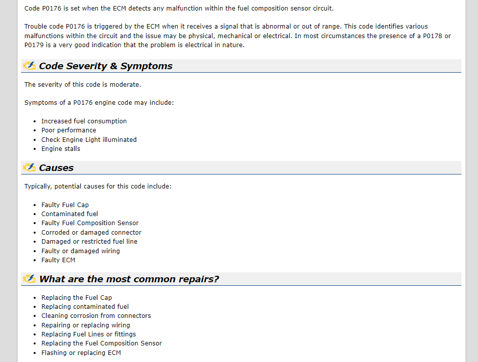

https://www.obd-codes.com/p0176 where it ALSO says a faulty gas cap could be the cause!!!
Have to say that would be a new one for the books, any EVAP code says check gas cap :)
You certainly can air lock a gas tank, just not sure where fuel sensor code would come up when its not even connected
They do have thousands of replicators out there, I doubt millions, at least for Fords, the fuel sensor was only used for 2 years, and I know of only 1 replicator that failed, so long odds but not 0
But hopefully the problem was the gas cap and issue is solved
Well seems like the suggestion was and old one in some books somewhere despite your disbelief. Take a look.
