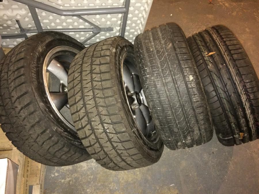

Hey y'all, so the question is i bought some mustang wheels for my 94 ford ranger and I don't know if I should have them machine so they can fit or buy wheel adapter what you guys think ? Btw the wheels are bullies the size are 245/45/17 IMG_0578.jpg
Mustang rims? Don't they just bolt on without adapters?
Same bolt pattern but center holes are different. I favor doing the machining.
If the offset is the same, I would machine the center bore. If the mustang has a more positive offset, (which I believe they do) then I would run spacers.
