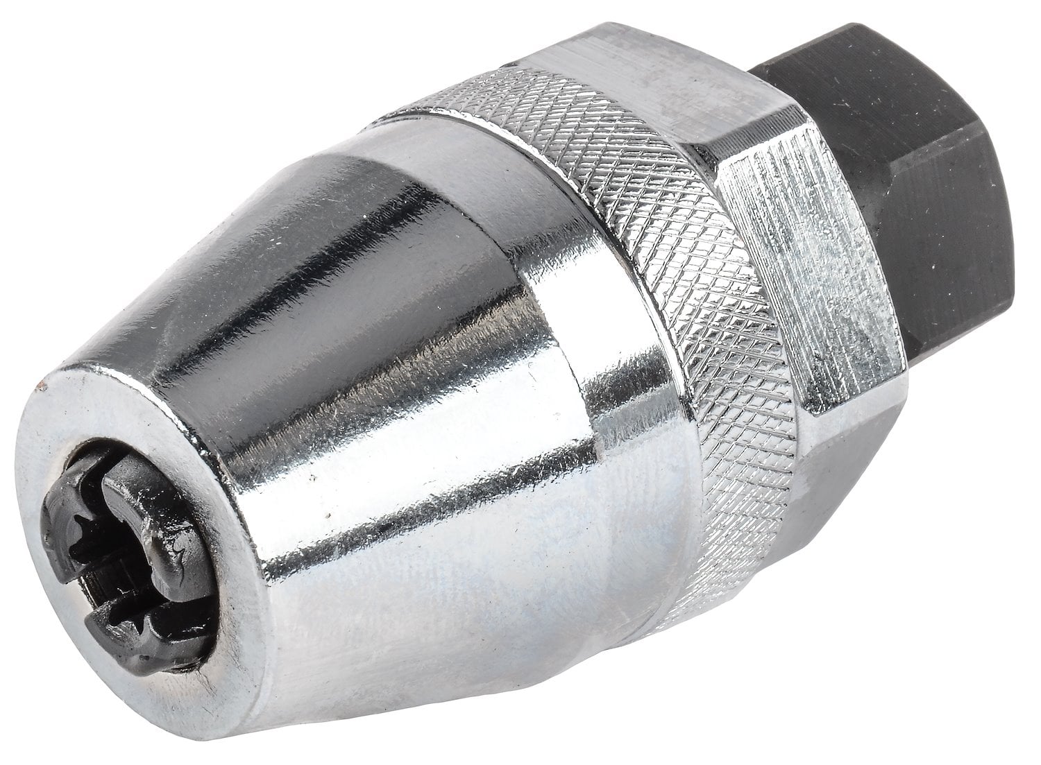

I like this style stud extractor. I have had very good luck with it, and it does not need a lot of the stud sticking up, less than you need to get a good weld for a nut. I specifically like the Titan brand. Not all of the brands have the same teeth on the jaws. The Titan one aligns with the most common stud threads giving a better grip.
