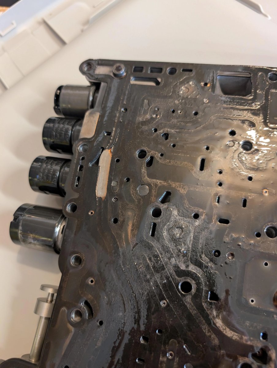

I just started having some minor issues with my trans and discovered the gasket blow problem. Pulled mine out sure enough a little bit has been blown out. Ive been through the TSB information but Im either entering the part #s wrong or they dont seem to exist for those numbers anymore. Ive had them come back as discontinued or something totally different. I have found a gasket set here, but Im not sure its correct. I though it was supposed to be a bonded gasket. I believe I have the 4r55e trans. Thanks.

i looked at that link, looks like you can email them and find out if it works or not. you can also just check rockauto, and compare the part numbers to whatever you're finding, or just buy from there.

I did several days agao and never got a response. Rock auto doesnt have them. I ended up just buying the ones in the link and will have to compare them. 🤷‍♂️
