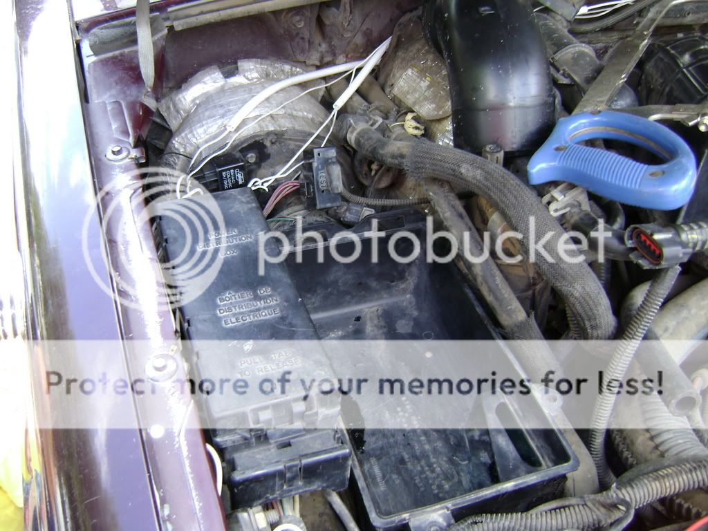

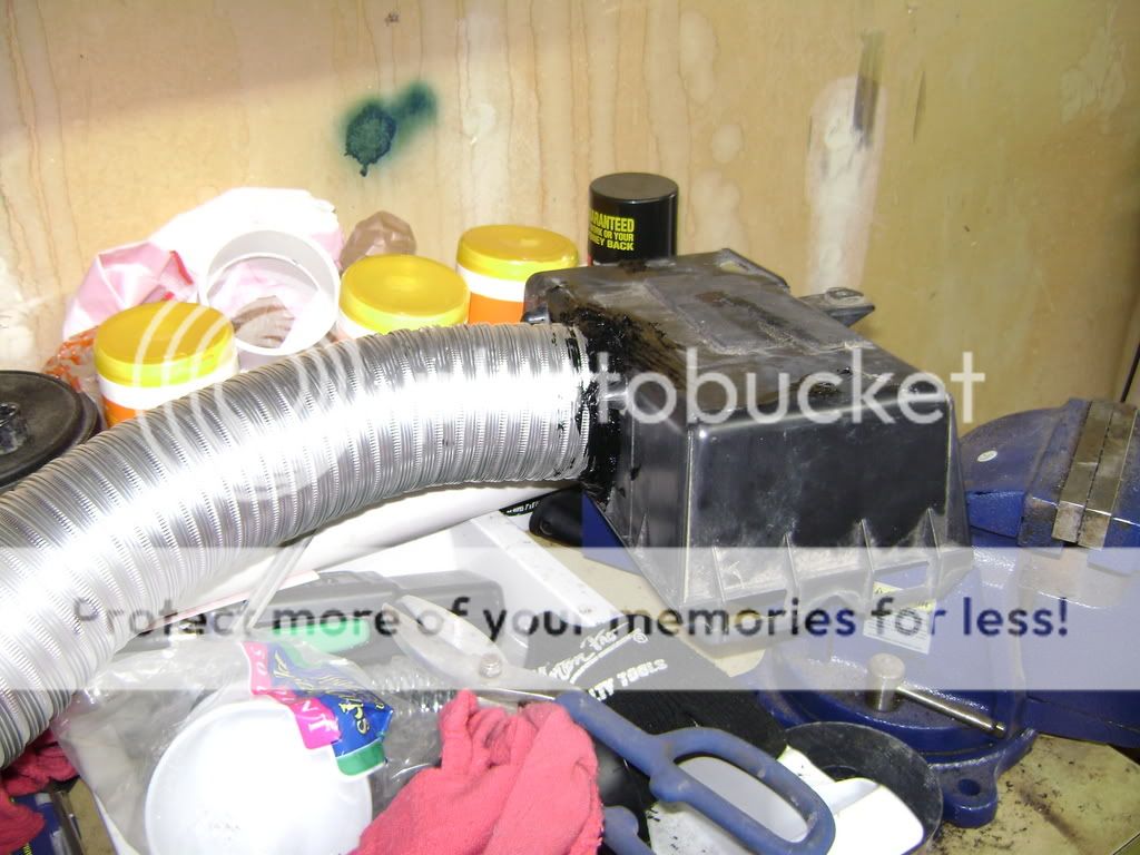

Take 3 ½” hole saw and make cut in junkyard airbox approx. center of the fender side (bottom portion).
Cut a piece of lexan to cover factory intake and use urethane(this stuff gets everywhere so use some good gloves or have lots of thinner/fingernail polish remover on hand. If it gets on your hands you wear it off, but its great stuff) to seal ( you will have to trim some of the stock intake tube away if you leave it in place, I choose to do this because of some of the sensors that are in it).Get ready to cut a big hole in the side of your Explorers fender. I choose to make the hole all the way through the fender, rather than try to route the tube between. Cut your 3 ½” hole in front of the blower motor.
Pull fuse block off clips and loosen some of the clips holding the wires to the fenderwell and move aside(don't disconnect, there is enough room to get everything done.Test fit extra airbox(or your stock box if your using that) and eyeball length of flex tube you will need (s-shape from hole in airbox out through hole in fender. I left around 8 to 10" extra that could be trimmed off later. Use Urethane to "glue" flex tube to the airbox.
Important note here, let the urethane set up good before doing a lot of tweaking, the stuff is strong but if it hasn't had enough time to cure it will come apart.

I used the 2" PCV in the flex tube just to help in getting it into the 3" 90 degree PCV piece(sorry no pics)use the urethane for this (just squeeze the tubing around the 2" PCV and glue it to it and then put the other end, as far as you can, into the 3" 90 and use the urethane again. Push the assembly into the fender as far as you can.
