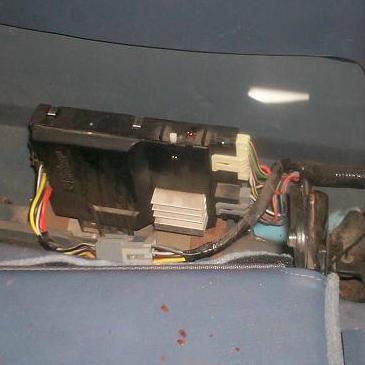

93-94 were identical so that write up will help you tremendously in tracking down the area the issue is in.
Ok so I found that the transfer motor was the issue, I tapped on it a few times and it engaged, the 4x4 light came on as so did the actual 4wd.
