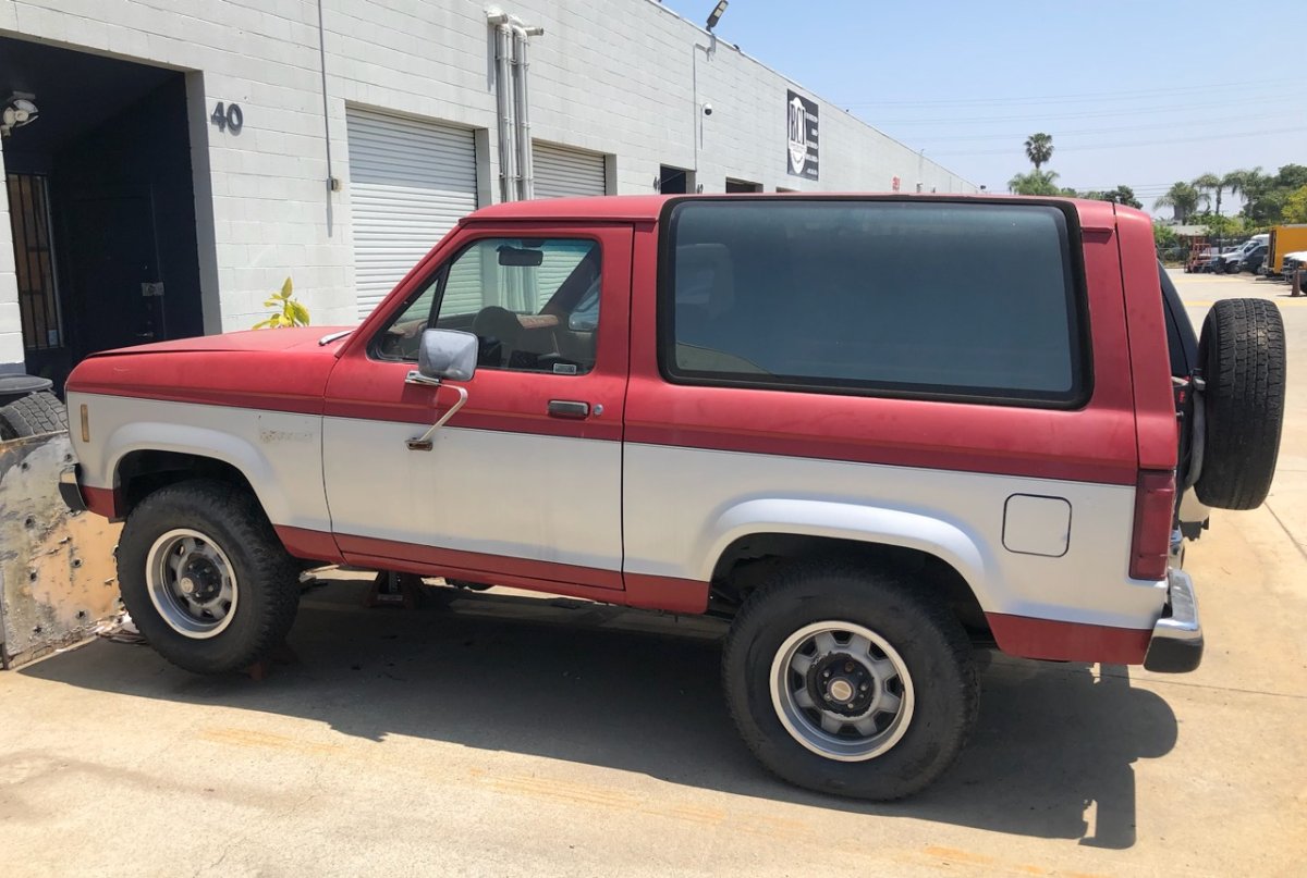

I’ve inherited my stepmoms 88 B2 with Auto Trans, push button 4wd engage, 2.9L with D28 stock axles.
I come from an off-road desert fabrication background but mainly 4.0 Rangers.
My ideas for the B2 are to make it a camping/Beach B2. Mainly fireroads and BLM camping.
I’ve built many 2wd toys for desert racing but I’m not looking to make that big of an investment in the B2.
So I’m curious how reliable these are for mild off-road?

Youll be fine.
Put a larger radiator in, heat is the biggest enemy to the 2.9...and D28's dont like big tires, but it doesnt sound like youll go over 31s or 33's
"Mild" off roading is subjective, but your rig will be perfect for dirt roads and camping. I did quite a bit of rock crawling with a D28 and 33's. Where you get into trouble is with a manual transmission, disregard for the gas pedal, cheap u-joints, worn out stuff... etc... an auto and a light foot will go a long ways. You'll be fine.
My wife's 87 has all of my trouble spots and she is not afraid of using the gas pedal and brute force to get through rough trails. It's pretty cool to watch, I just cringe thinking about all the things I broke that she hasn't broke yet but probably will eventually.
