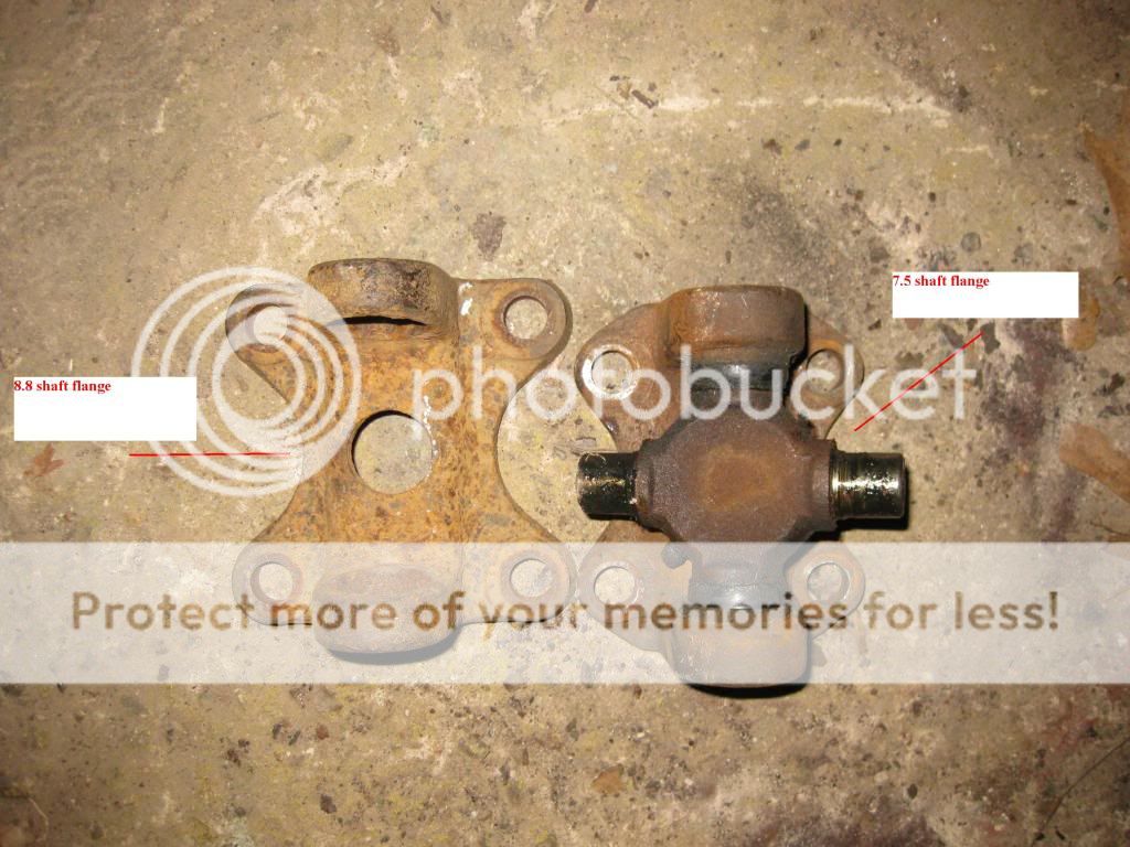

You want to change out this guy.

Ok. Went to the yard and looked over several trucks. But none of the flanges would work for me. My shaft uses a tiny little u joint. Not even close to the same size as the ones from an 8.8.
So I took a chance and pulled the whole rear section off of a 94 ext cab. From the slip joint back. I went home, slipped mine apart at the joint and slipped the new one on. Bolted it up to the rear and I was done.

Yeah I was under the impression that 8.8 shafts used a bigger joint, is there something I missed? I'd love to not have to re-drill another flange for my new 8.8.
somewhere around 88 they started using bigger U joints on all the shafts that were the same as the Explorer axles, schnot's solution is the easiest to get around that if you have the smaller joints
