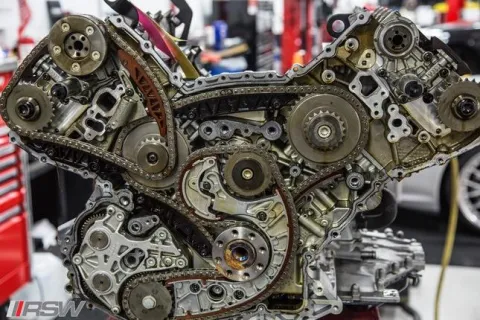

Any independent shop worth it's grease will be able to time a motor that was sold for 14 years. Especially one that sold in THAT kind of numbers..
***Hell.. just about every new double banked euro motor has A MUCH worse timing setup than the soch.. all on the back of the motor as well..
They still get er dun..
