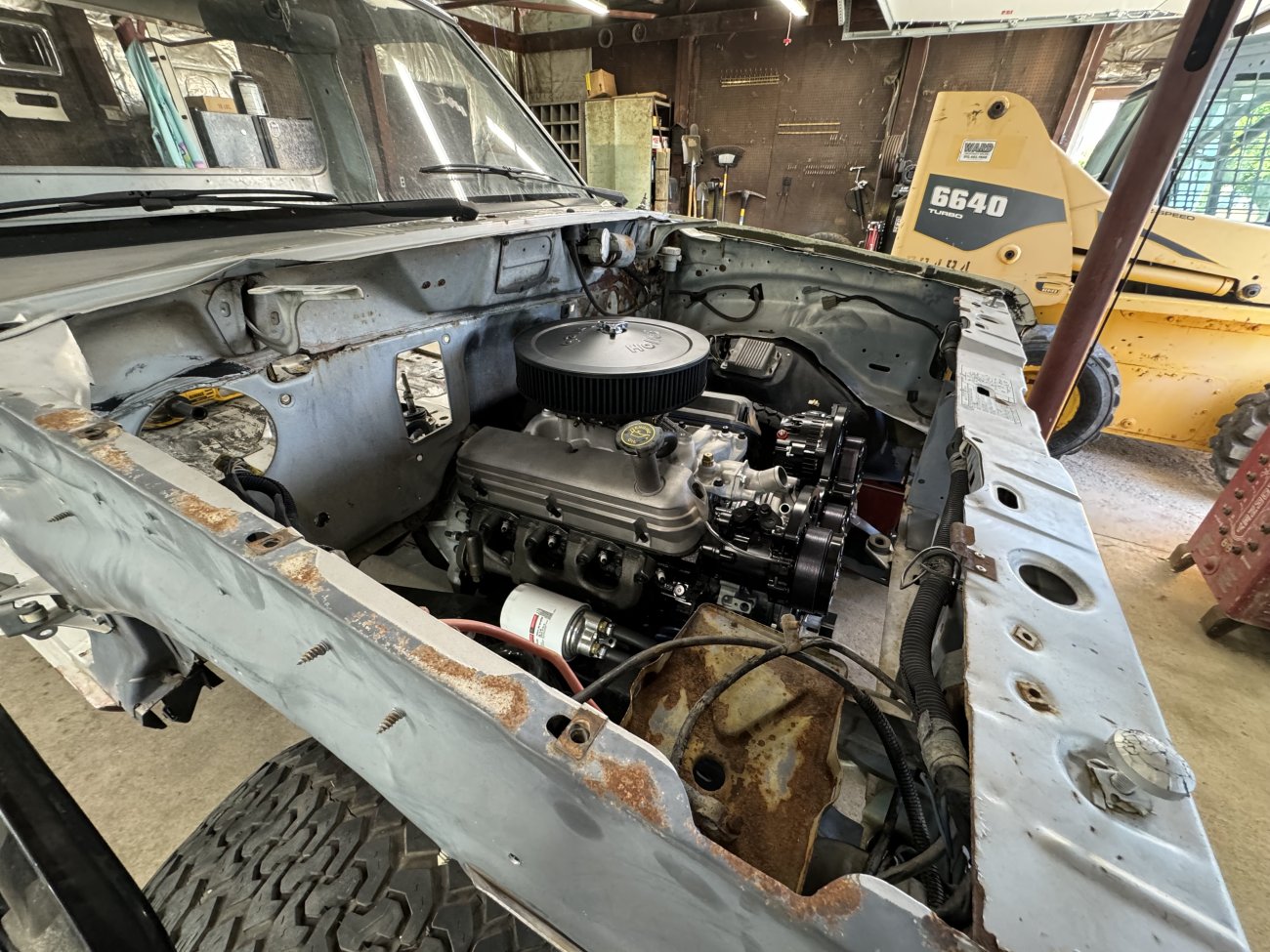

I haven't posted much since joining back in 2017 but I have a reason to post more now. I just bought an ‘89 Ranger to V8 swap. The truck is a base model regular cab short box and it's almost too clean to believe. It is a base trim with a 2.3, 5 speed, manual everything but power brakes. It has no options, but someone added a couple things to it, like a carpet and chrome mirrors and front bumper. Anyway, on to my motor mount questions.
I’ve been looking at any posts I can find about swap mounts and I’ve determined there are three “common” bolt in options.
I’m going to call option A the hybrid Explorer/4.0 option. This one uses the 4.0 motor mounts and flat plates to locates the engine. This is, or at least mimics, what Ford did with the 5.0 Explorers
Option B is the Advanced Adapter/Trans-dapt type adapters. Near as I can tell these are effectively the same part. I would not be surprised to find out they are made by the same supplier for the two vendors. These then use common engine mounts like Ford used on F series trucks and other cars in the 80’s.
Option C is the convertible/SN95 Mustang engine mount swapped side to side. This option bolts into slotted existing holes in the cross member.
I question if option A will survive service in a reasonably powerful 5.0, and by powerful I mean one that makes 350-375hp and about the same for torque. Because that’s my engine goal. Option B seems to locate the engine back farther. Maybe 1-2” judging by the photos I’ve seen. Option C sounds simplest to me, and is currently the front runner for my plan.
The use of on of the options hinges on questions that remain however. There are four areas of serviceability that concern me to varying degrees. Some have known solutions, so I am much less concerned with them. They are the remote oil filter options, the front engine accessory drive (FEAD), the exhaust header clearances and the accessibility to the bell housing bolts for service/repair.

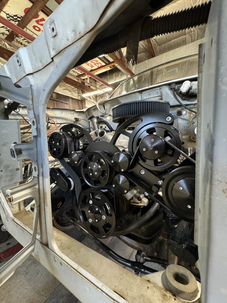

Next is the FEAD. I have an engine for the swap. It’s from a ‘91 Mustang LX. So I have the Foxbody FEAD on it currently. I also happen to have in my stash of parts two thirds of the SN95 FEAD. I only need the timing cover. Either option will require a water pump so I’m not worried about that. Ford Racing sold this as a kit for a time and claimed it shortened the engine by roughly 1-3/4”. The kit is discontinued, but it was nothing more than the SN95 timing cover and water pump.
I plan to run an electric fan so the clearance between the engine and the radiator matters very much to me. I would like to retain the LX FEAD because service parts are cheaper and I have all of them already. But I have the SN95 FEAD more or less available for added clearance. Does any one of the motor mount options rule out use of the LX FEAD? I plan to use a desert cooler type aluminum radiator. I will make or modify a shroud as needed.
