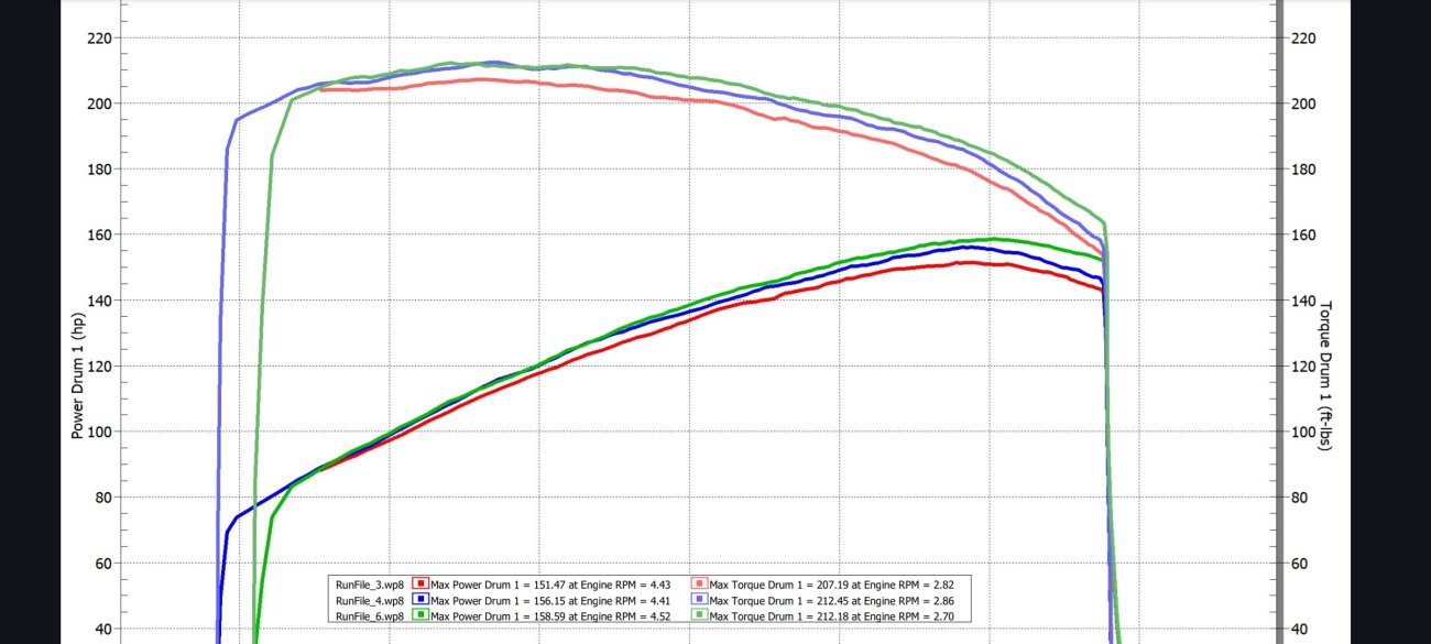

4.0 OHV Dyno w cam upgrade
clowe1965
10+ Year Member
Dec 11, 2012
19
1,601
1992
Read it and weep gents.
Stock 200k bottom end with hiflo oil pump
422 cam, beehive springs, non-professionally ported heads, shaved .030 so it should be around 10.5:1. stock everything else except it's straight piped from the y and back. 158@4500 and 212@2900
