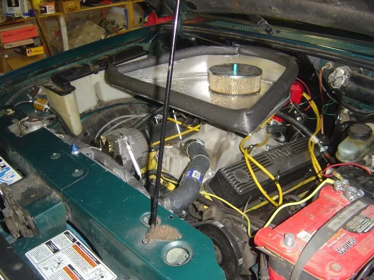

I used a Griffin PN# 25182 4 core aluminum radiator, cutout the radiator area a lil' at the top, notched it for the fill spout/cap, and if fit right in the original radiator pocket..............I also use a standard flexfan.............they make the same radiator setup for Ford hose outlets.............just don't remember the PN.............SORRY!:icon_confused:

Chvlfrk (Chevelle Freak?), Thanks for the pic of your radiator setup. However, I had rather not seen the small block chevy part. I had some idea like that about the radiator support. I bet you deburred that cutout real good. That would suck to get cut just trying to add a little water.
YES on the Chevelle Freak, I've owned 14 Chevelle/Malibu's to date.
As far as the SBC part, I went the cheap, reliable, massive parts availability route for the power.
YES, I deburred all of the cutout area, didn't want cut or to damage my aluminum radiator.
