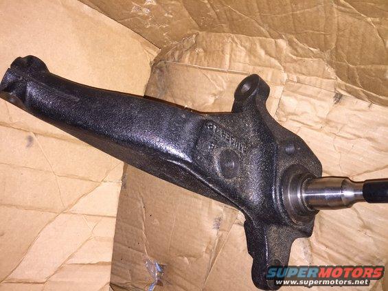

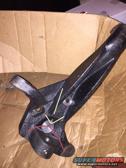

First time poster here, long story short I got a pair of spindles off craigslist. There's no serial numbers. It just raised letters that say "ranger Lp", IV read about having to grid alittle on the LCA TO get your steering radius back. Unlike my old spindles the rounded part Around the ball joint of the control arm sits super tight inside the spindle and looks like I have to grind all the way about the lower ball joint are on the LCA, not just not just grind a little off each side for steering radius . Anyone have this problem. ? Spindle add said for 2004 -2010 3" spindle lift coil sprung only. I'll post pics in the morning. How much grinding in the LCA and the spindle is too much grinding?
