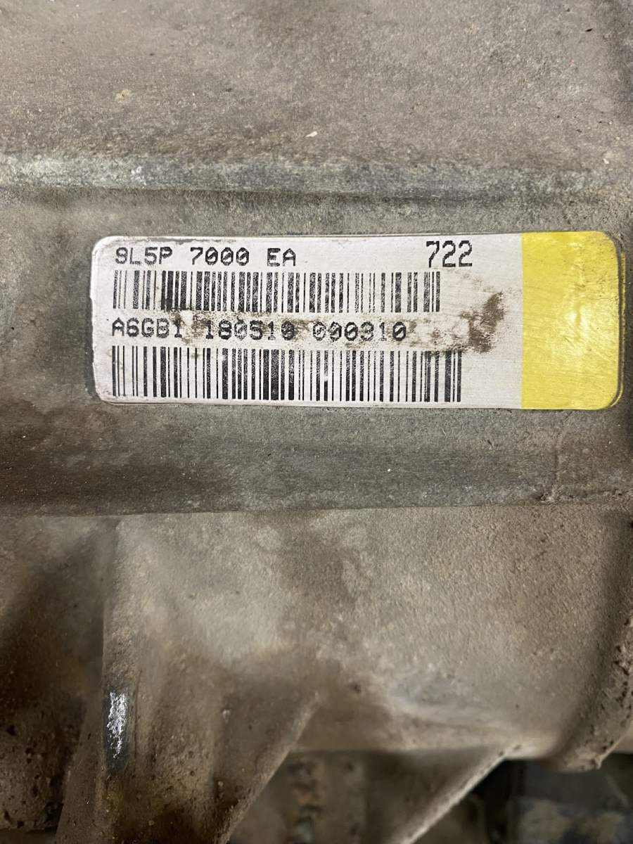

But I have another question that you or someone might know? My Vin number is saying that my transmission should be a 5r55E but the sticker on my transmission that we pulled off says it is a 5r55S? (if im reading the sticker correctly?) Is this a problem? did someone install the wrong tranny before me? or do they swap out pretty easily between both models?

We found a transmission off a 2010 (ours is a 2011) numbers say its a 5r55e

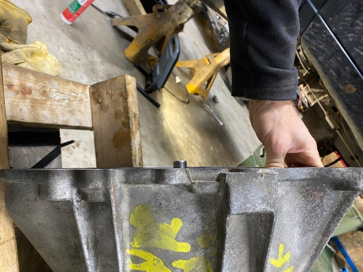

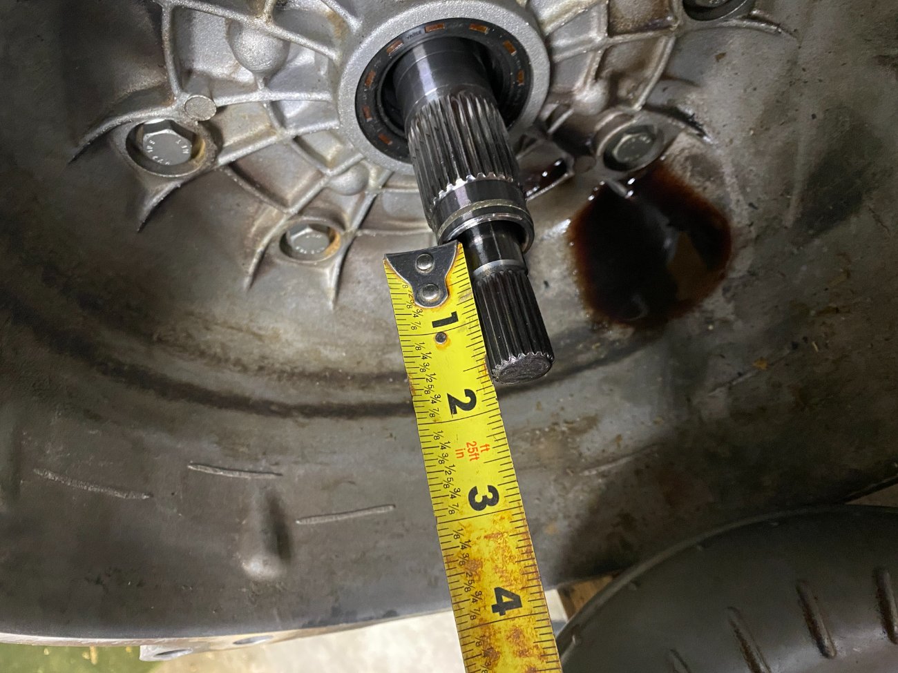

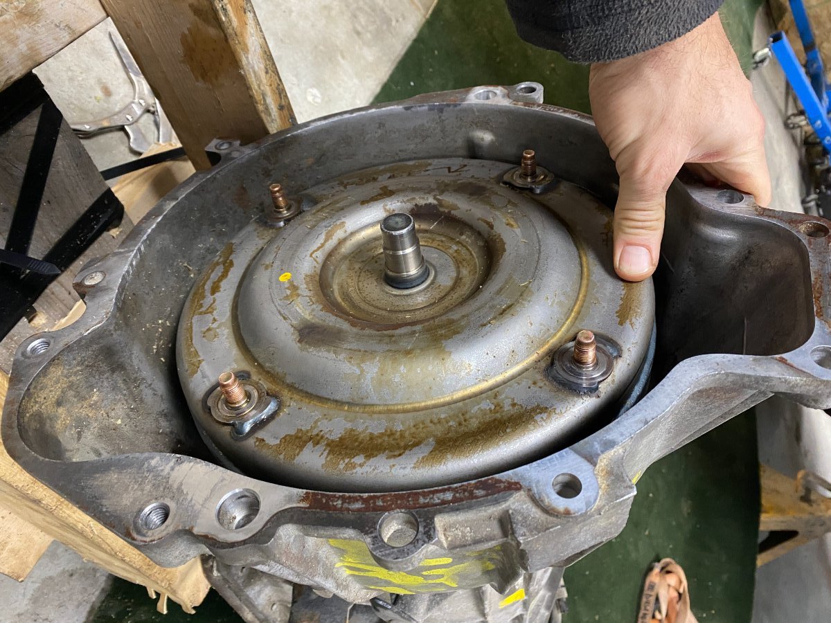

But we can't get it to fit on, then got to measuring and inspecting. I am worried the input shaft slid out a littleand the torque converter won't seat all the way back. or is this the correct amount of input shaft showing? If it isn't does this thing slide out? I have been searching, some say yes, but then others say that it is connected to the pump and won't slide out?
My measurement from bell housing to converter pads is about an 1"
Or can I just not get this torque converter to seat properly? I have watched so many video of the third clunk but mine is still a bit loose when it's low in there.
ANY help would be great. Thanks!!

I'm just a novice around here.
However I did my transmission a few months back.
And for me to get the third click on the torque converter sliding into place I had to have the pan of the transmission sitting on the ground. I then had to lift the torque converter up just a slight bit and actually turn it backwards to get it to go in all the way.
I don't know if this will help you or not but that's what I found happened to me and worked for me.
I have a 94 4.0L with an automatic A4LD transmission and my truck is two wheel drive.
I know that most people say don't turn your torque converter backwards but as long as you're not turning it full revolutions multiple revolutions, I don't think there's actually a problem with it.
If you don't feel comfortable doing this, then don't do it.
As for the input shaft I don't know if it's the right amount sticking out or not I can't tell you yes or no on that sorry about that. I kind of think it's out a little bit to much but I'm not sure.
However I can tell you that my input shaft slid out of my transmission as I was lefting my transmission the day I charged the rear seal.
I slid it back in and didn't have no problems putting my transmission in.

Thanks a bunch, we will try almost anything:) Thanks for the ideas. I have been scouring online, and from what i can tell the newer input shafts are mounted to the pump bearing and don't slide out like the older ones. I will go set it on the ground flat and give it another go. I have had it tilted for most of the "seating" efforts.
Thanks again
Everything about the 2010 is the same as the 2011, so the transmission should go right in. A few people have struggled with the torque converter seating properly lately. Everything has to line up just right and can be very finicky.
It is being verrrry finicky, k thanks for the support. we will keep trying to get it seated. If there is anyone out there that has a video or a pic of a 2010 model of 5r55e that would be great to see.
Thanks again Ranger Station!!
Most all transmissions, when everything is correct, you should be able to push and pull the torque convertor forward and backward about 1/4 inch or so when everything is bolted up. If you get the transmission close, double check the torque convertor, don't force the transmission to the engine with the bellhousing bolts. The torque convertor gets jammed into the oil pump on the tranny and ruins or cracks something every time.
Update if anyone is interested;)
The center shaft was indeed stuck/jammed inside the larger spline shaft and was hanging out too far and was bottoming out the torque converter.
The search for a replacement continues.
