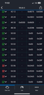

Another thing I noticed is that when I used my Bluedriver OBDII tool and reset my codes that my CEL went off but the ABS light never did go out even after confirming the reset with the tool. I thought this was strange since I don't have any other ABS codes present except the Right side ABS sensor code.
One other thing, I'm looking for a way to identify the faulted Forscan codes in the attached files. That would be of great help if you were able to assist with identifying them.
