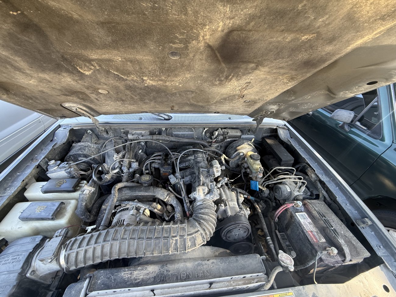

How can I check if I have an OHV or SOHC engine?
Post a picture from under the hood and we can tell ya. Or check the VIN maybe?
  • 2000 XLT 4x4 off-road package 4.0 V6

Looks like OHV to me. Note the intake curves off to the passenger side.
4.0 SOHC

Notice how the runners go to each side from the middle?
