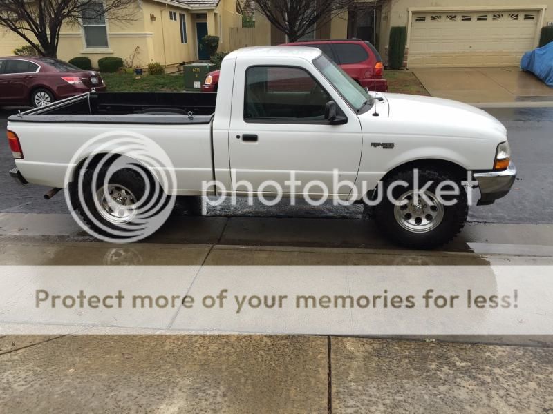

just picked up a 2000 2wd regular cab ranger coil spring suspension
bought a set of used lift spindles from a guy who went sas, they are 3" lift spindles
I found a set of ultra 8 hole 15x8 3.5 bs on a set of 32x11.50x15 bfg mud ta
my question is, will the tires clear everything?
I do not want to lift the rear more and an inch, but if i have to ill used 1" blocks
I went through 30 pages of searching, found a little but nothing definitive
thanks, Cody
Hey there. I have the same lift if it's from fabtech, 3.5 in the front and I cleared 245-75-16 fine, I don't see a problem with 32's. The rear I did a shackle lift because I broke one of the add a leafs in two spots. When these tires run out I'll put on 285-75-16. You will probably trim the inside bottom part of your bumper.
Good luck
i got antsy and installed the wheels and tires today in the rain. they actually clear without any modification.
