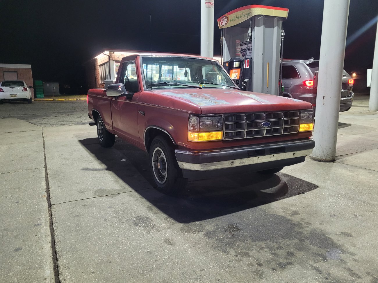

I have an 89 2.9 Ranger. It's kind of junky, it's reliable about 75%. It just has to last me until the winter so I can save and buy a second gen. That being said, it has a cracked head and if I do replace it, I want to put headers or different exhuast manifolds on it. Are there any other exhuast manifolds that fit from any other 2.9? 3.0L or 4.0L headers? I love the truck and really it's my gateway into teaching myself how to work on cars

I think youre pretty much stuck with 2.9 stuff. I know 3.0 wont work and despite the 4.0 being the 2.9s closest cousin i dont think theyll work either...ive never messed with it but i think its been tried around here before.
However...i do believe a company or two is still making aftermarket headers for them.
Yeah, you have a second gen. 89-92 was second gen.
That said, if you can find the appropriate donor, a 4.0 is a relatively easy upgrade. Find ideally a 90-92 Ranger with a 4.0, you need the engine, computer and wiring harness. Bolts right in and should be pretty much plug and play. I did that on my 89 Bronco II years ago. The transmission will bolt up and work for awhile, but the 4.0 trucks got a stronger transmission.

All OHV 4.0l headers and manifolds fit, the 98+ spec OHV 4.0l exhaust manifold offers improved flow over it's predecessors and match exhaust port size; make certain that you understand the difference between 1991-2000 OHV 4.0l and 2000+ SOHC 4.0l, which do not fit.
@Kenobi77 had a set that I believe he decided not to use; message him ..)
