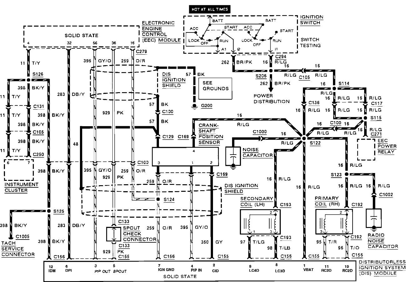

The guy in this book may be wrong. The diagram below shows the tach signal as pin 12 on the DIS module.

The tach is somehow driven by the drivers side coil output in the DIS module, my tach didn't work until that was hooked to a coil... so there's something wrong with the wiring to the drivers side coil or somehow the power or ground to the DIS module. I'm assuming you only bolted it on with the 3 bolts it's held on with from the factory as that's important but even if it's not grounded to those bolts it'll run fine for a while then just stall not what you're getting (I know from experience, how I rolled my '90)

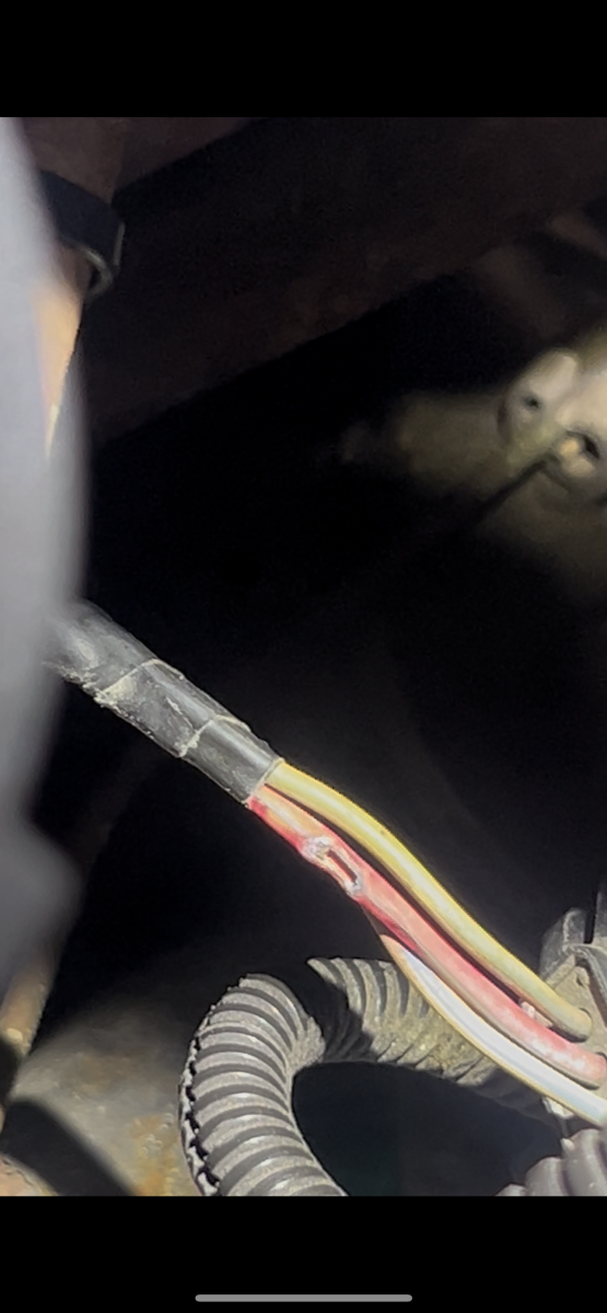

since this forum is almost useless in terms of updates of fixes or anything, i'll contribute mine. after inspection of the wiring, and checking for continuity on the harness. i found the red w/ green tracer wire (middle wire, lower coil pack plug) had a ~1/4" section that had rubbed the power steering return hose, and all the wire was gone. it was corroded all the way up into the plug and about 6" back into the harness. after cutting back the loom, stripping back the harness to a good section of that wire, de-pinning the plug and removing the middle pin/wire, and letting the pin end of that wire soak in some cola, i spliced in a new wire. reset codes, and it fired up with tach in operation and no more hesitation/missfire. thanks for anyone who helped me with this.
That is completely crazy and would definitely cause that issue! Like I said the tach is driven off of that side and relies on the coil working which it won't without the power wire in the middle.
Glad you got it working!
