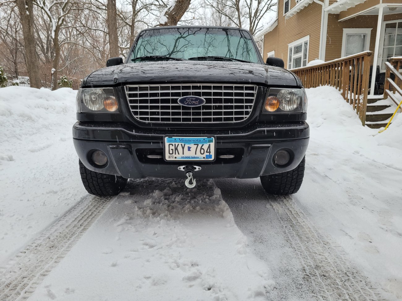

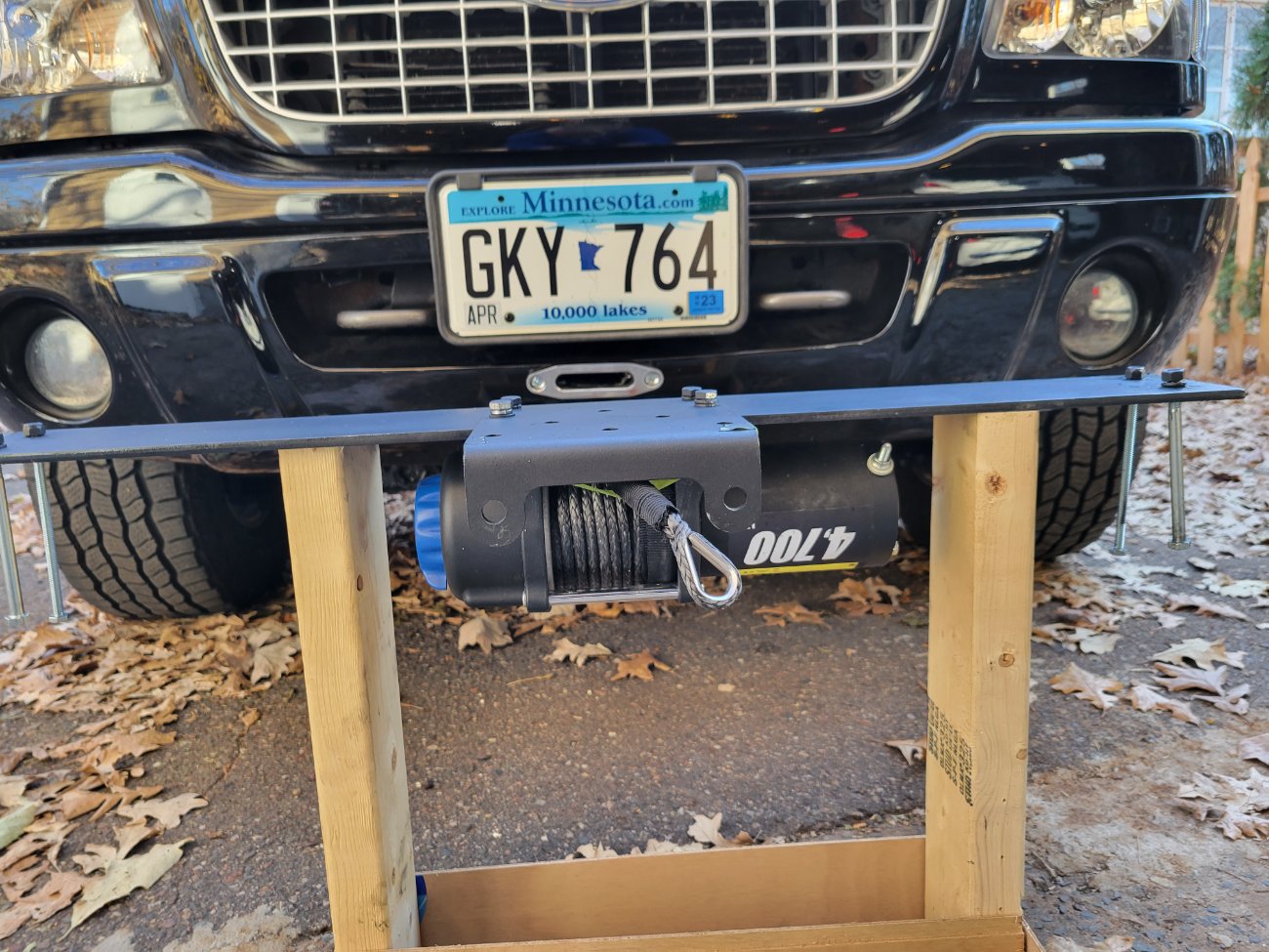

Yes, I put a four point five ton winch behind my front bumper. I would not recommend it for off road, but it works well when pulling in straight lines and on a flat paved street. The same principle might work for something bigger, but there is just not enough room down there.
You mean 4,500#, correct? 4.5 ton would be 9,000#…
Yes, correct. A little winch is good on city streets and tight places. You can go slow and see what you are doing. It's not going to pull a Humvee out of the mud.

Yes, correct. A little winch is good on city streets and tight places. You can go slow and see what you are doing. It's not going to pull a Humvee out of the mud.View attachment 133848
