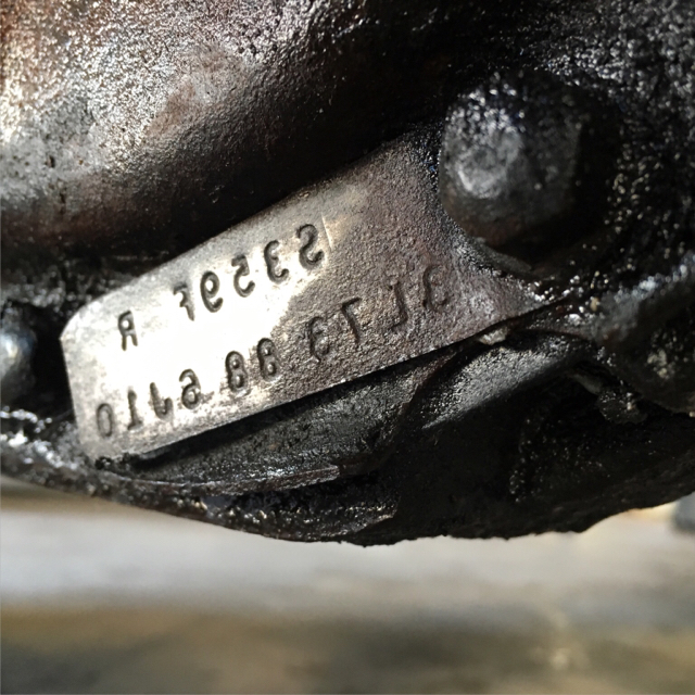

Anybody know what kind of oil I should be using for the rear diff? And do I need the additive for LS?
3L73 88
Thanks!
yes, it is a 8.8" differential with 3.73 ratio and "L" for limited slip.
2 quarts Motorcraft SAE 80W-90 Rear Axle Lubricant + 4 ounces Friction Modifier XL-3 for the Limited slip.
I put in the 4 ounces first, lol, then top it up with the 80w, it can hold a bit over the 2 quarts, 5 pints(2.5quarts) is spec on some
Thanks a lot!
