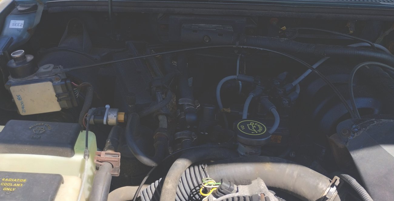

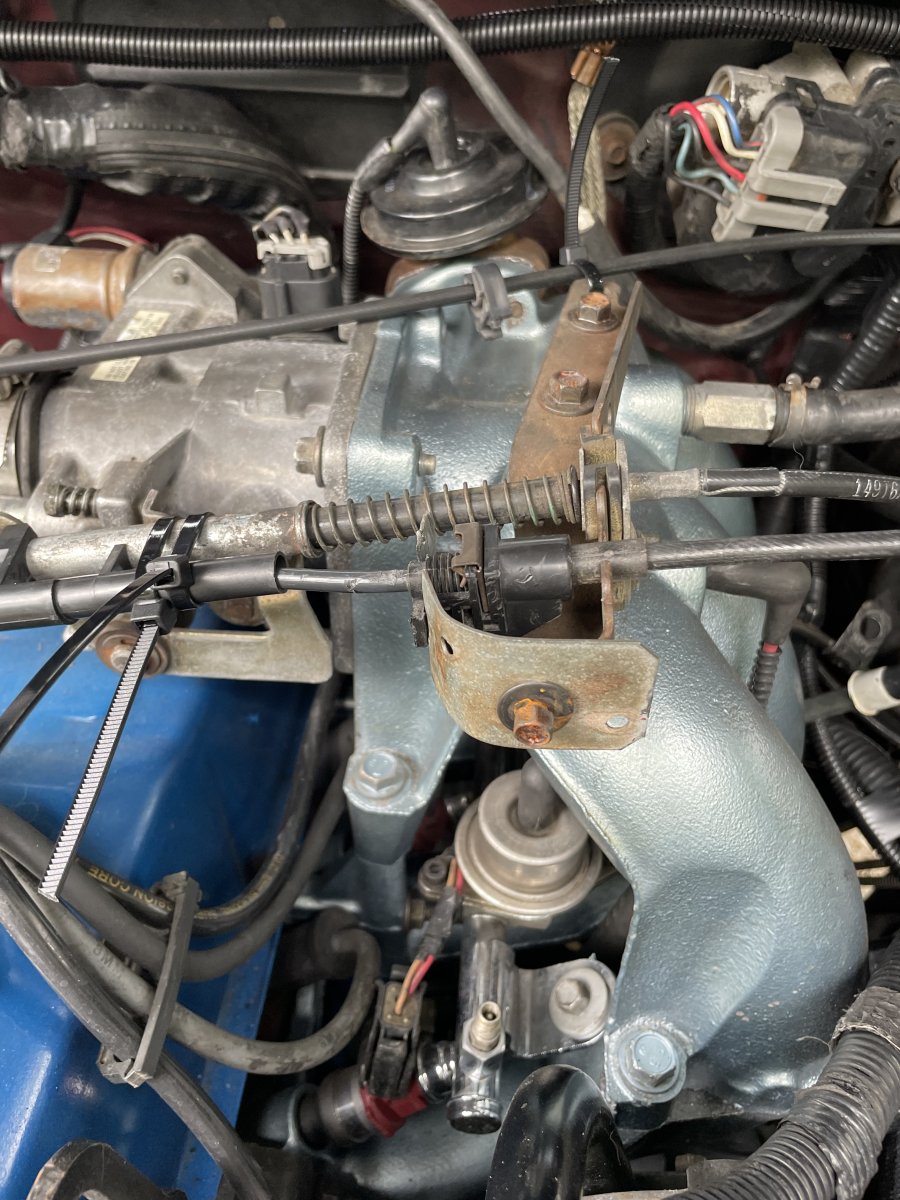

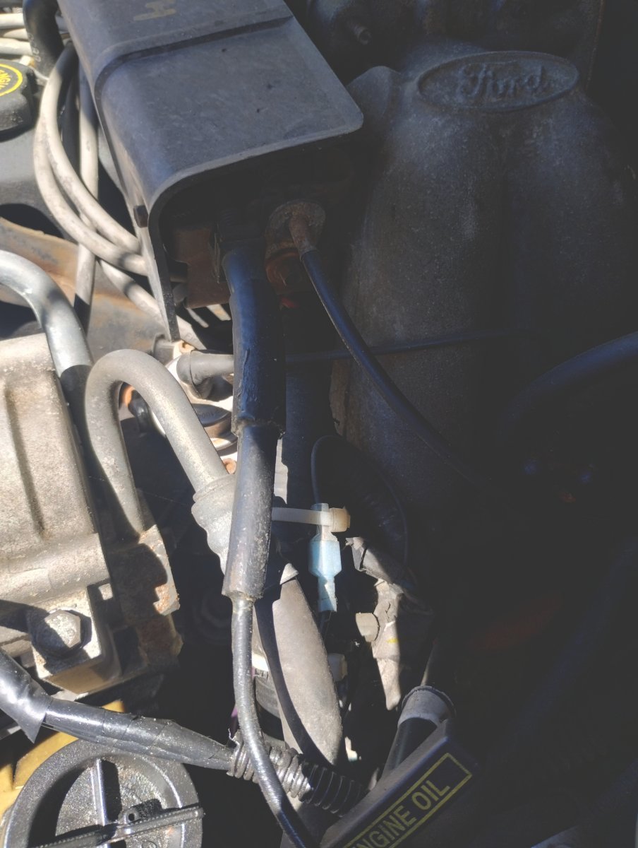

I'm also not sure how valuable pics would be. My homebrew setup is on the '94, which is the old vacuum servo system. My '95 with the same servo as yours is native 4.0. I guess you can see how I sheathed the ends of the cable:
'94:
'95:

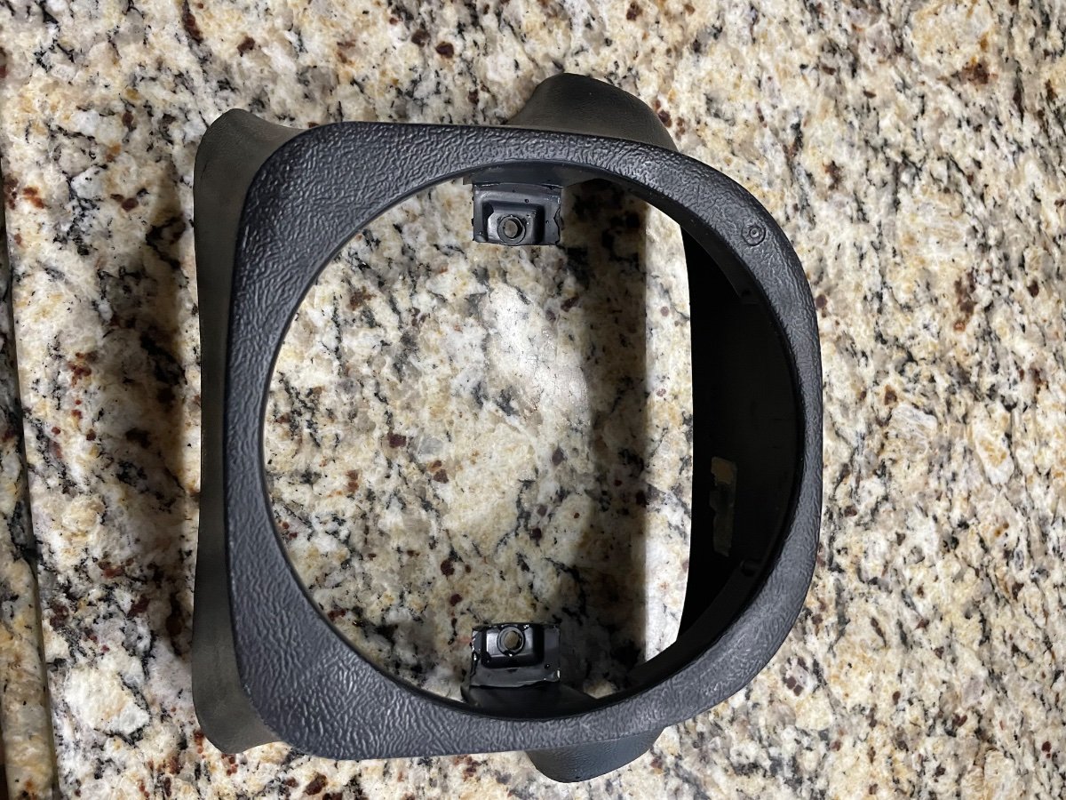

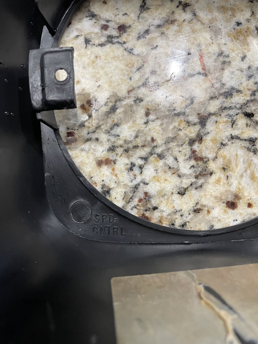

Just to add in case anyone else is adding cruise from scratch. You will need a different trim piece that goes behind the steering wheel for your cruise switches to fit. I got it from a 98 Explorer. The original trim piece won’t allow you to correctly screw in your switches. On the inside you will note that it is for speed control. My original one said”Base”. Hope this helps
