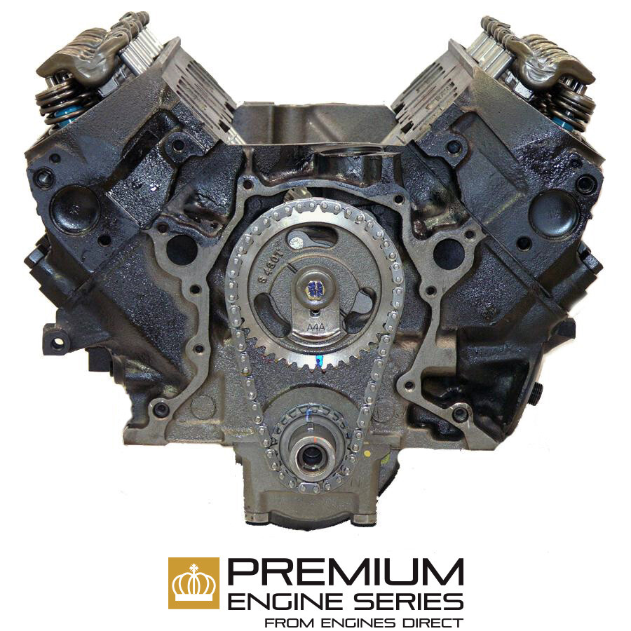

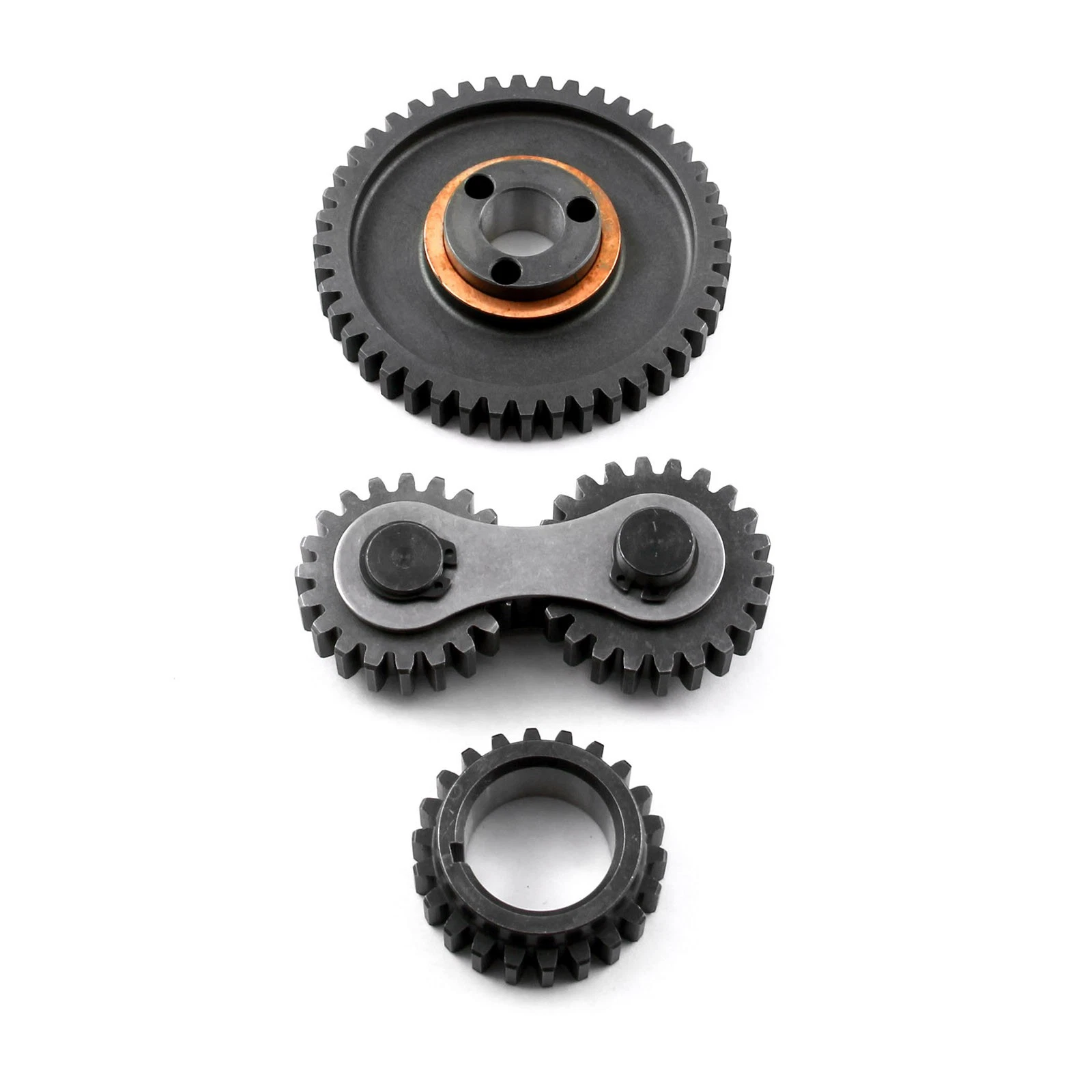

The issue with mix matching things like that is the camshafts spin in opposite directions when you have timing gears like the 2.8 and a chain like the 2.9.
More popular timing chain engines have aftermarket timing gear options but they have idler gears to keep the camshafts spinning the correct direction. They sound horrible and I think in general are kind of dying out so I doubt anyone makes them for the 2.9.

302 timing chain (2.9 similar, couldn't find a good pic)

Ford 302 timing gear conversion

Meanwhile, I am hoping someone who knows for a fact jumps in to let me know if the chain can be replaced with the gears and, if so, does the cover also need to be replaced?
While I was typing, you were posting (I type real slow, 1 finger). Hadn't thought about rotation. So it's chain for sure. Thanks.
