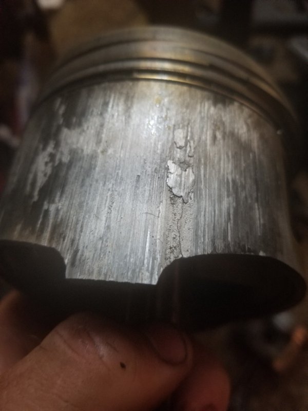

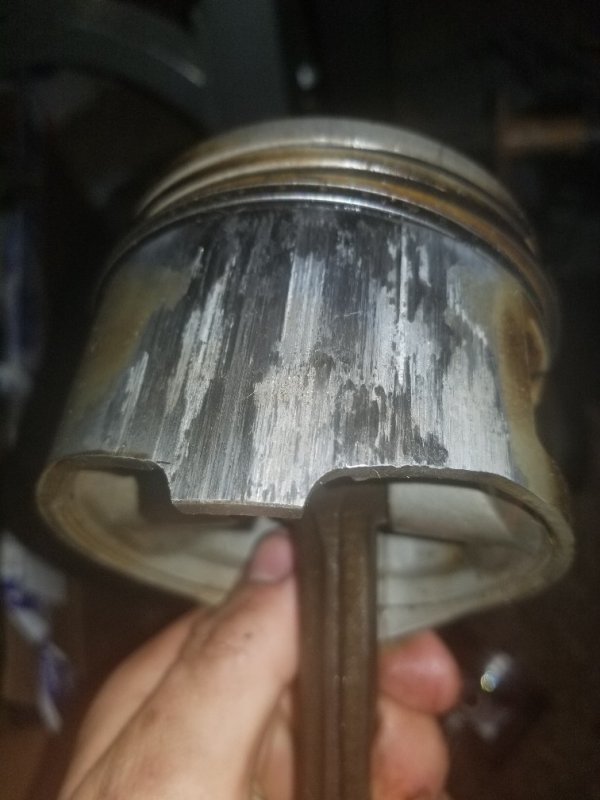

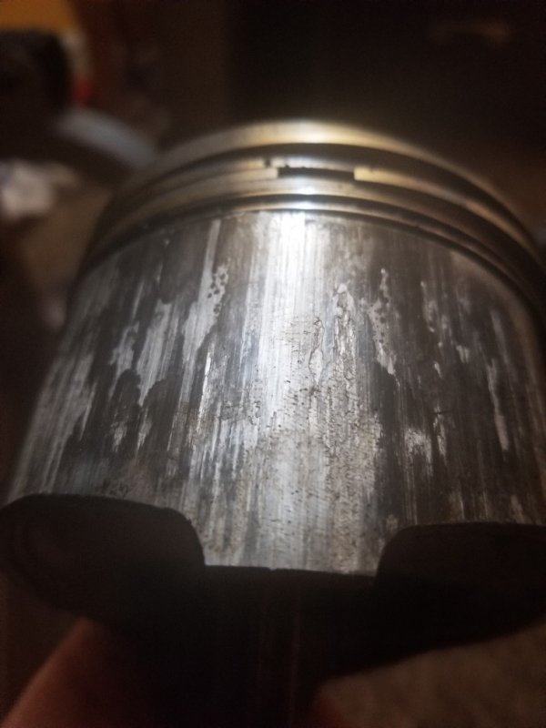

You received new pistons. What was the recommended piston wall clearance? Those old pistons look as if there wasn't enough clearance, so it makes sense to check so it doesn't happen again. Maybe ran dry on oil? The new bore looks pretty good, I don't see any sign of a lip at the top of the bore. See if you can borrow or rent the correct measuring tools. You should measure at the top of the bore and the bottom. There shouldn't be more than about .004 taper, tho I might go too .007 if I was really strapped for cash. Also measure N - S and E - W to make sure the bore is round.

My guess to what happened is the block was bored and someone put 0.040 rings on a stock piston... the OP said they were stock size. The damage was likely from the piston trying to turn itself over being a sloppy fit. Either way... something went horribly wrong and it failure needs to be root caused before proceeding with assembly.
Th OP stated that the pistons were stamped 040 in the first post. I'd like to see a pic of those stamps. I find it hard to believe they were stamped 0.040" over but measure to the standard bore size. That galding and scoring could also be from the piston not having sufficient clearance in the bore. I don't know what the spec is off the top of my head, but I'd guess it to be around 0.008". Do not try to run your new pistons until you've had this all verified by qualified people with accurate instruments.
