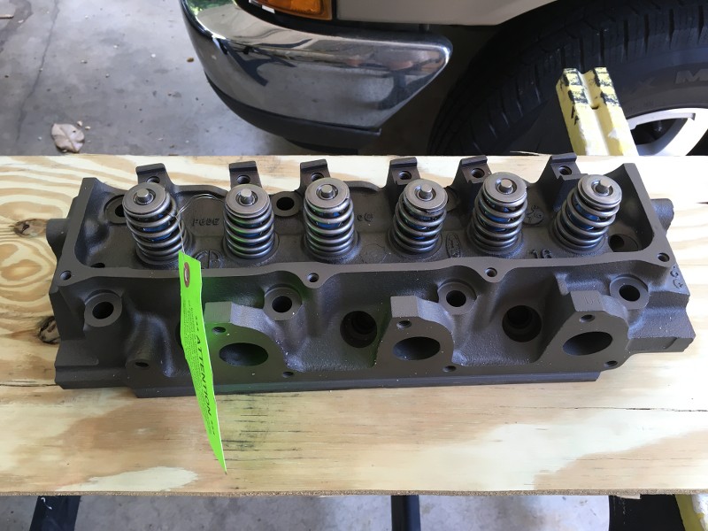

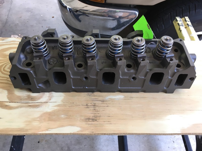

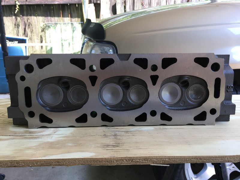

I bought a set of heads from The Cylinder Head Shop out of WV on ebay for $299, no cores needed to send back, along with head bolts and a Felpro gasket kit.
Got the heads yesterday.

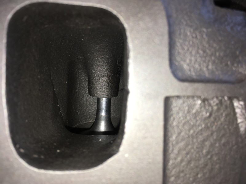

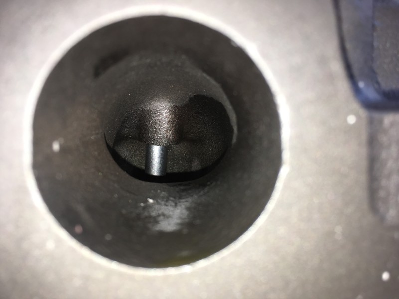

Upon inspection, I am most likely not going to go through the hassle of taking them apart, grinding, cleaning and reassembling. They showed up in much better shape than I was expecting. There isn't much room for port matching to the intake manifold gasket, the valves could be unshrouded a little, but not very much, and there is no casting flash in the runners. I ran my finger through all of them and there are no sharp edges, no flakes sticking off the walls and and all the turns are rounded over already.
I am going to go around the lip where the heads were surfaced and knock off that knife edge where it transitions from deck surface to combustion chamber to help with pinging. I don't see any other sharp edges that would make detonation a problem.
The most work to do would be smoothing the valve guides over to a more rounded tip and like I said, I am not pulling them apart since they are so well assembled right now.
I am going to look over the intake while it off and see how bad it might be.

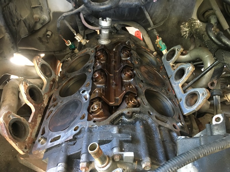

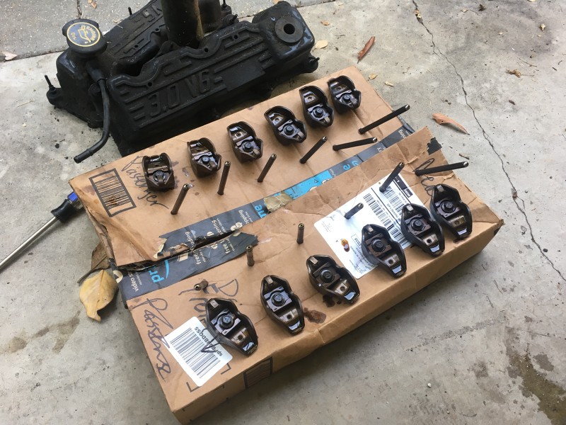

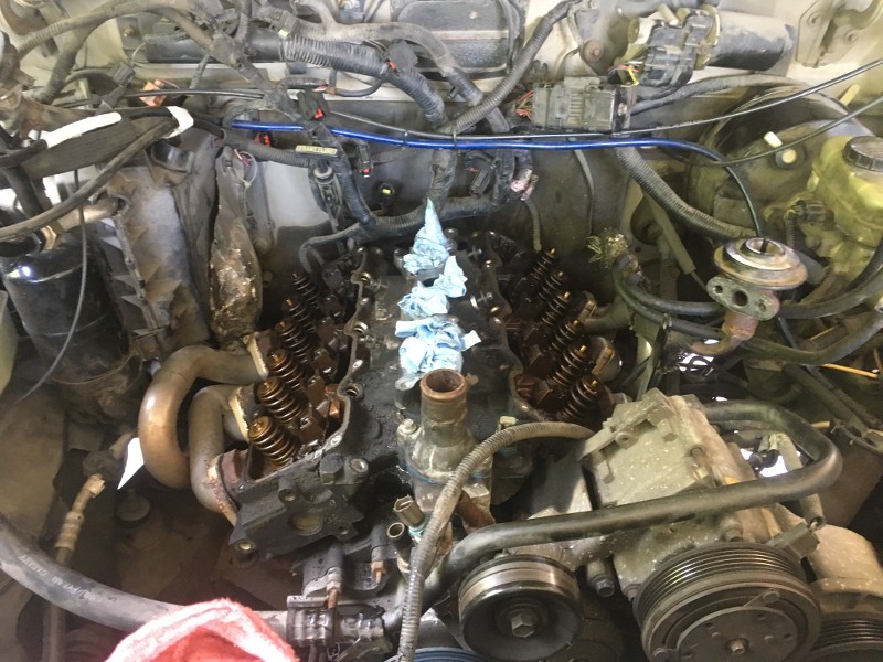

5-27-2018
Today was disassembly. No broken bolts!!!!

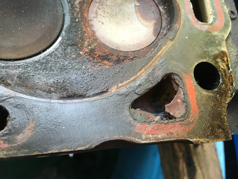

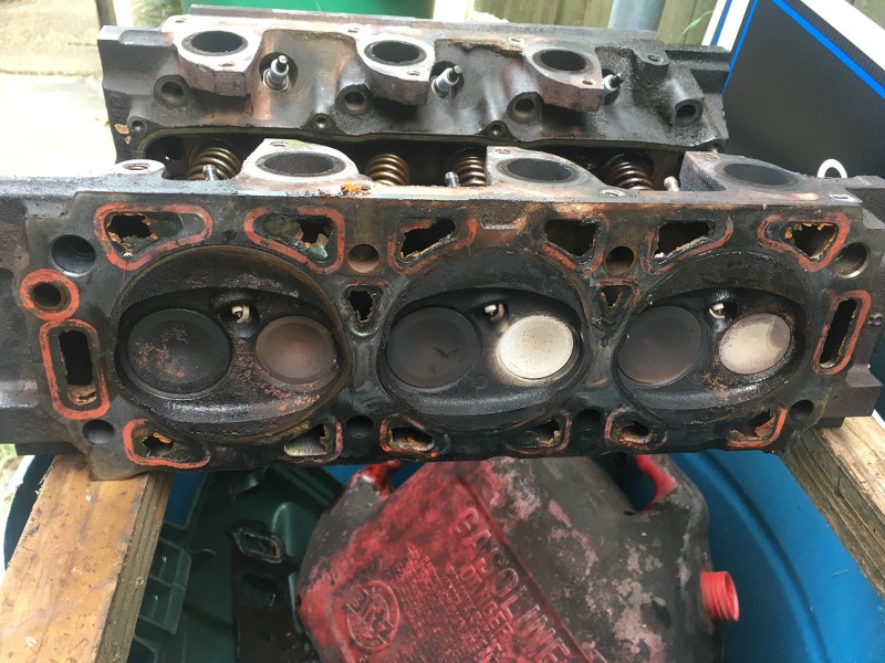

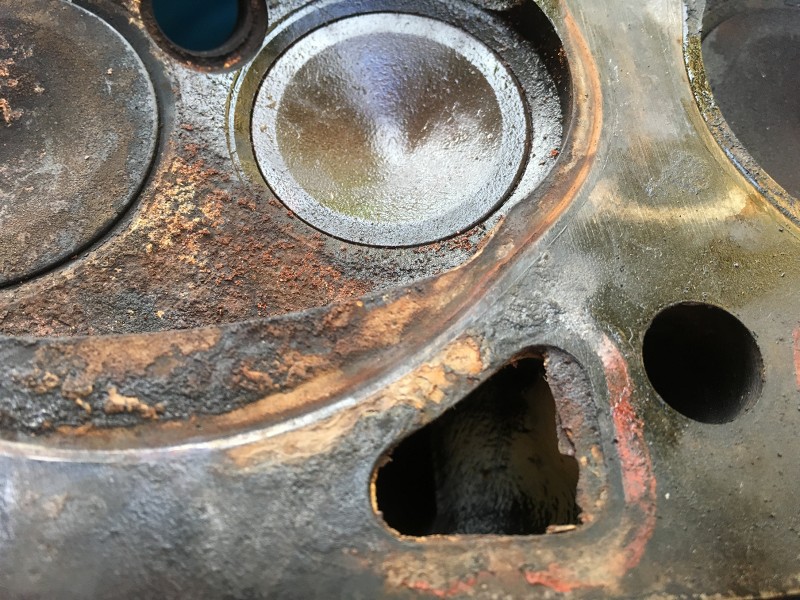

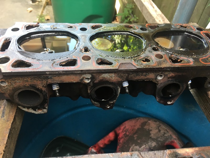

Once the heads were off, my guess on the drivers side head having issues was confirmed by looking at the #4 and #6 exhaust valves:
Head swap on 2000 3.0

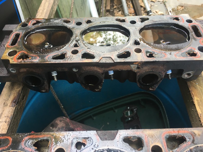

Cylinders 1,2 and 3 had varying amounts of heat in them as well:
Then I laid the heads flat and filled the combustion chambers with brake parts cleaner and had 5 out of 6 exhaust valves leaking by with the brake parts cleaner coming out of the exhaust ports:

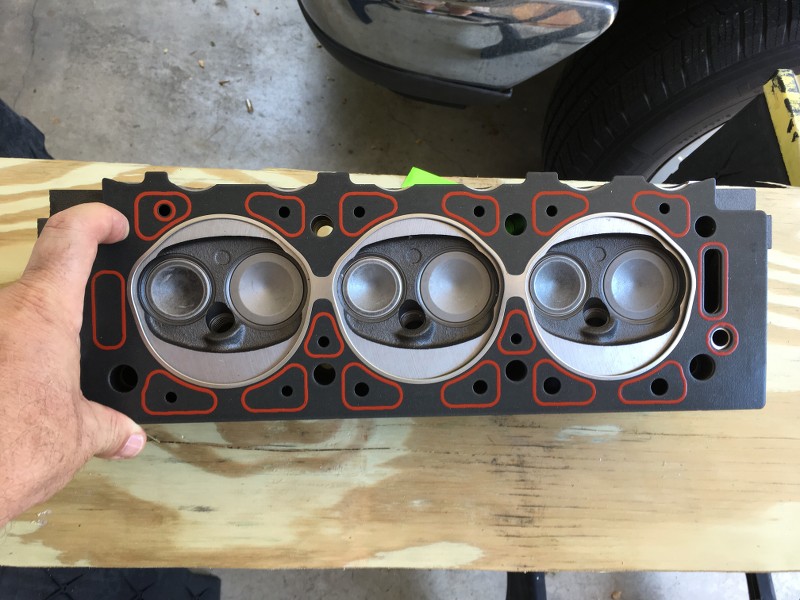

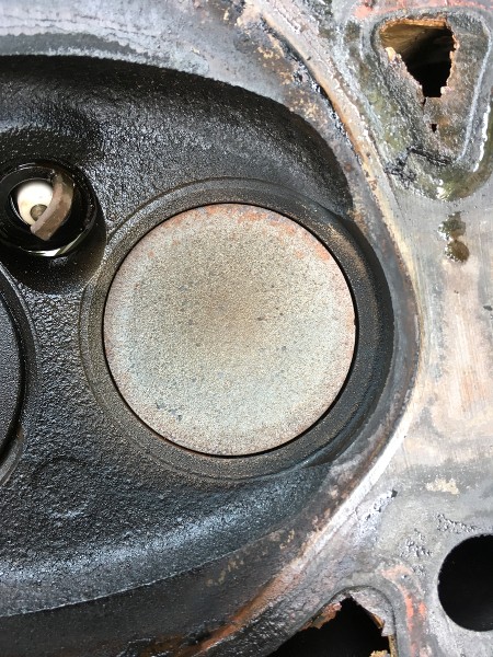

Then I tried to get some better shots at how the valves are sitting in the heads. You can see that they have somewhat shifted in the seat to one side:

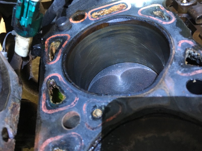

One thing I am happy to see is that the cylinder wall still have a cross hatch after 180,000 miles and no detectable ridge at the top of the cylinder:

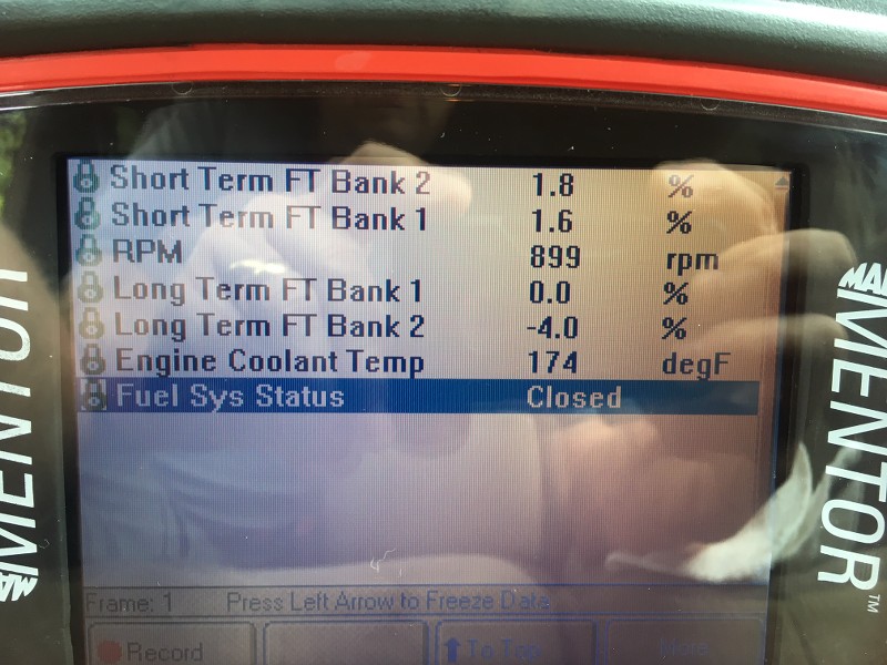

Swapped out the O2 sensors today. Had to buy the O2 sensor crows foot wrench from Harbor Freight. That made it much easier.
Fired the truck up and once the fuel system went closed loop, Bank one was +1% long term and Bank two is -1% long term. So I am hoping the fuel trims will be nearly perfect once the computer reads for a while and gets the fuel tables sorted out.

Here's the data stream after all engine related repairs done. The computer still has to relearn the fuel trims after the new O2 sensors. Went from +25% and +17% to 0% and -4% on long term. I think that proves I don't have any vacuum leaks and all is well. Now once the ball joints arrive from Rockauto, I can rebuild the front end and have it back as my daily driver. Until then, its horrible gas mileage in the F150.
