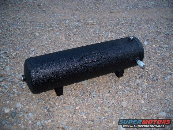

this is the tank i have
http://www.4x4groupbuy.com/store/performance-gallon-tank-p-9103.html
adding AC Compressor.
and I got a squareD ajustable pressure switch today..

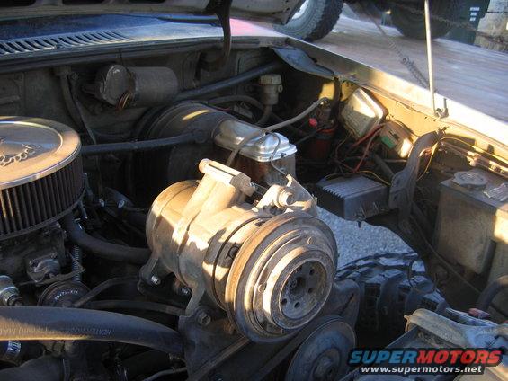

now i just gotta figure out this damn compressor pully lining up.... does something look wrong in the picture i posted? perhaps i will need to put a spacer in that front bolts and move those tabs to the back of the mount, that should push it back a good 3/4"?
I cant remember what a 2.8 looks like with A/C, its been over a year. What did it look like coming of the donar vehicle? Hopefully the compressor works.
it was on a 2.9.....
and the compressor works, already locked the clutch and spun it.
You might have to make it work for you by movig it back the 3/4 of an inch. How do you lock the clutch? Have an A/C problem on a van and want to check if the compressor went bad.
i just took the two wires off of the plug and touched it to the battery positive and negative. locks the clutch.
