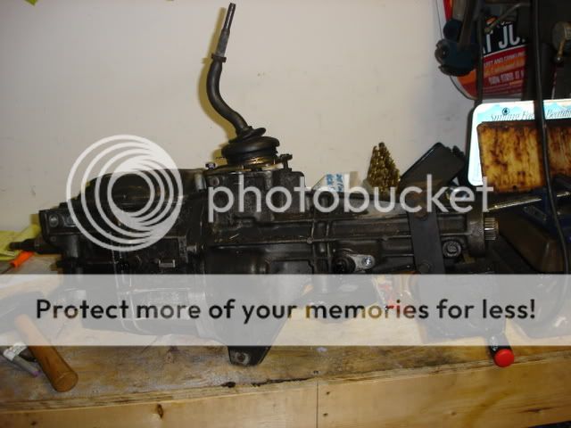

You can move the T5 shifter location 8 inches forward if you get the T5 S10 tail shaft housing with mechanical speedo.
Im gonna be trying to use this stuff for a T5 im putting in the ranger this weekend.
Ill let you know how it went if I get everything done.
A T5 from an 87-93 works good the input shaft is longer on the 3.8s or the 94/95 mustang i think.

That modern drive line is a huge difference in shifter location!700.00 bucks though.
You really need the tail housing and the shifter rob I think.

If u have buckets seats I think u just need to cut a new hole and lose a center console if u have one
