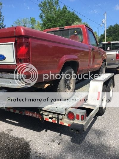

Purchased today (4/17/2016) a 1991 Ford ranger xlt regular cab with 2.3l blown head gasket, automatic transmission, and 7.5" 4.10 rearend.
She was brought home on a trailer. "She was ran a little hot, I think everything is okay. Changed the timing belt. Turned her over but wouldn't start. May have a blown headgasket."
Yeah it may have a blown headgaset....
