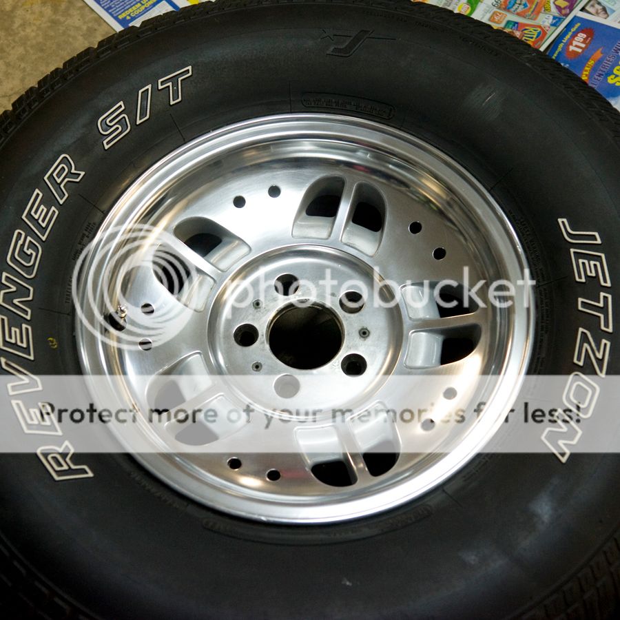

Just finished stripping, sanding and polishing one of my deer hoof rims off of my 93. Its winter so I figured I'd take a swing at making them look nice for the summer :D Also painted the first of my center caps to match the truck because the chrome was peeling off. I couldn't find anything on here of anyone doing this so I figured I'd share some pics!
before:
http://s1289.beta.photobucket.com/u...ger 4x4/wheelbefore_3852_zpsfa29048c.jpg.html
after:
http://s1289.beta.photobucket.com/u...er 4x4/RangerWheels_4018_zps4adad481.jpg.html
side by side:
http://s1289.beta.photobucket.com/u...er 4x4/RangerWheels_4022_zpse76de589.jpg.html
With color matched center cap:
http://s1289.beta.photobucket.com/u...er 4x4/RangerWheels_4019_zps3cfa1789.jpg.html

hit it with the aircraft stripper first, and then begin polishing. it's easier when the paint and clearcoat are not in the way.
when I did my 16" explorer wheels, i went for a brushed finish instead of polished, using a 3m pad chucked up in a drill.
I used paint stripper gel with steel wool and avoided inside the hoofs where its painted. Aircraft stripper might be easier but I have no experience with it. That took care of the clear. Then I moved on to 180 grit wet/dry (this got rid of most of the machine lines and oxidization) then on to 400 wet, after quite a while with that I used 2000 wet. It would probably be better to use 800 wet and then 1500 wet in between the 400 and 2k but we didnt have any.

Let me know how the stuff you used on the center cap works out over time, I've used regular spray paint, and truck bed liner on the rims and caps, and although the rims still look good, the caps seem to start peeling after a year.
Thanks! I hope it lasts, I just sanded them then one coat of primer, 3 coats of duplicolor color match stuff, then 3 coats of clear. They'll probably end up chipping and flaking anyway.
