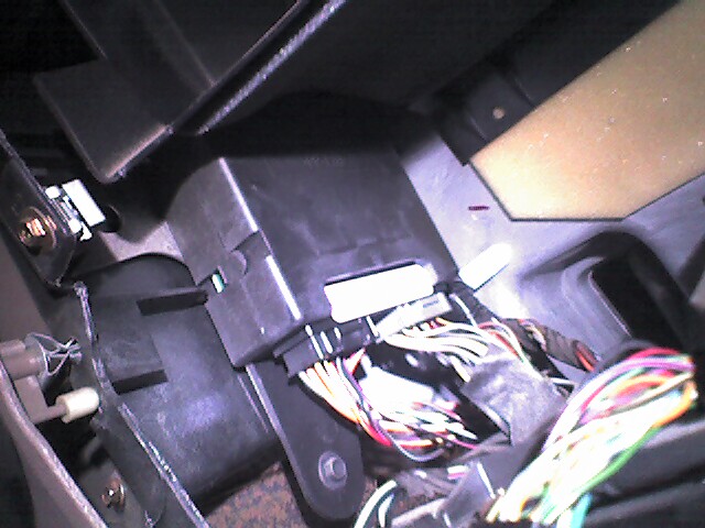

Sounds right, here is exactly where my GEM was so others can see as well. (the radio bay may look different, I actually have an 8" lcd screen mounted in my center console and had to trim some pieces out of the way rolleyes.gif )
4-low problem fixed!

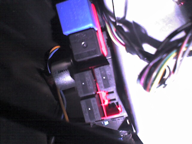

BUT, as you can kind of see, there isn't much anything around that. I did find on the other side of the bracket that held the GEM there was a "cube", but a Little bigger than you described. After taking the cover off I seen it actually housed 3 relays, so I'm guessing that is not it? Was it just one single relay?
This was the relay block I'm referring to (red socket with 3 black relays)... picture taken looking up from the floorboard under the steering column.

It's not the same as the block in your second photo. On mine, it was right behind the GEM. In your first photo, you'd have to remove the GEM and then you'd be looking right at it on the firewall. You'd think it would be in the same place on yours. Mines an auto, but I wouldn't expect that to matter.
___________________
jeebuzzin said:
I guess it isn't, there isn't anything behind the GEM but the metal bracket and the air duct you see in the picture. I went ahead and subscribed to that auto repair site and in the wiring diagram it lists having relays for the 4x4 system in Relay Box #1 to the right of the steering column. So I guess that block are those. I will post the part I'm referring to later, I don't have time right now. My bet is there are other ppl trying to figure this out too!

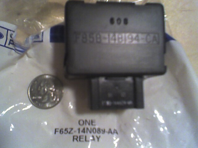

I am having the same problem. I bought the 'shift motor relay' from the ford dealer - part F65Z-14N089-AA on the package, part# F85B-14B194-CA on the part. (shift_control_relay.jpg)
I cannot for the life of me find where it goes. I also have nothing at all behind my GEM (control_module.jpg)

Do I not have the right part, or am I just not looking in the right spot?
Also, looking on the wiring diagram, i don't even see a relay. It looks like the 4wd control module directly powers the motor without a relay, which doesnt sound right to me, but i guess it could.
Sorry for the bad pics.
