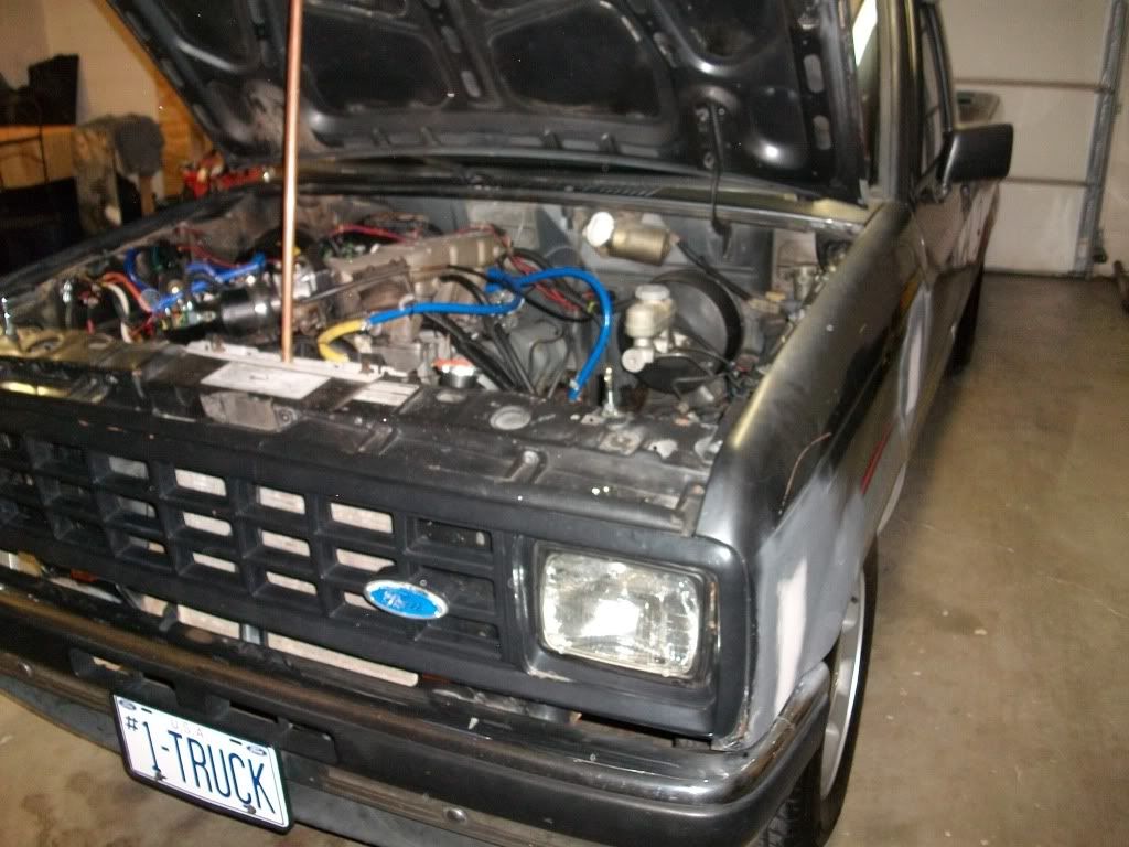

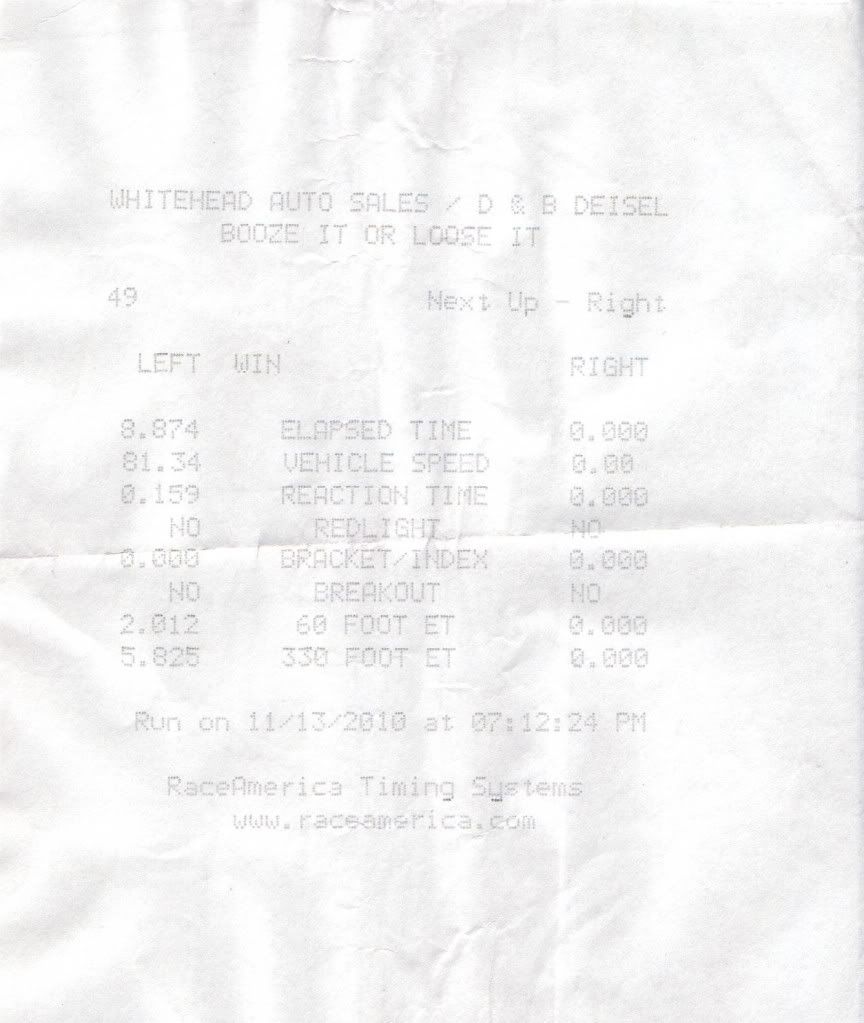

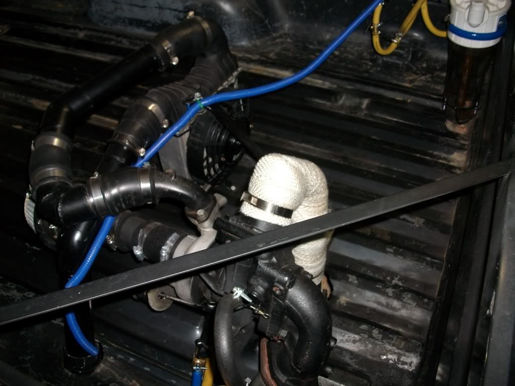

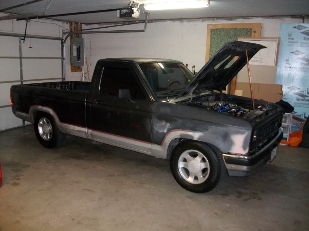

Wanted to share my latest project with everyone. Started on this at the first of the year and have modified all along to reach the goal of running in the 8's at the local 1\8th mile track.
First a little about the truck.
Stock high mileage 2.9 engine with what appears to be newer heads by the previous owner.
pace setter headers

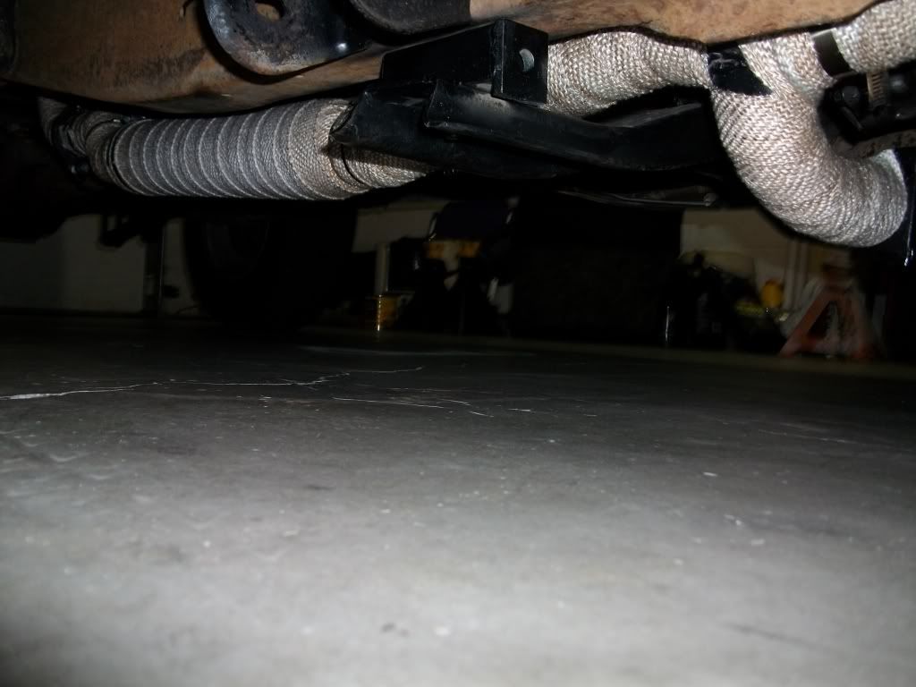

Full custom exhaust with header wrap to reduce turbo lag
Mustang 5.0 throttle body
19lb hr injectors
MSD High Flow fuel pump

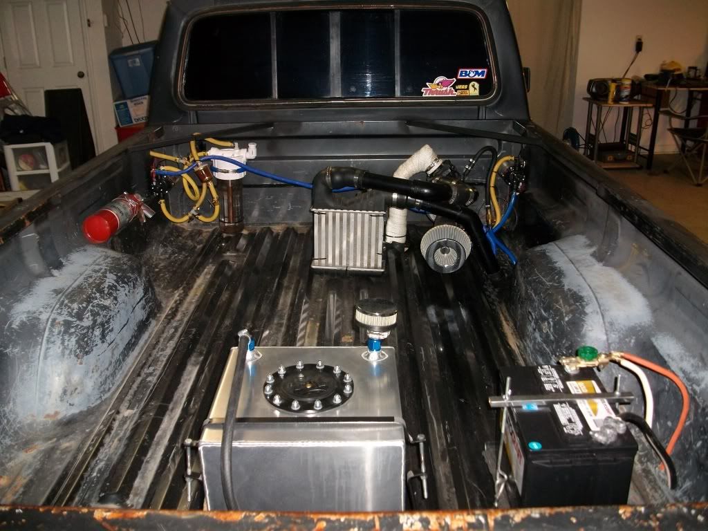

14b remote turbo from an eagle talon.
Saab inter cooler with mini radiator fan
16 psi boost
3 boost controlled cold start injectors.
alcohol water injection
remote mounted battery
5 gal aluminum fuel cell
A\C and power steering delete
heavy duty clutch
solid trans mount
solid mounted trans crossmember
4.10 gears
welded spiders in the 7.5 rear (turns just fine) :)

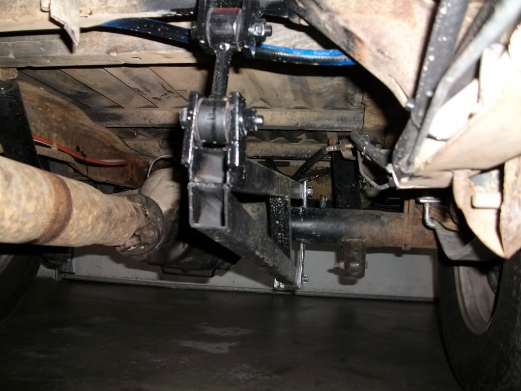

custom ladder bar suspension (no runs yet with this installed)
***was using slapper bars in the videos and the truck wasn't lowered yet***
street tires 235-75-15 back and 215-70-15 front.
It is a blast to drive.
Mods to come.....
Stud girdle and ARP bolts. ARP rod bolts. Ported intake and heads. Compound turbo setup for better top end boost. 20 psi. Vented bed cover to hide the mods. Slicks. Light weight racing seats. Mega Squirt controller. Fresh Paint :icon_thumby:
Hope to hit the 7's this year!
Note: This truck has surprised so many people who have lined up against it at the track and thought it would be an easy win against a little v6 only to come looking to see what in the heck is going on ...hehe
Here are some pics.....enjoy (I will try to get some video uploaded soon as well)
(I started with time slips of 10.8 with just 6 psi and one extra injector with no other mods)

hmmmmmm lol, just curious, about what do u have invested into this right now, i hadnt thought about remote mounting the turbo in the bed, that would actually be pimp for a wheeler, i was always worried about how to keep from sucking up mud lol
Since I was able to fabricate and weld most everything it has saved me a fortune.
In the mods listed probably about $1000 for everything.
I got a lot of the small parts for free from a friend (injectors, solenoid, other bits and pieces). The other things I had to buy I bargain shopped.
Counting the price of the truck and "all" things done up to this point about $2000
I wanted to go fast on a budget! plus I love this body style Ranger

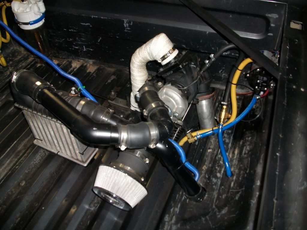

I always enjoy seeing these kinds of your builds. Most people are surprised at the cheap power you can make with forced induction with some know how. I assume you will be getting a wideband to check afr if you haven't already. Are you able to use just gravity feed for the oil return? Anyway, good job!
Cool stuff, I built a remote turbo setup on my Dakota using Megasquirt for fuel, it's a lot of fun! That is a tiny turbo!
No, he has a pump. You can't gravity drain without a nice straight downhill shot to the oil pan, any back pressure on the oil drain and you will send oil out past the seals and into the intake/exhaust.
extremely jealous . i thought about doing just the same setup as you. in the same place none the less! but stopped short due to the desire for better suspension..

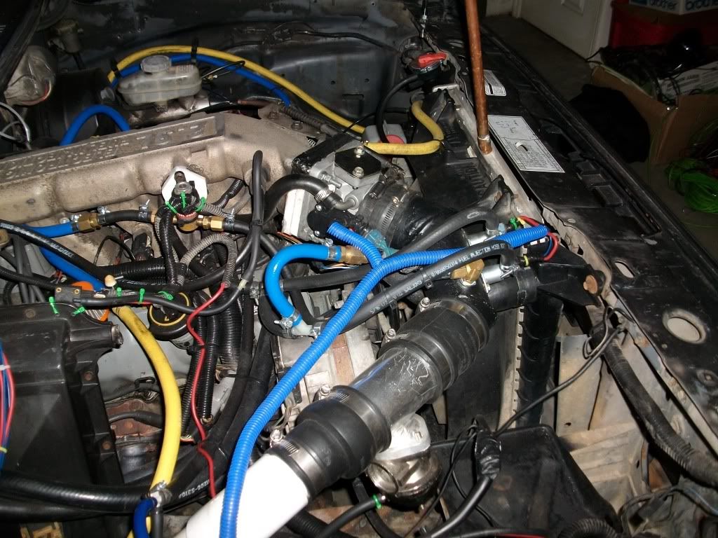

looks pretty good. i bet you can get a significant HP gain from making less extreme bends on the intercooler piping. the one to the TB looks like it could use some reworking
how does it hook up on those tires?
Wow, do you have any vids from the track? Do you know what kind of HP you've got?
I have a wide band but it is installed on another turbo project right now.:D
I have tuned this one so far the old fashioned way believe it or not.... By ear, spark plugs and seat of the pants.
Replacement 2.9's are dirt cheap to acquire so if this one melts down its no big deal. Part of the fun is taking chances and experimenting.
With my projects over the years I have had a lot of people say, this or that wont work. But when it comes down to it they've probably never tried it for themselves. But not always so I like to get everyones feedback.
I am using shur flo pumps for the oil return and the alcohol injection. It just pumps it back into the dipstick tube actually. I just take off the hose clamp and pull the hose when I want to check the oil level.

at 3 k wt and 8.80s i would think 215 whp.
Oops, I didn't see the oil pump at first. Been thinking about using a Holset vgt as a rear mount and a Shurflo pump for the oil return but wasn't sure about the heat. Smart move on the alky system. No doubt it gives you a fair amount of protection against detonation. I was able to run 30 psi Holset boost on a 2.3 Mustang versus 23 psi without it.
