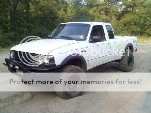

This is my 98 3.0 auto 4x4 w/ 4.10s IFS35 up front 8.8 LS w/ disc in rear 33x12.5 on 15x10 3" BL 2"Tcrank

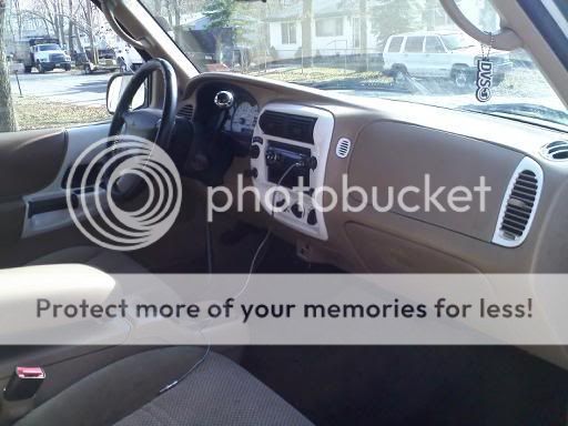

INTERIOR

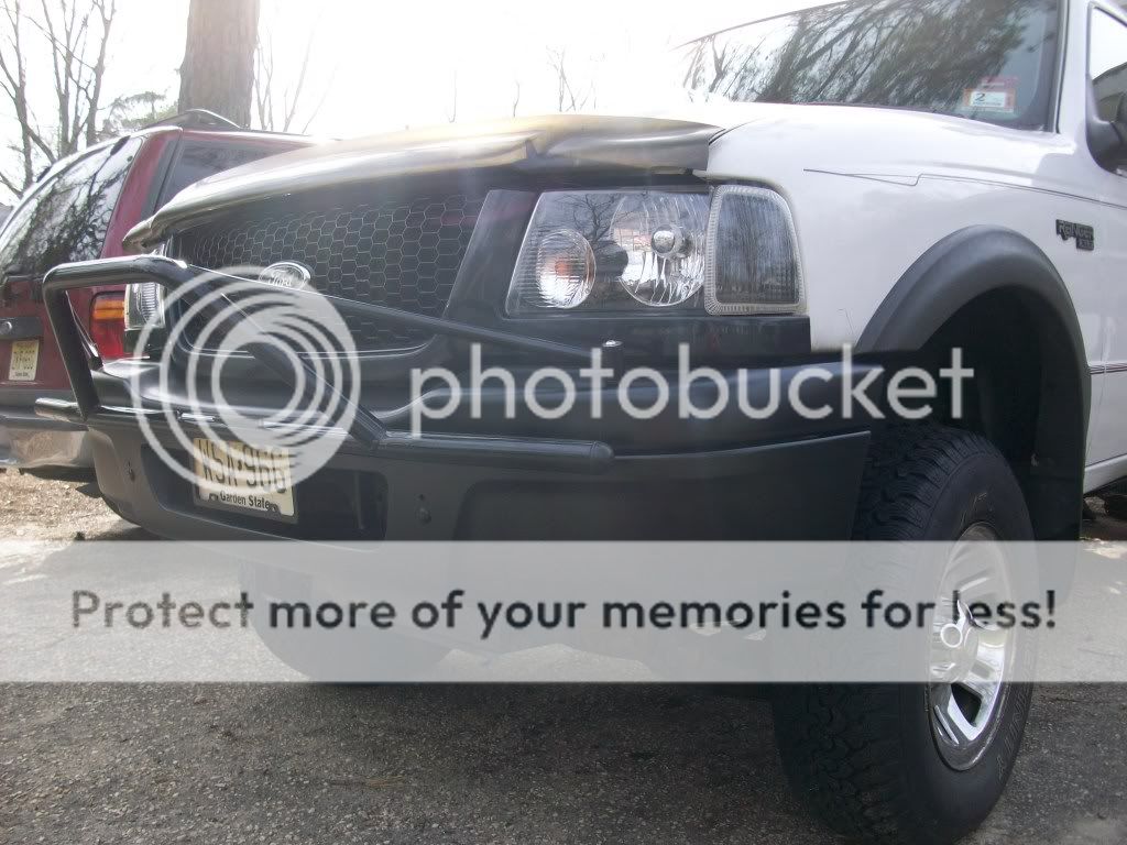

EXTERIOR

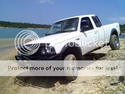

ACTION SHOTS

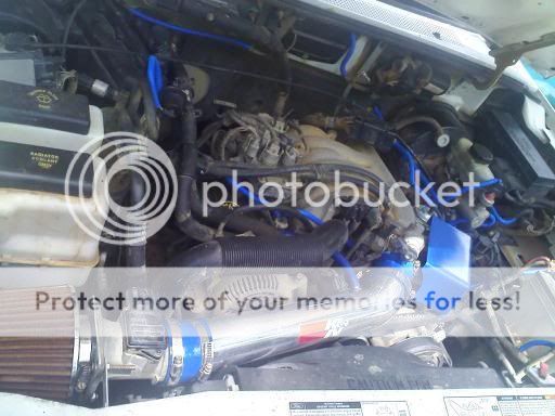

Looks nice, but you took off your factory cold air in take,and put on a hot air intake.
Robert
Jees...intake? Way to start a controversy in a thread about an awesome truck! Looks great man. Ignore the haters.
I'm not hatting on it, I typed Nice truck, but I see alot of people all the time say they have a cold air intake, when they put on a K&N filter, BUT they don't put the shroud box around the filter, and what it does is suck HOT air from around the engine.
I have a Friend in Bain Berry, that put one on his little hot hatch and wanted me to see it, I told him that was a nice piece but it's now a Hot air intake, it was also placed right above the exhaust manifold.
