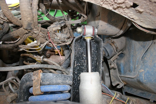

Here is a pic of the correct f-250 shock mounts installed (on an explorer). Notice its a bar mount on top and bottom. There is a "post mount" f-250 shock mount which you don't want. IIRC, that from older f-250s.
shock-mount 002 by maniak_az, on Flickr

so just grind off the rivets on the stock and cut it off the spring bucket?

...and weld the shock mount to the coil bucket, but yes there isnt much to it.
Different angle pic here. This is how I bought them. I didnt have to weld them myself.
New lift parts by maniak_az, on Flickr
