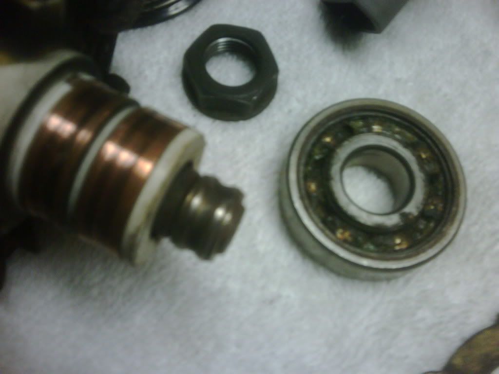

Good write-up and photos! Let's see how to change those pesky bearings ???
Thank you. I have never had to change the bearings before. I certainly will when/if the time comes.
As of right now there have been 84 "views" of the page. No suggestions yet?
I never managed to get the inner race of the small bearing off the shaft. You need a puller, maybe a slide hammer. The big bearing is cake. You can pry the dust cap and regrease them, just like idler/tensioner 6203 bearings.
How to change the voltage regulator and/or brushes in your alternator
Thank you RangerSVO, I appreciate the compliment!
Hey Earl43P, thanks for the pics on the bearings. I have a 6G alternator I want to dig into. I replaced one on my neighbors Taurus the other day, so I have her old one. It has bad diodes in it. I started looking into it and it has a sealed bearing on the back that resides in a plastic sleeve. I tried to get it off of there, but I think it's going to require me fashioning some kind of a puller to get it out. Ever tried working on a 6G? When I watched a buddy of mine do a field coil in a 3G, the back popped right off.
