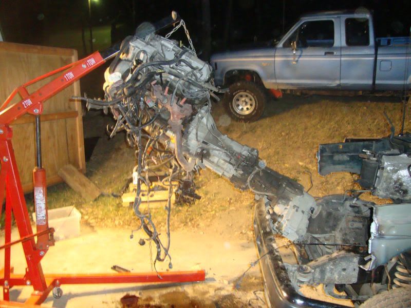

88 ranger 2.9 4.0 swap with pics
pulling the 4.0 and transmission

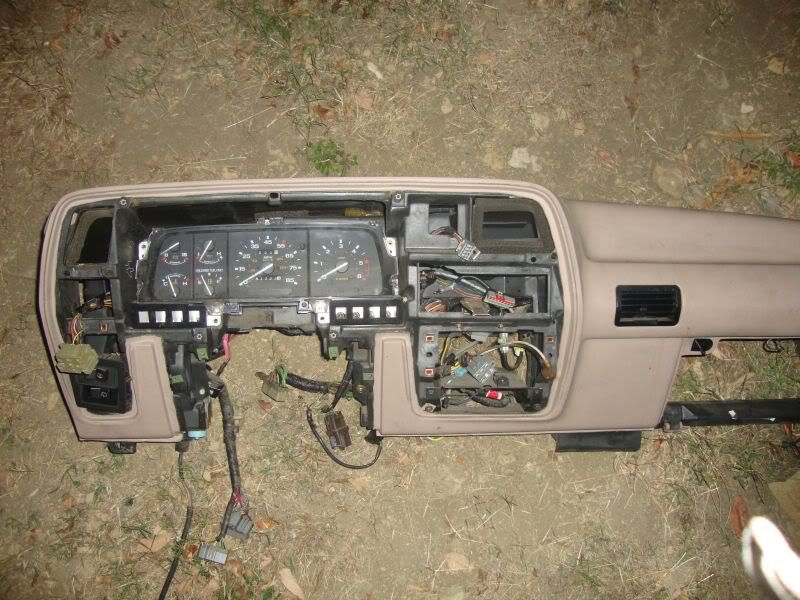

the dash out of the explorer that im gonna be using

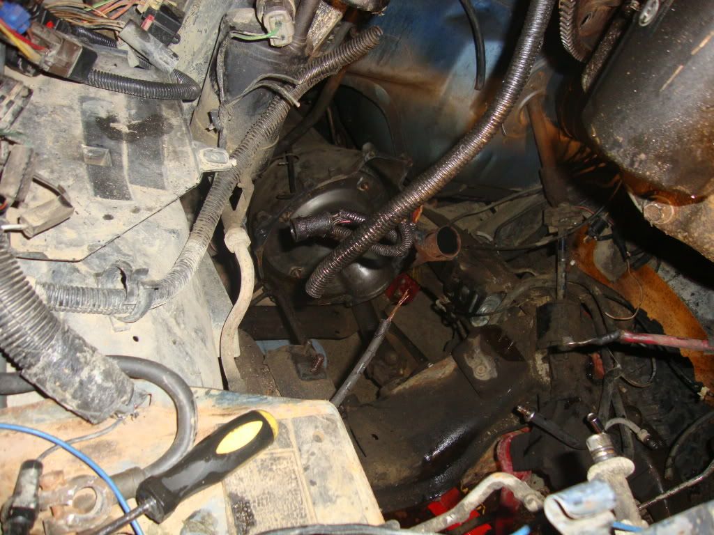

pulling the 2.9

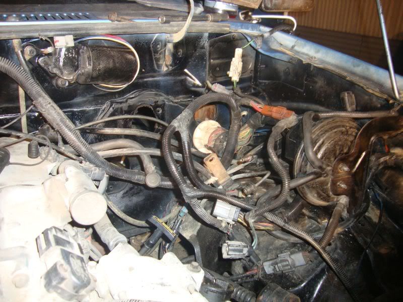

some wiring

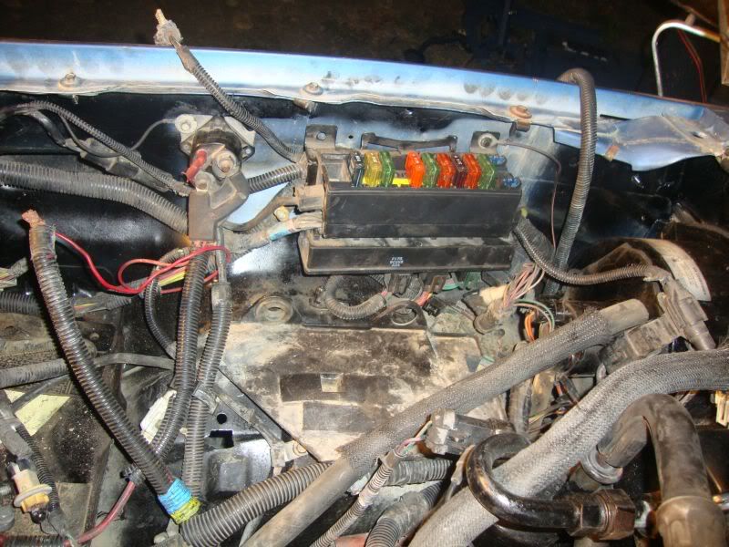

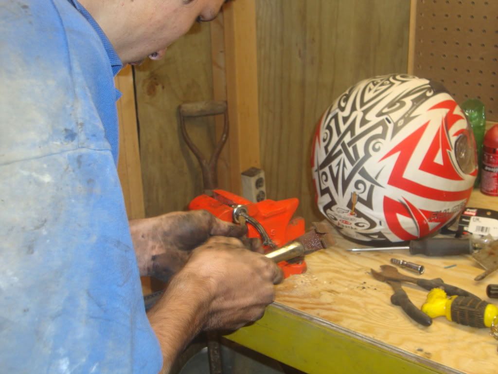

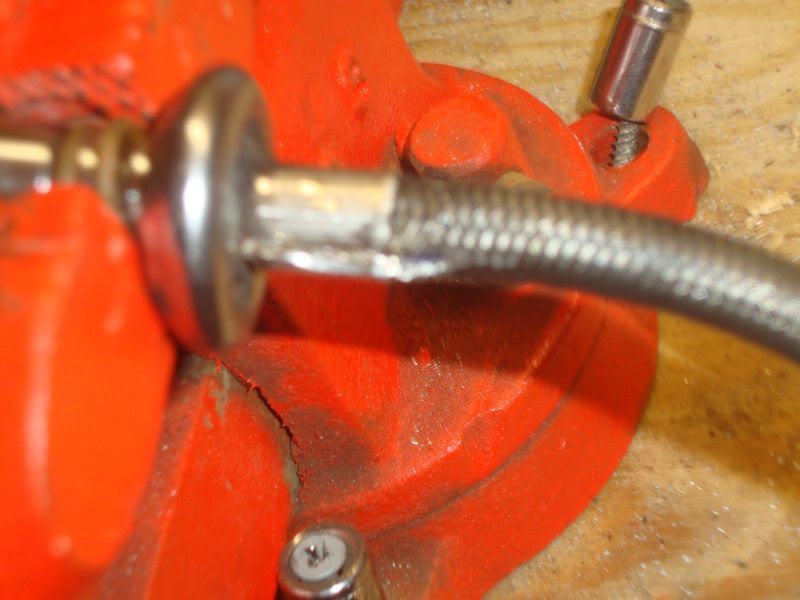

as for the fuel lines i read somewere on here about heating the line, well what i did was cut the lines on the frame right behind the quick release then did the same on the explorer that had braided lines cut the braid off and pulled the quick release end off bearley heated the line with a hand held tourch and pressed the new clamp in the put a hose clamp on it was well. so far it doesnt leak and the truck has been running so ill hope for the best on how it holds up

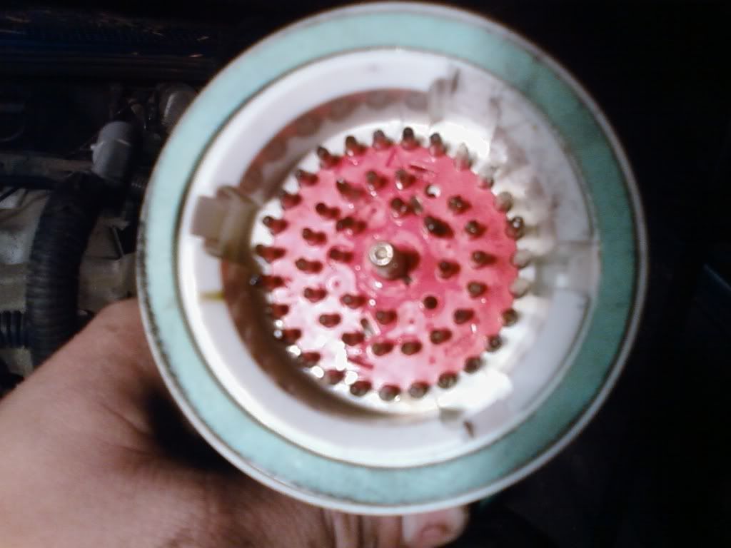

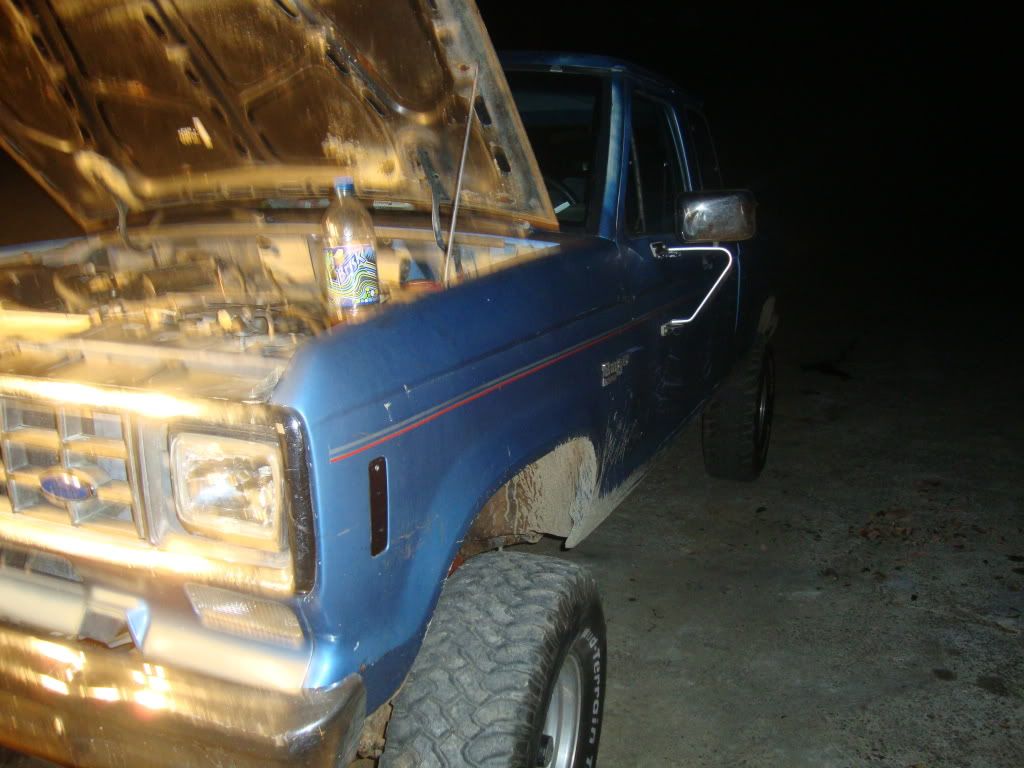

the truck will run as of right now, still have a lot of wiring left to do, pretty much everything on the inside needs to be wired, but having some problems with the transmission, it will sift to 2nd but not to 3rd or 4th, i have 1,2,N,R,P but thats it, im thinking its where the computer is from a 5 sdeep truck so im gonna need a auto transmission harnees and a auto computer, anyone else agree?
