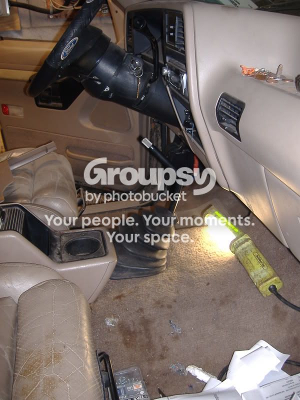

Excuse the mess in there I need to get my wires looking nice yet; I just moved the MSD from the engine bay to the inside. Here are some pics.
Here's 1st gear
Reverse
1st gear top view
Why you need a body lift
Matt

Thanks for the pics. So, does anyone know if on a 95 are the firewall to stock shifter dimensions the same as an 88? Body lift makes sense. I'm putting one on currently. But why not help by cutting that massive semi-triangular tab off?

I would believe those measurements are about the same. Maybe a little less room because that dash is bigger. The big tab on the trans isn't the only part that hits just the one that I can snap a picture of. The bellhousing is massive and the top of the transmission is massive.
