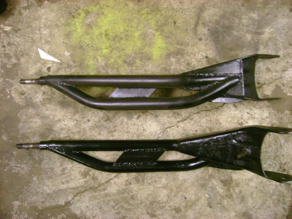

radius arm w/o tire. free tube, so i don't know exactly what it is. no seam though, so i think that means dom or hrew... the trial will decide when i rebuild em with proper dom. just tack welded now, still have lots of beefing-up to do

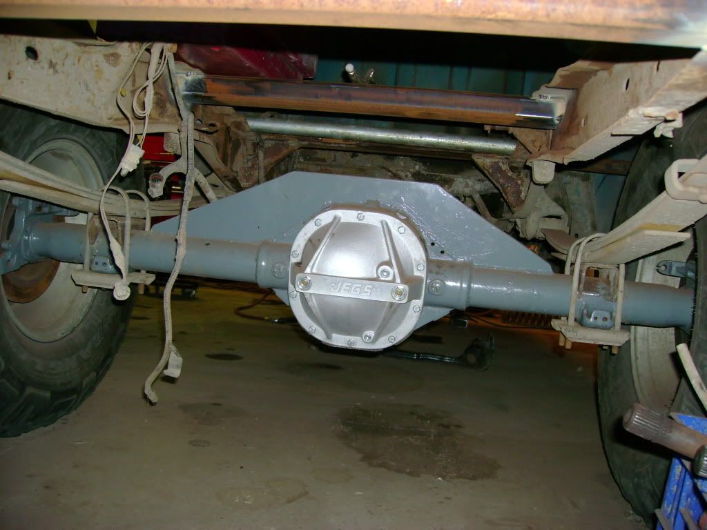

rear axle so far: 31 spline 8.8. installed 4.56's and welded diff. 1/2" plate truss should be completely unnecessary and looks ridiculous, but whatevs... will be doin the ol 63" chevy leaf swap w/ flipped shackles soon. 15" travel 9000xl's are in the mail.
My 94's: prerunner poser dd & long travel trial rig build
I like where your going with this but I hope that your axle u-bolts are temporary; for measuring/locating purposes only. I see it's not connected otherwise. :icon_cheers:
Richard
Oh yeah, mock-up purposes only! im not setting pinion angle, shock location, or doin much else till i sort out the leaf swap.
hey, know of any cheap wreckers in edmonton? I called on place and they wanted $200 a side!!
I'm in fort mcmurray and there's nowhere up here that'll re-arch springs, so i figured i'd make a trip and get the springs and have em re-arched in one weekend.
For cheap springs you're probably better off buying a cheap truck and parting out what you don't want. You could buy new springs cheaper, I've priced them.
Here's a link to someone doing reverse spring eyes on a model A or T. Looks like a slick way of re-arching springs:
http://www.jalopyjournal.com/forum/showthread.php?t=90824
Richard

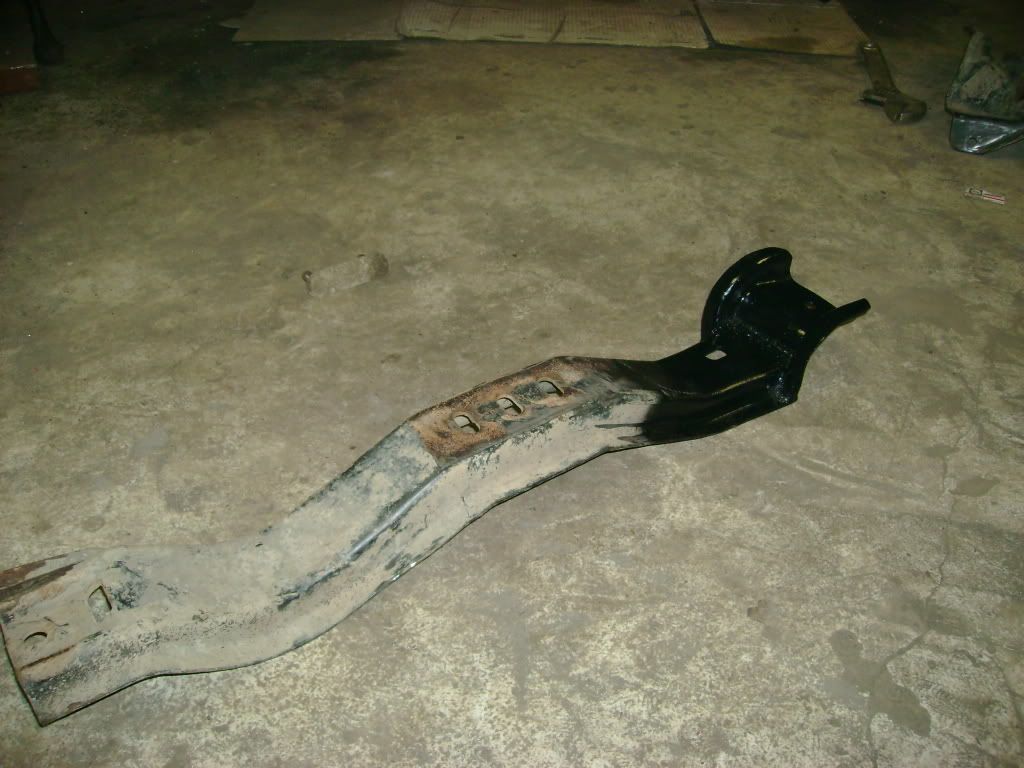

Tack welded for mock up- added 1" to drivers side, 1 1/8" to pass side beam. have lots of gusseting and plating to do

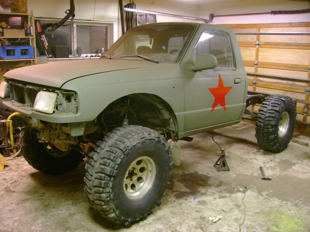

6" SJ ranger coils, 12" stroke rancho 9000's, f250 towers, dropped pitman arm
the Commiedeathwagon!

was able to cut up and use the stock trans x-member to work with new radius arm mounts.

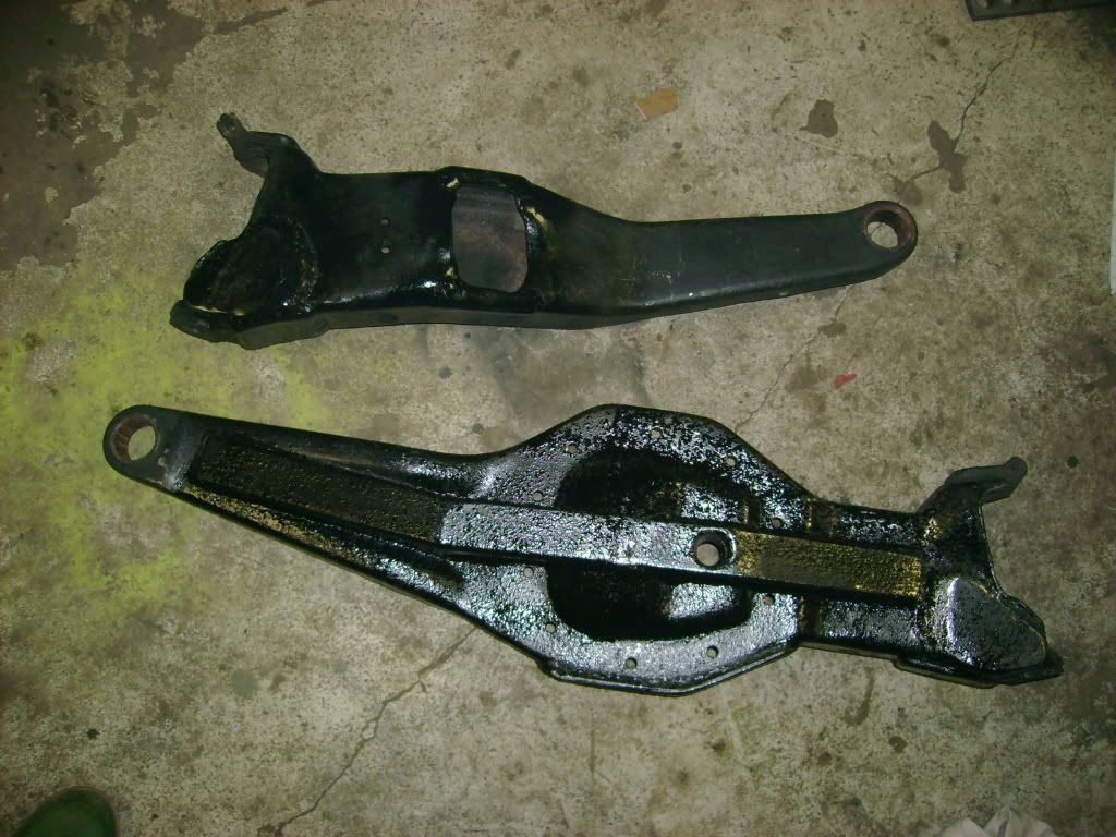

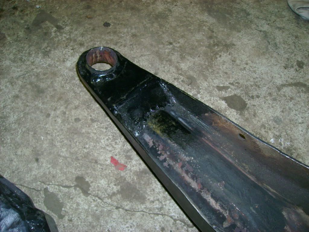

Radius arms finally welded up, boxed and gusseted

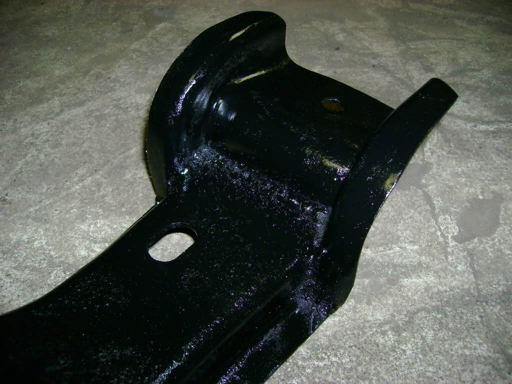

Axle tubes welded, boxed, gusseted. Still got some more cleaning up to do before everything gets painted a camburg-ish grey. I think my fab work looks alot better in a welding-smoke-hazed garage than it does in pictures... must have something to do with the burning gear oil fumes.

you might want to do some clearing on the axle window on the passenger beam while its off the truck
nice build! i hope one day i can build a prerunner!
It looks like he Already did, maybe not though:icon_confused:
anywhos, its lookin good man! keep up the good work.
Yeah I opened it up about 1/2 to 3/4" on the top and bottom before i burned on the top and bottom bits. I plan on cleaning the inside welds and open it up more as soon as I get a new die-grinder.

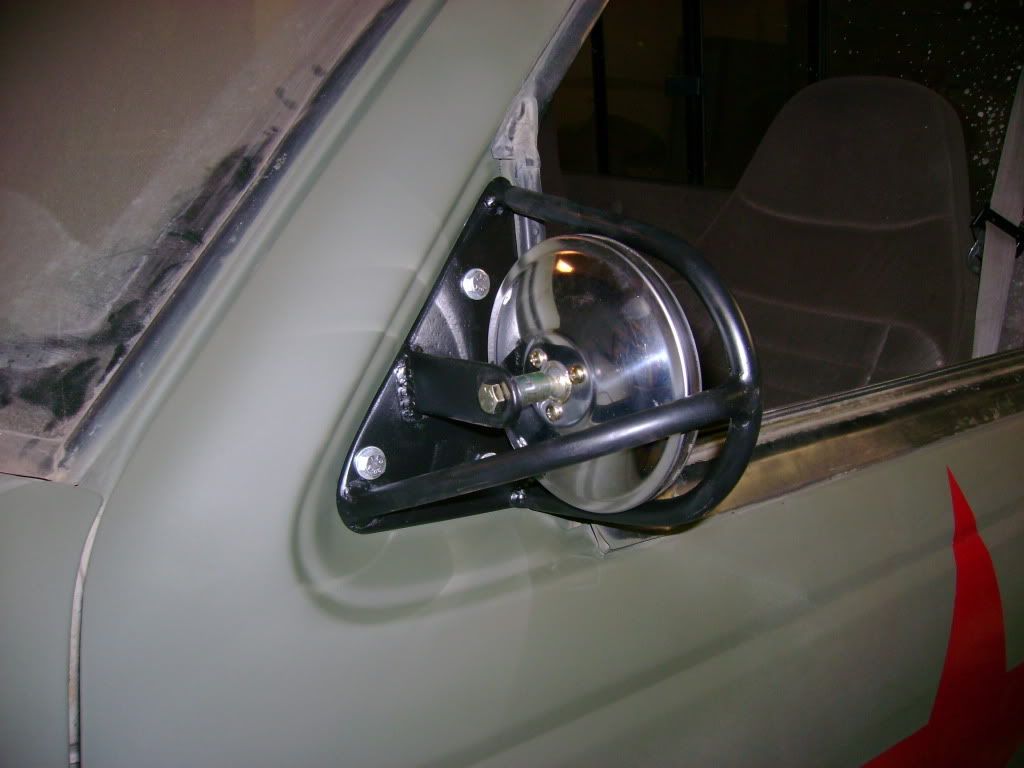

Waiting for 4.56's, and a bunch of front end junk to show up, new ball joints, spindle bearings etc... before I can do a final assembly on the front end, so I decided to make some tree-smashing mirrors!
Kinda lame, but it sucks rippin em off on the trail an gettin hassled for it on the road. Got a feelin all the rookie cops in town are gonna be pullin me over for fun as it is...
5" (seem closer to 4.5") swiveling convex mirrors from napa, some 3/16 plate and some 1/2" solid roundstock is all it took to make mirrors that should pull out the doors before breaking
Seen these done a bunch of diff ways on prerunners/race trucks. They could be cleaner and more trick, but then so could everything i burn together!
