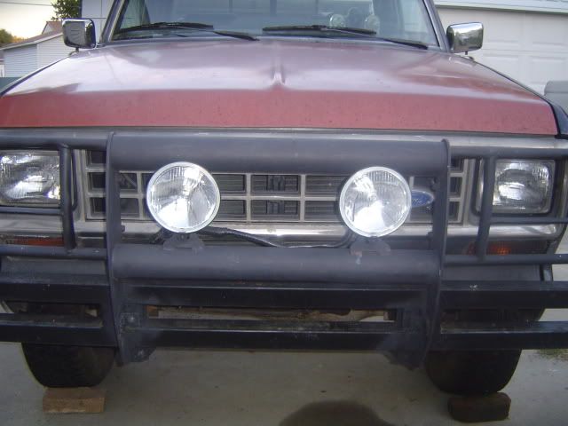

Added fog lights

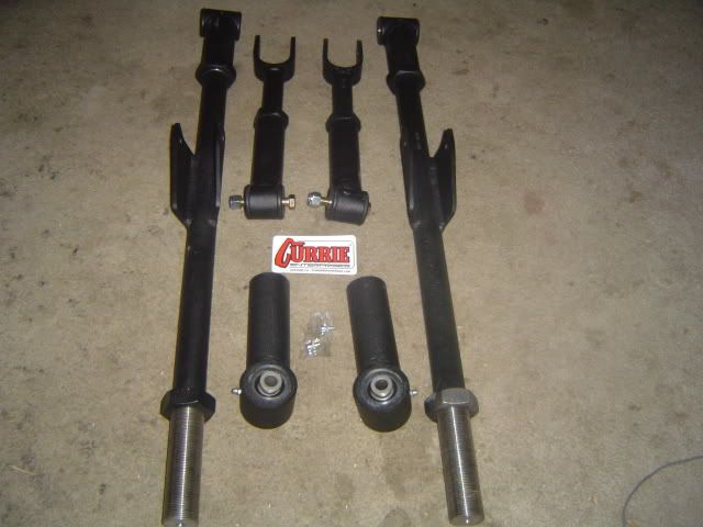

Bought long arms for my D30 SAS

Was going to use the 4 link set up on my D30 but after thinking about it, decided the long arm set up was the way to go. All I need to put my D30 under my truck is some .250 think angle iron that I can weld my long arm links to so that I can bolt it to my frame. Hopefully in the next few days my rear end lift will be done then its off to do my front.

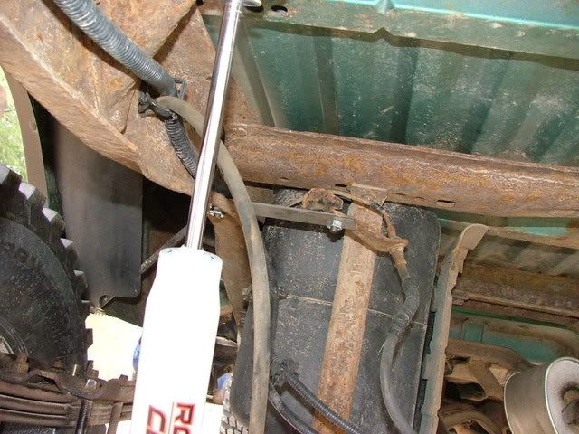

Escort if you can snap a few pics of your rear brake line, anything to save some money.

this is what I did with mine, granted it was a 93, but I think the brake lines are the same.
dangerranger1983 build
I just added a plate to the frame and moved the orginal out to give the brake line more room to move. I got somewhere around 4" to 5" of lift with my 63" swap (3 leaf pack and overload) and a extended shackle

I will post some pics of my rear brake line and shocks tomorrow as its gettin late tonight. i mounted the rear line in the center of the truck and welded it to the crossmember so that the long portion is pointing straight down. make sure your suspension is at full droop as im not sure if the line length is the same. as for shock mounts i cut off the factory mounts and welded them to the top of the axle. i was plannin on buying longer shocks but after cycling the suspension i realized that they were going to be long enough to my surprise.
Thanks for the picture, looks simple enough that ill just do that
