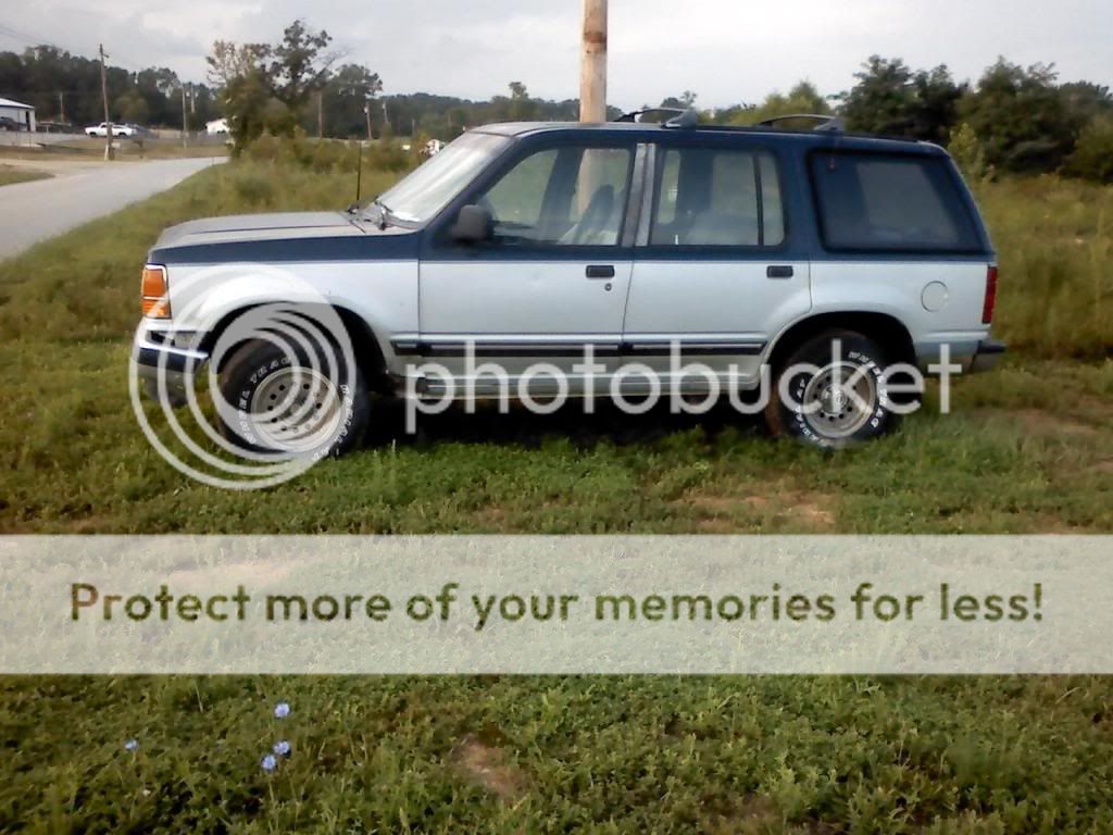

I've had my Explorer one year now and what a transformation!! I started with a bone stock 1991 Explorer that I bought off of Craigslist for $400. It ran and drove the almost 1.5hrs home the night I bought it.
This is it in the yard where I bought it.

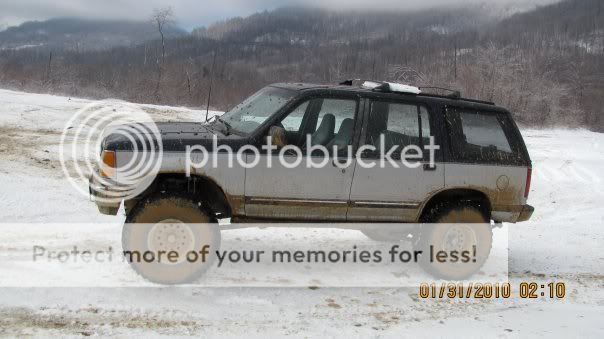

I went wheeling in the Ex first. Took it to Harlan, KY last year for a Bronco event and followed the guys from Duff. All stock w/ no lift, 32" BFG A/Ts on stock Jeep wheels.

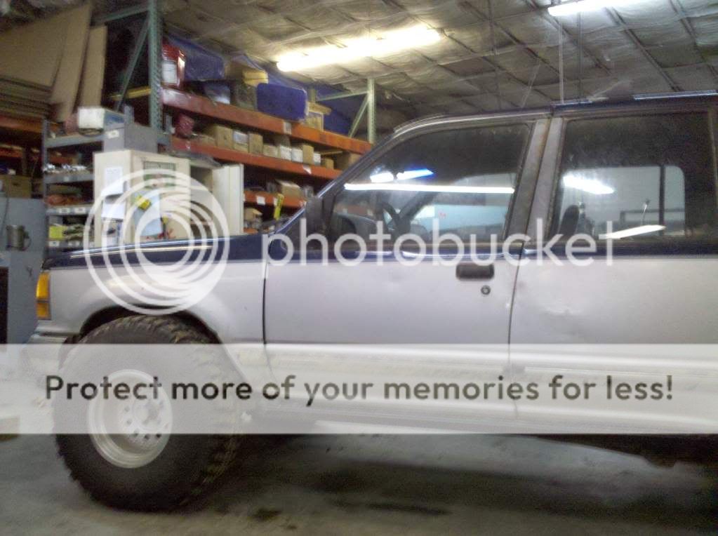

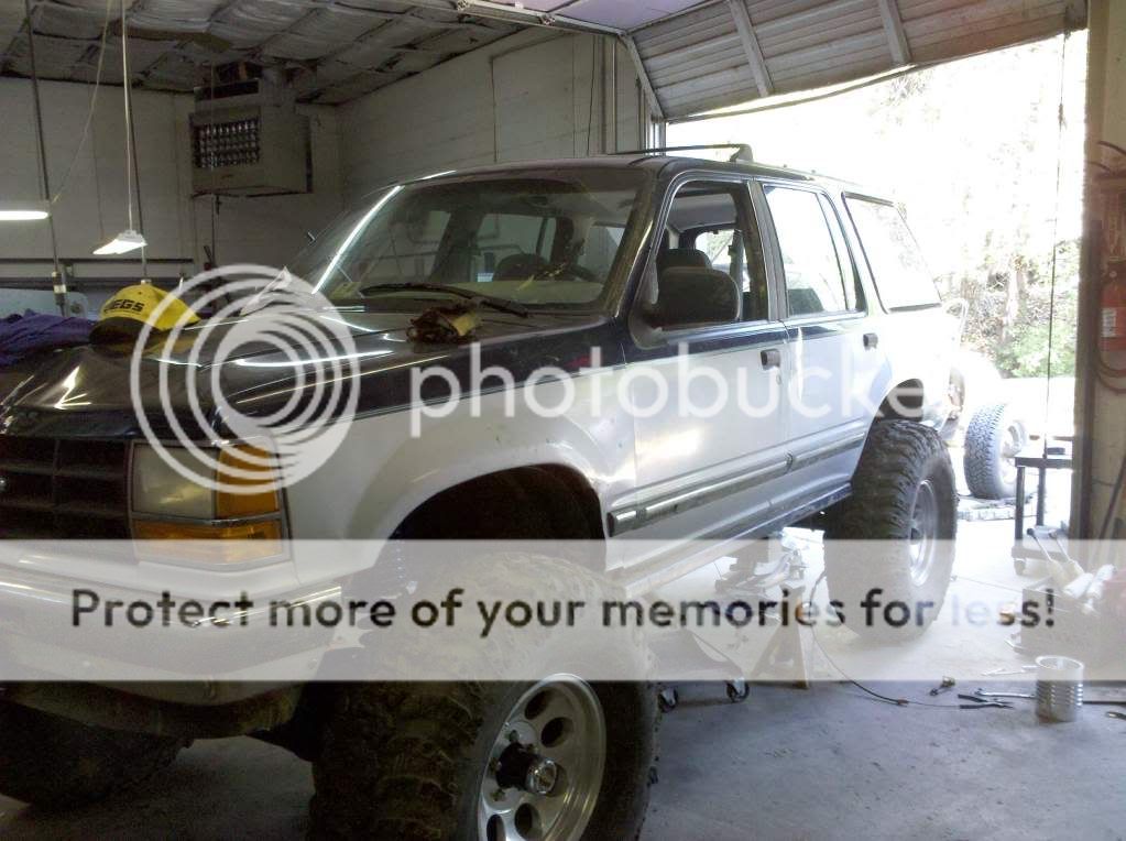

Then we had some planning issues and I didn't get to work on the Ex for a bit. I continued trading around and got a set of 35s that I wanted to run when I done the 6" TTB lift. Only problem was I traded the tires I had so I had to put the 35s on with no lift.

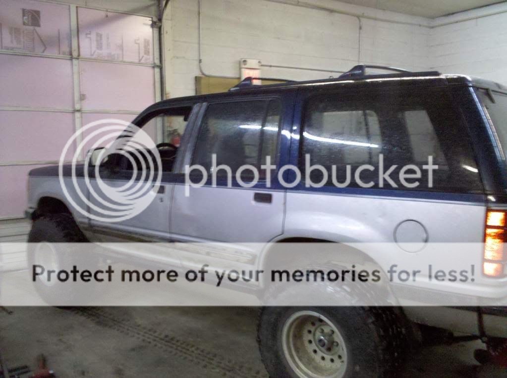

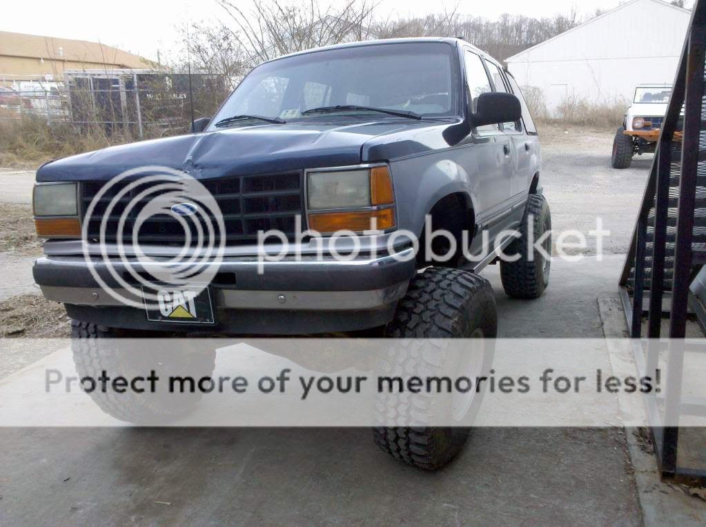

Had to drive it to the Duff shop like that. Easy on the bumps.

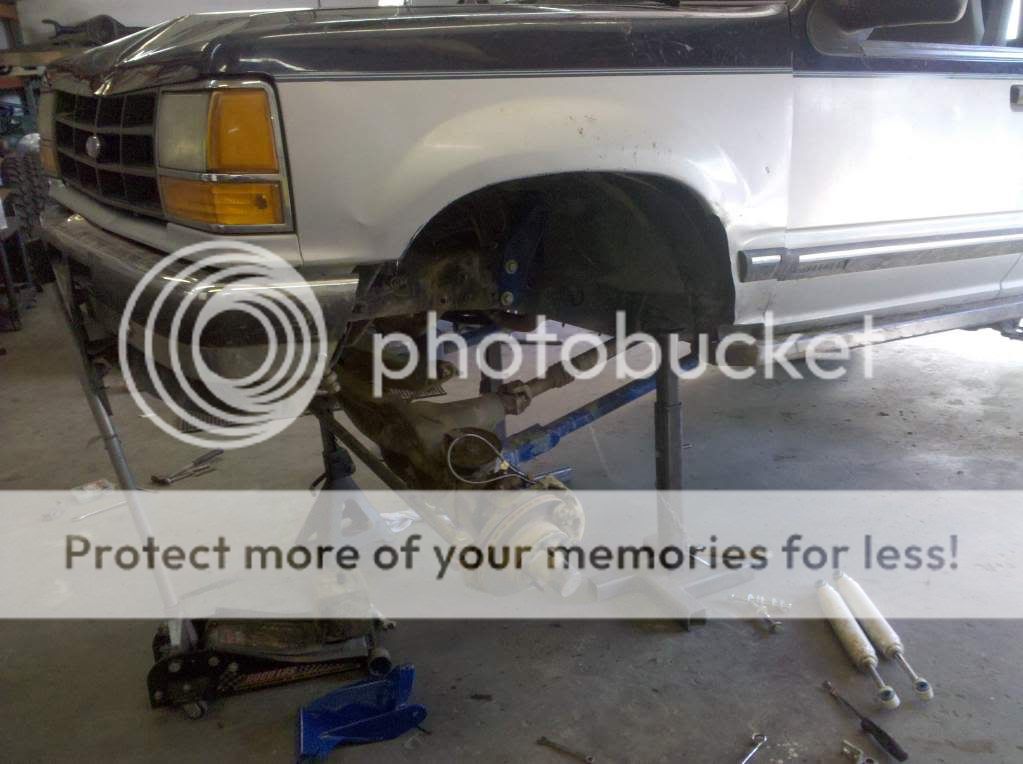

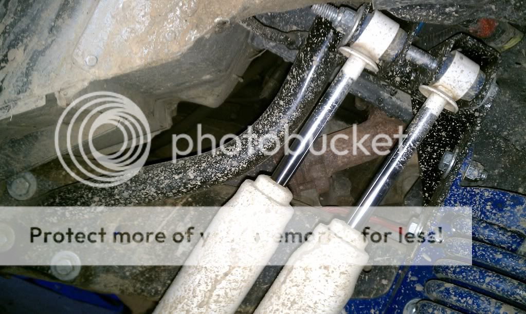

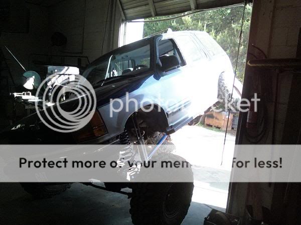

We then started on the first complete Explorer lift that they had done. It was the standard 6" lift you can buy from them with the exception of the new coil buckets and a new rear spring pack.
It took 2 days to put the lift on as there were only 2 of us working on it after hours.

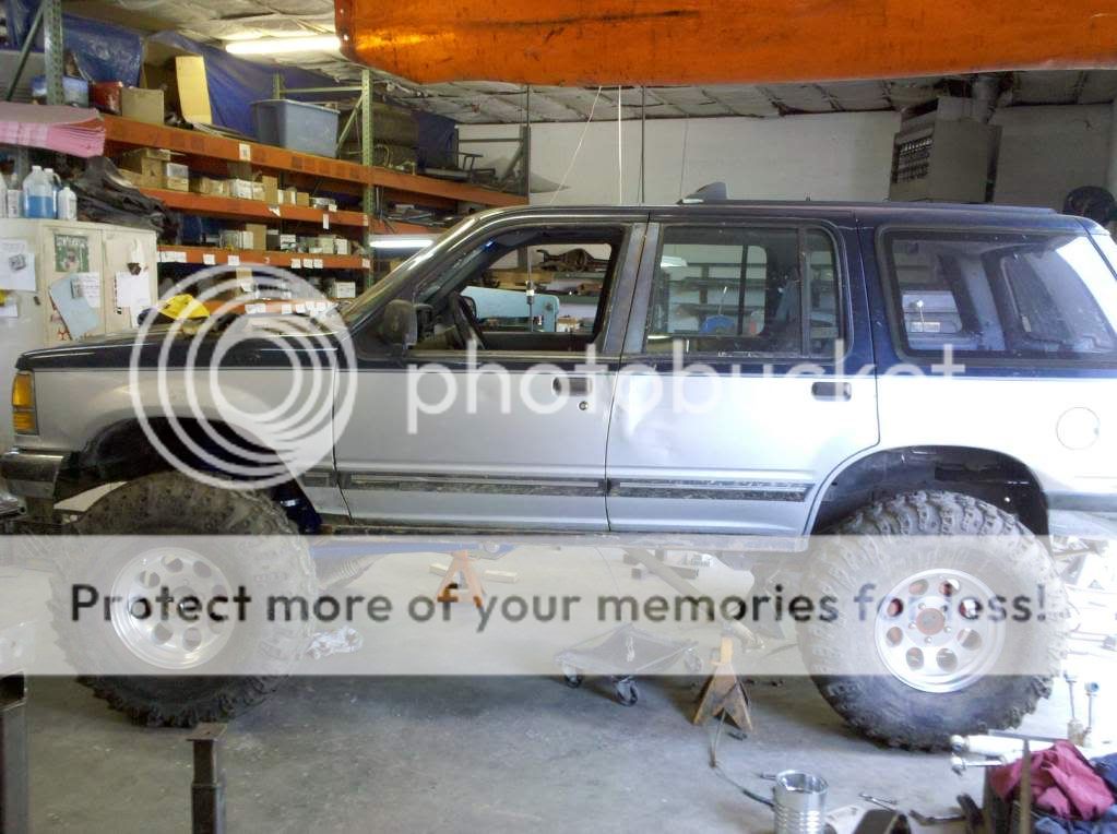

When it was done, I was soooooo ready to drive it! It had a certain look to it that I really liked.
I was very impressed in the ride and drive of the big boat. It blew me away how the springs soaked up every bump in the road. I had been a Jeep Cherokee owner before and had a Rusty's lift kit on it that road like a log wagon compared to the Duff kit.

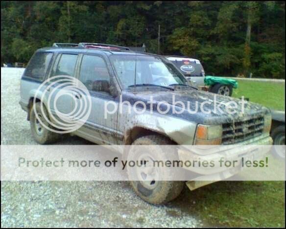

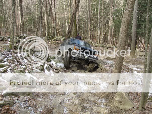

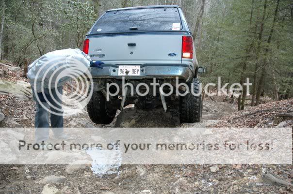

I had to wheel the thing so I went out to Windrock with Jimmy from TRS.

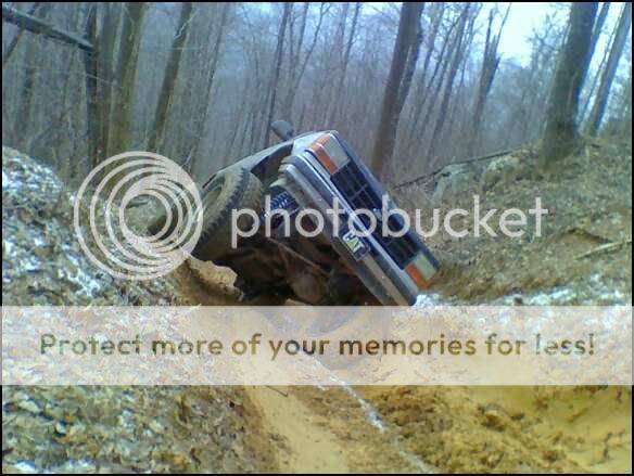

Trip didn't end so well. I blew both auto hubs.
Tore them apart and welded them to make them full-on drive flanges. Also welded up rear 8.8 at same time.

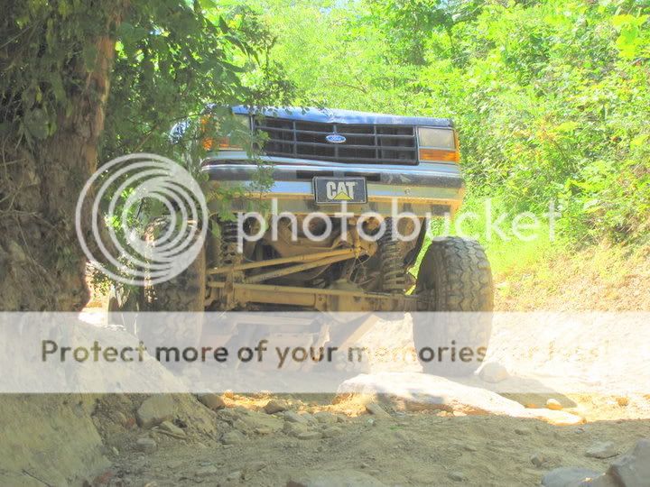

Wheeled a couple more trips but didn't think the flex was quite where I'd like.....

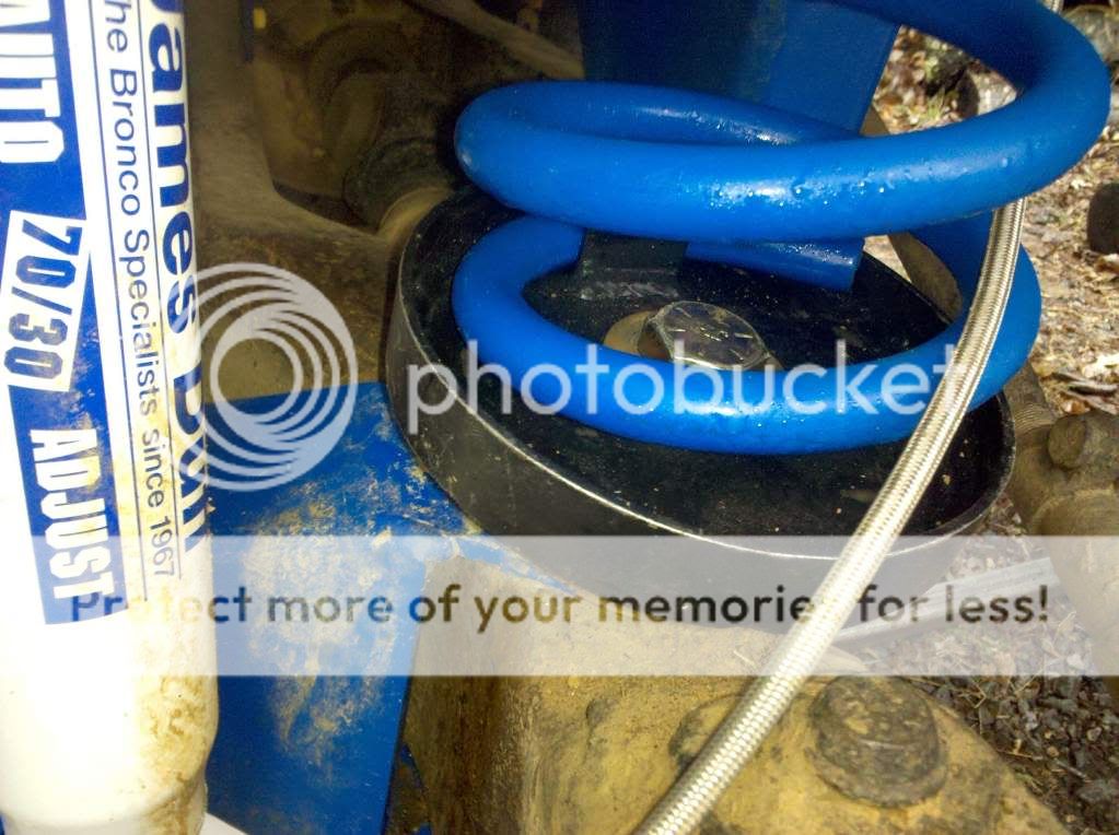

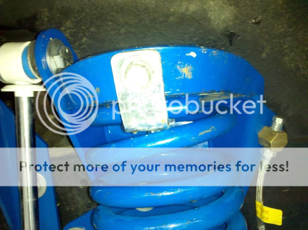

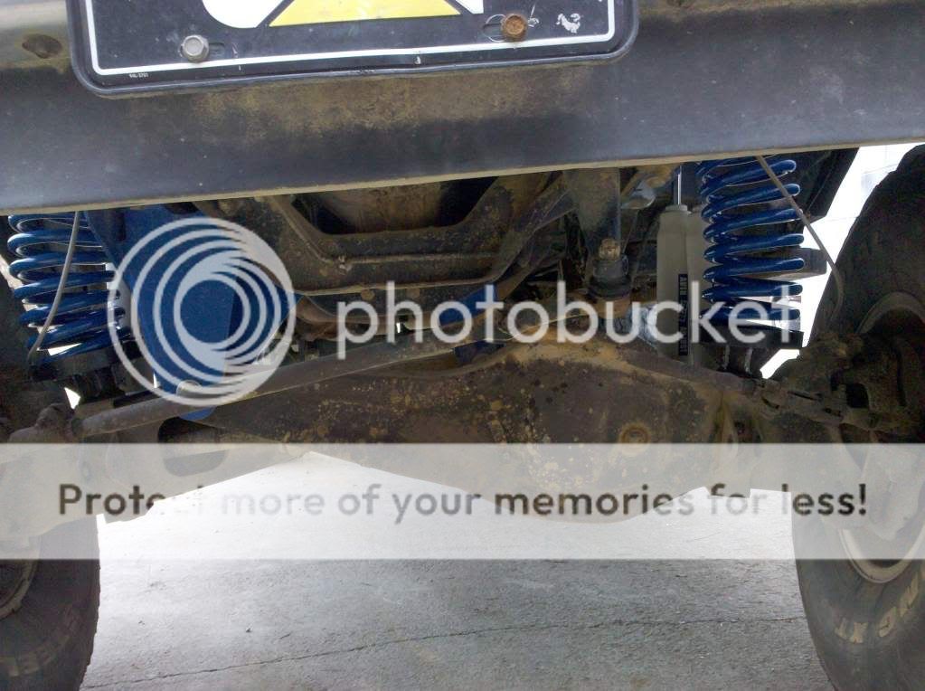

......so since I had the new coil buckets that would take either RBV coils or the much softer EB coils, I swapped coils.

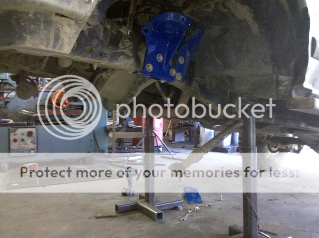

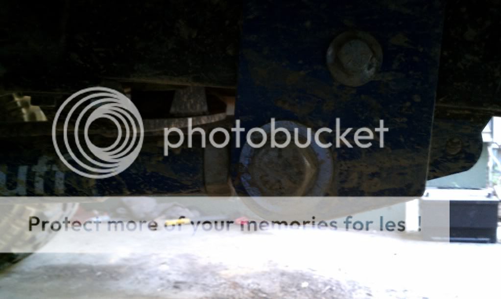

Made these lower coil retainers to bolt on to the TTB.
Then it was out with the RBV coil
Twist the new EB coil in
And bolt it up
I used the 3.5" lift EB coils which matched up almost perfectly with the 6" lift I was running.
It was at that point where I ran into a major problem.
The softer EB coils were letting the suspension jack up because of the infamous TTB steering. The 6" RBV coils were around the 475 lbs/in rating whereas the 3.5" EB coils were only rated at 225 lbs/ in. I literally had to drive with ratchet straps holding the front end down.
I took it wheeling a few more times.

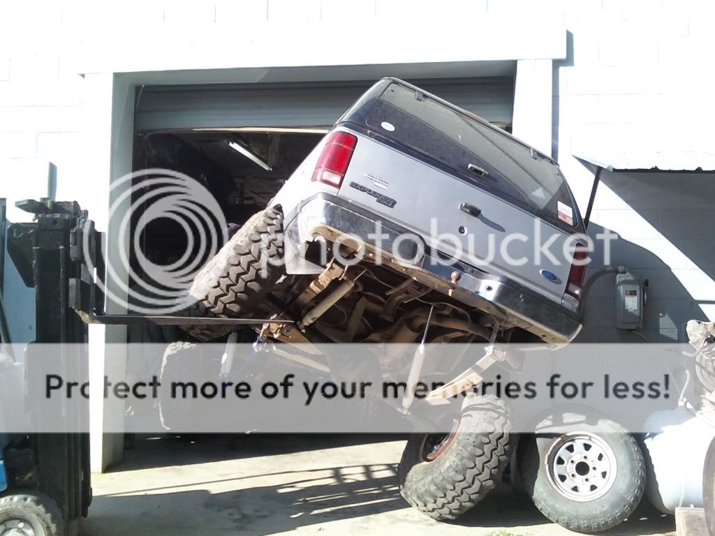

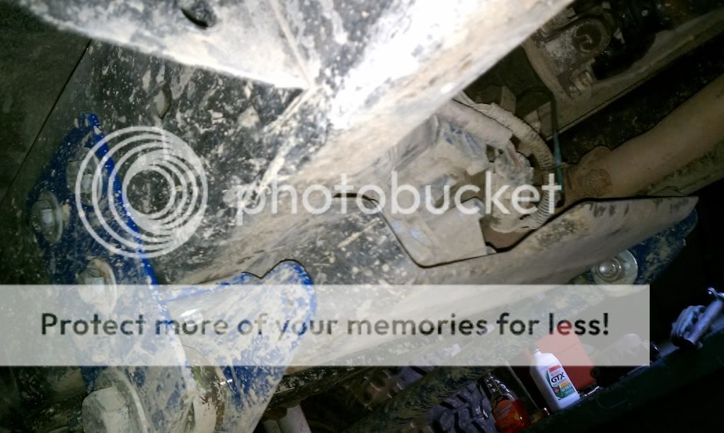

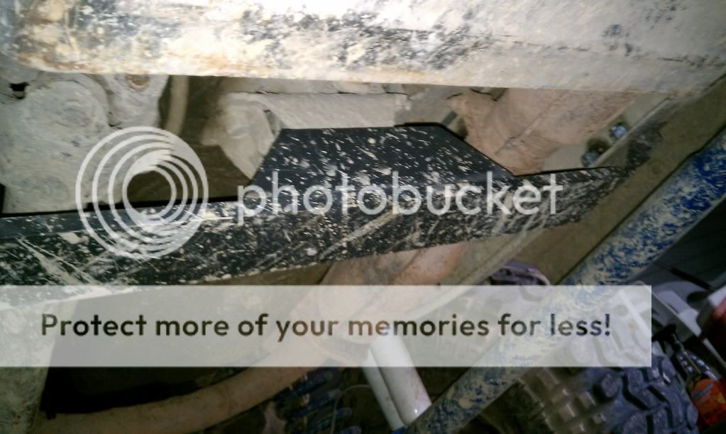

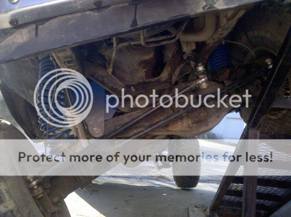

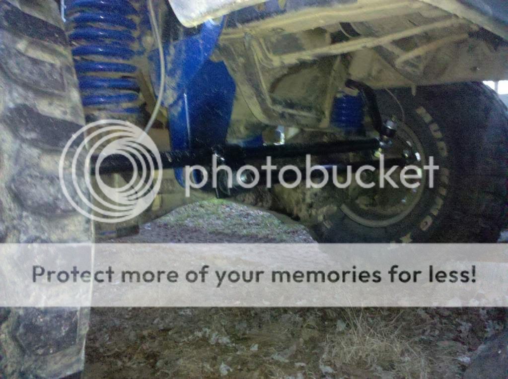

I didn't know what to do so I turned to TRS to find out. After a lengthly discussion, 4x4Junkie finally steered me in the right direction. I met up with Anthony who owns StoneCrusher Steering and we got to talking about the TTB setup. I gave him links that were provided to me by 4x4Junkie and we discussed the different steering setups that were offered. After a few weeks of bouncing ideas off each other, Anthony came up with the simplest solution. By putting both the pivot points of the steering right were the pivot points for the beams are the steering stays in phase and doesn't jack up on you.
This was the prototype version that we installed at his house.

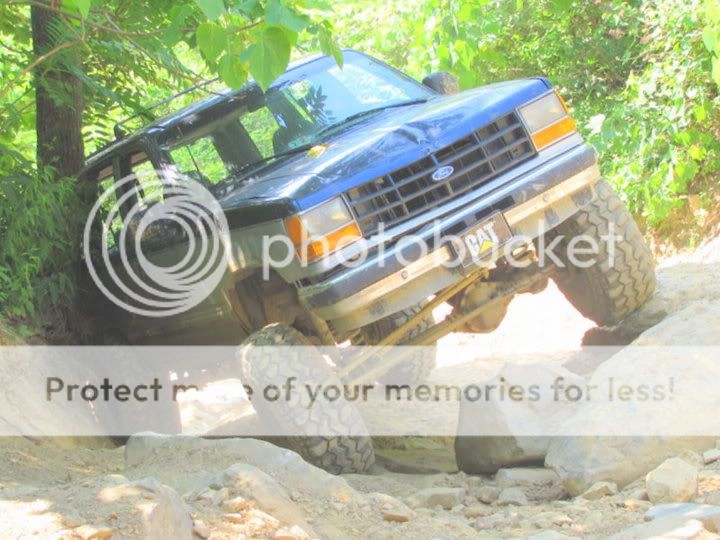

It was at that point the Ex really came alive. It rode and drove great, flexed like all get out, and no funky steering problems.

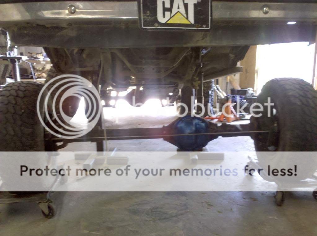

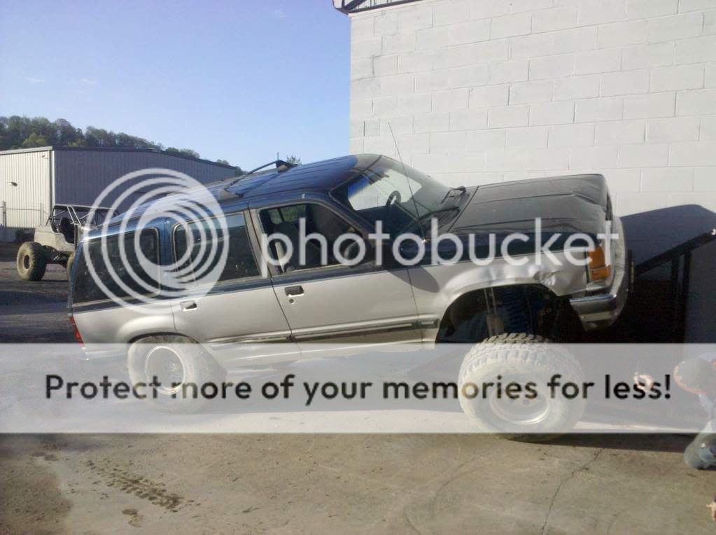

Bye, bye TTB---Hello bolt-on SAS
Few parting shots
Out with the old
In with the new

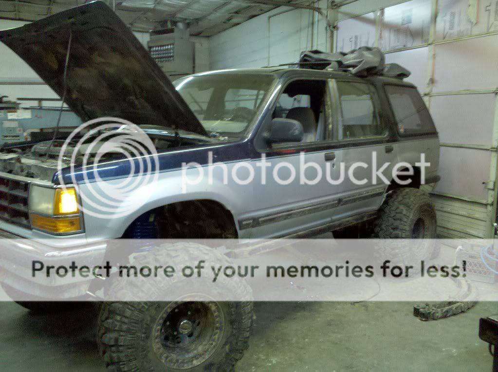

Just in case you've never seen an Explorer on a set of 39.5 Iroks on 17" wheels
The flex couldn't be measured cuz the tires were so damn big. Needed lots of sheetmetal cut.

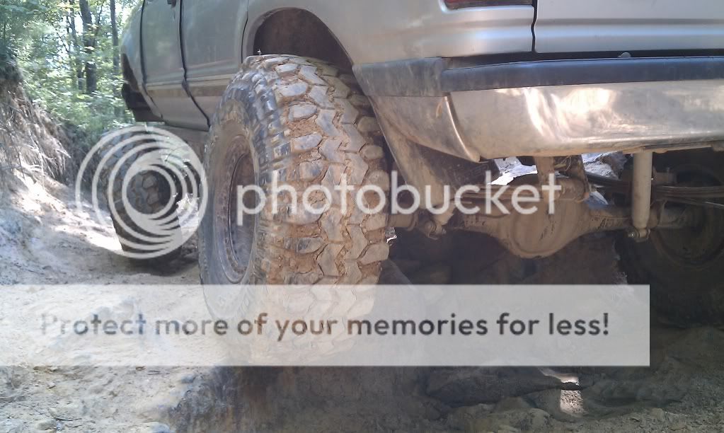

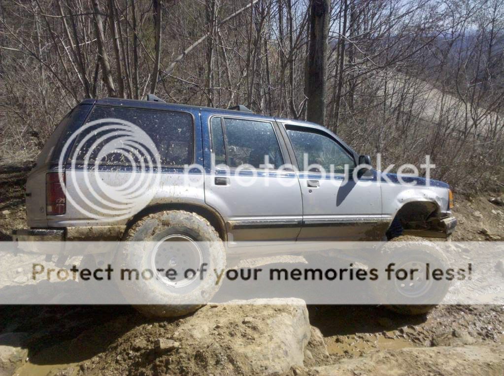

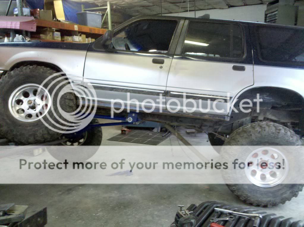

Finally traded around for some 36" TSL/SX on beadslocks that made cutting minimal.

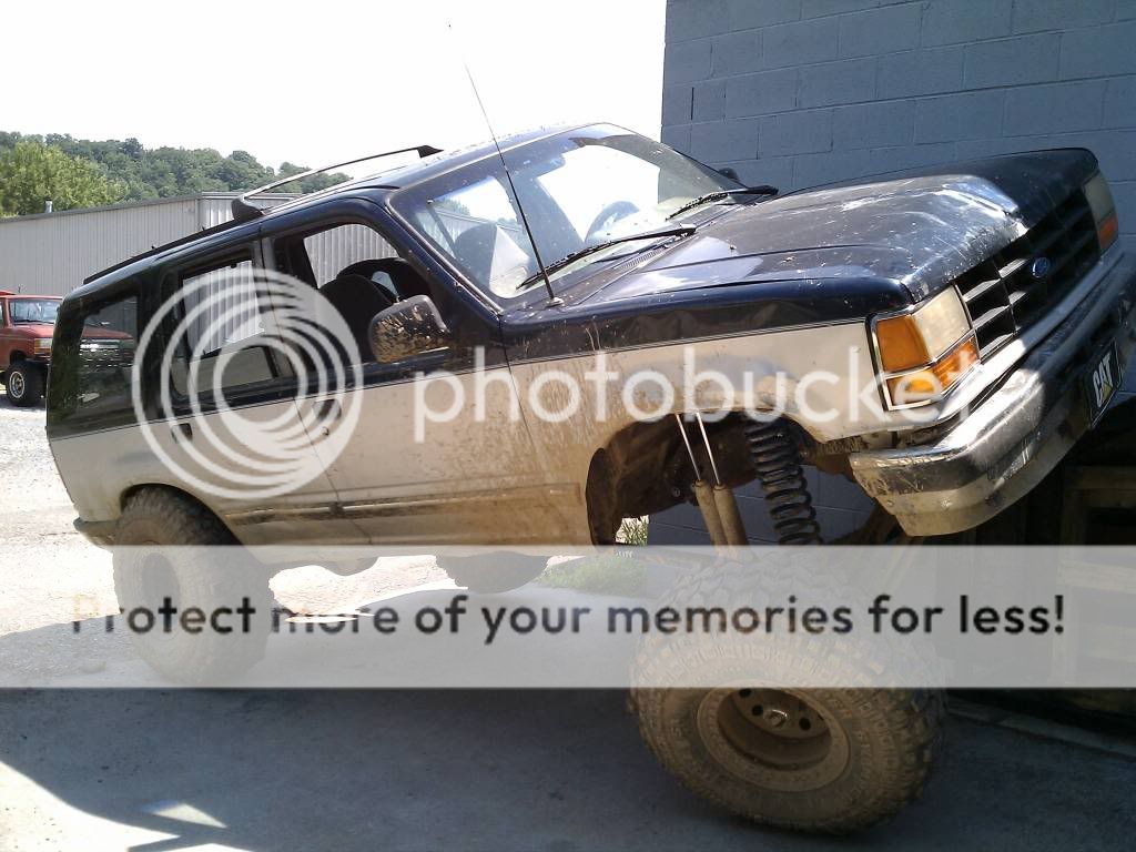

Could finally check the flex

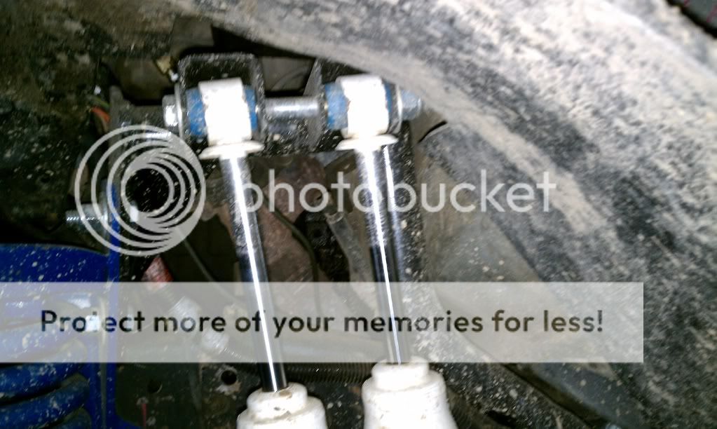

Lastly the brakes......I thought I'd never get them figured out. Ever since the 44/9 swap I had a spongy pedal. I chalked it up to the Explorer master cylinder not being big enough. I done a little research and found the F-150 master cylinder swap. Went and picked one up and hooked it up. Still had a spongy pedal. Finally found out the reason was because the lines were hooked up backwards (thanx cammeddrz)!

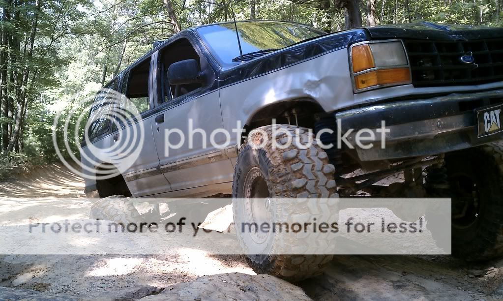

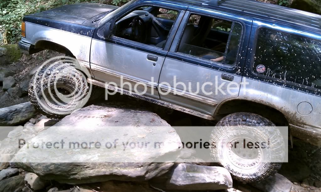

I've done a little wheeling.
And that's where I'm at right now.
