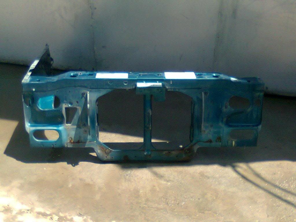

Removed the old frame, tried to fix it but just decided to replace it along with the right inner fender:
"New" Support/inner fender:

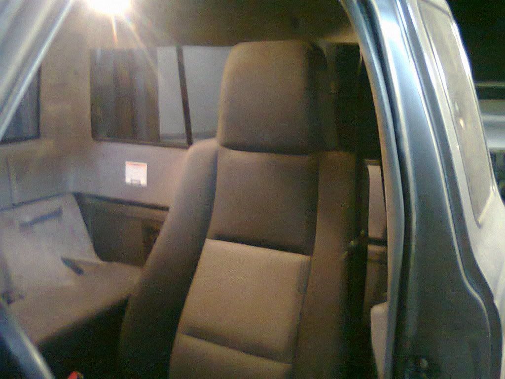

Removing all the windows, windshield:
Guess I need a new antenna cable.... Also, How many colors has this thing had??? I see Red, white and blue there!!

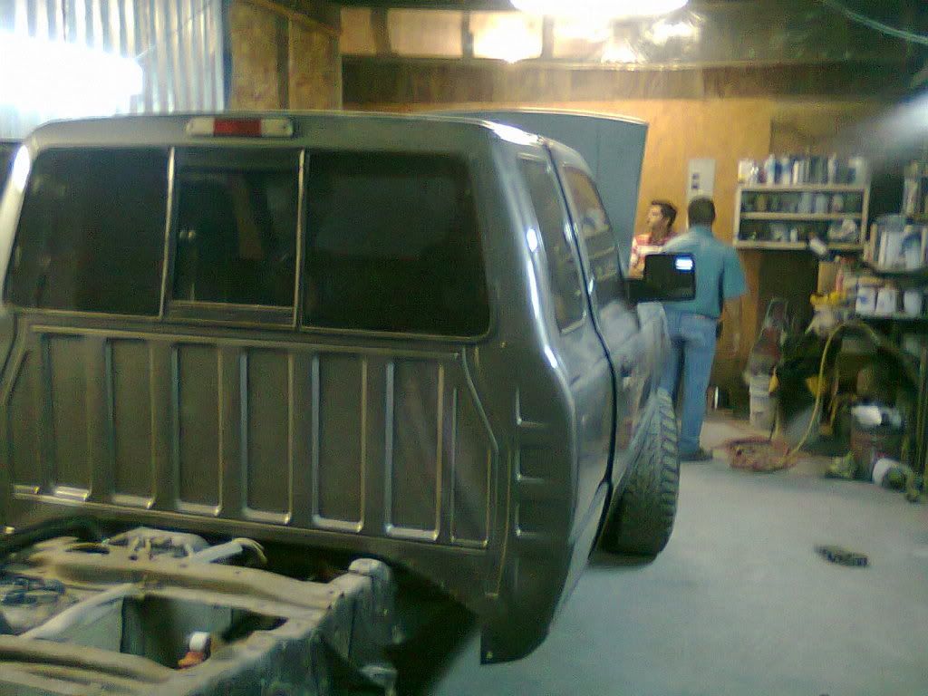

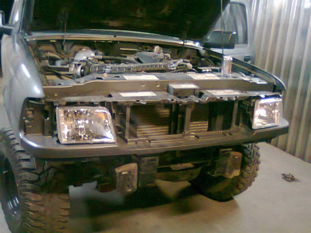

As far as it got last Saturday.. My friend welded the new frame in and mounted the outer fenders to see if everything matches he had to straighten out the front part of the chassis 1/4th of an inch up and 1.5 inches to the left. Both beams bent because of that front hitch I'm getting rid of, btw...
Also you can see my color pick... Ford Dark Metallic Gray... Sorry for the low-res, I only had my cell phone camera... Promise more pics and will upload some of the old ones I have.... The truck started to get dismantled in mid-July, so 8 weeks and counting, and I think 3 more to go at least.... Things I got that will be replaced:
